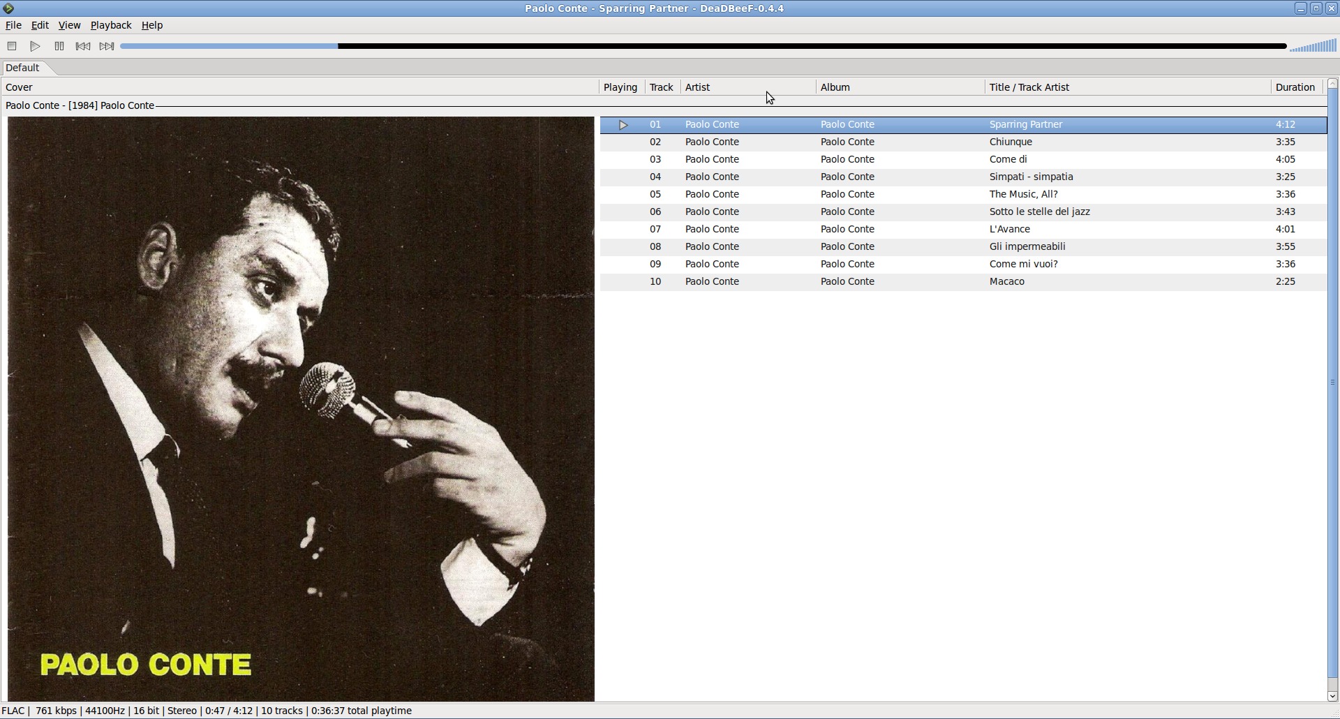

oh no, yet another player! 😀
probably because you forgot that Linux is case sensitive. In windoze "Folder.jpg" or "folder.jpg" are the same file... in Unix/Linux they are NOT!Despite what is claimed I couldn't get cover art tags working, nor it does show the album arts saved in each album directory ( I call it "Folder.jpg" for Win compatibility).
Likely you have to rename all of them as "folder.jpg" (all small letters).
I solved the problem... see my previous post 2465016. Anyway, yes yet another player, you should try this one, it is really fast and support cue playing.
Best
Pietro
