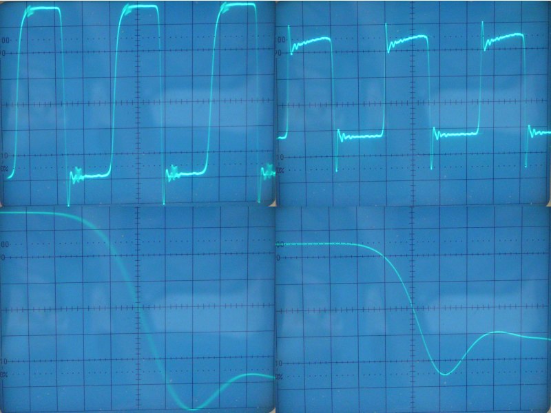

During the last weekend I introduced the ec-designs reclocker
to my DDDAC, hoping to find the holy grail.
OutOfTheBox I would rate it -- considering my very special environment -- "Something has to be heavily modded to get the full potential out of it".
The PCM2706 used just as a receiver is powered by noisy 5V PC-USB power. (I mean - I was pretty naively thinking the reclocker would be able manage all issues,
I attached a picture that illustrates DPLL reclocker jitter blocking. Left, the typical USB receiver timing signal, and timing jitter (approx 300+ ps). Right the reclocked signal, and timing jitter. Amplitude is lower as masterclock, reclocker and clock buffers run on 3.8V band-gap reference shunt regulators. The lower pictures show the clock signal transients in detail (max. timebase setting).
You are using the USBDI2S module that was optimized for 44.1 KHz with 48 KHz sample rate. Note that it will only reclock correctly with 44.1 KHz, as it acts like a DPLL. The locking range (delay) is exactly matched for 44.1 KHz sample rate. With 44.1 KHz, the DPLL will lock and produce a clean square wave signal, with 48 KHz sample rate, it locks-out and reverts to asynchronous reclocking.
You mentioned that you converted the digital audio files to 48 KHz, this means that when playing them back at 44.1 KHz, down sampling must be used. In either case, digital audio playback isn't bit-perfect when derived from a 44.1 KHz source.
I am using mac OSX with 44.1/16 recordings at 44.1/16 sample rate, I also use a galvanic insulated USB interface (USOS2).
After some hours of listening I can say, you hear more details and the sound gets this jitter-free fluidness and softness - this I expected. On the other hand you also hear a lot of power and/or power-noise related flaws
The connected DAC and other audio equipment also heavily affect sound quality. The DDDAC DAC hasn't got an output filter, so HF images can pass unattenuated (NOS). When timing jitter is significantly reduced, "power and/or power-noise related flaws" are just showing the limitations of a NOS DAC without filter (jitter masks HF images).
The USBDI2S module (with integrated reclocker) was primarily designed for DI DACs that perform interpolation through frequency multiplication (delay-add scheme) using multiple DAC chips, and perform "calculations" in the analogue domain, preventing trunctation errors. These DACs produce a 352.8/19 output signal, and effectively attenuate / spread HF images.
I use a DI8M reference DAC (8 * TDA1541A) that was compared to commercial SACD and 192/24 systems (Philips SACD1000 and North Star 192 / Lyngdorf TDAi2200 among others) to make sure its sound quality was high enough to serve as reference. The connected audio equipment was tuned for maximum transparency.
With all respect, TDA1543-based DACs can sound very good indeed. But do realize that TDA1543 distortion is 10 times higher than the TDA1541A (Philips dataheets). Provided errors aren't correlated, it theoretically takes 100 * TDA1543 in parallel (TDA1543 distortion divided by the square root of 100) to achieve similar low distortion as a single TDA1541A. This means that you would theoretically need 800 * TDA1543 in parallel to come anywhere close to DI8M performance.
Passive IV is known to introduce distortion when TDA1543 25mV output compliance is significantly violated.
What I am trying to say is, the "power and noise related flaws" are most likely caused by unattenuated images and I/V distortion that start to get audible as timing jitter is reduced.
I do agree with you that galvanic insulation is important. USB / SPDIF coax connection creates either a galvanic or capacitive coupling between both computer and DAC. This low impedance path allows for (HF) interference and DC currents to disrupt correct USB receiver tracking.
If the reclocker works correctly, and "noise issues" are solved, bit-perfect playback from any source (PC or transport) will sound exactly identical. Spectrum analysis of the output signal could be used to verify this, provided spectrum analyzer resolution is high enough.
An easy way to construct an optical, zero coupling capacitance, USB to I2S interface is to use an USB to SPDIF (TOSLINK) converter, and connect a SPDIF to I2S converter through TOSLINK. The data integrity won't be affected, and the cascaded PLLs (one in the USB receiver, the other one in the SPDIF receiver) will further reduce USB digital audio receiver jitter. This way a USB to I2S converter can be constructed that has full galvanic insulation and zero coupling capacitance.
