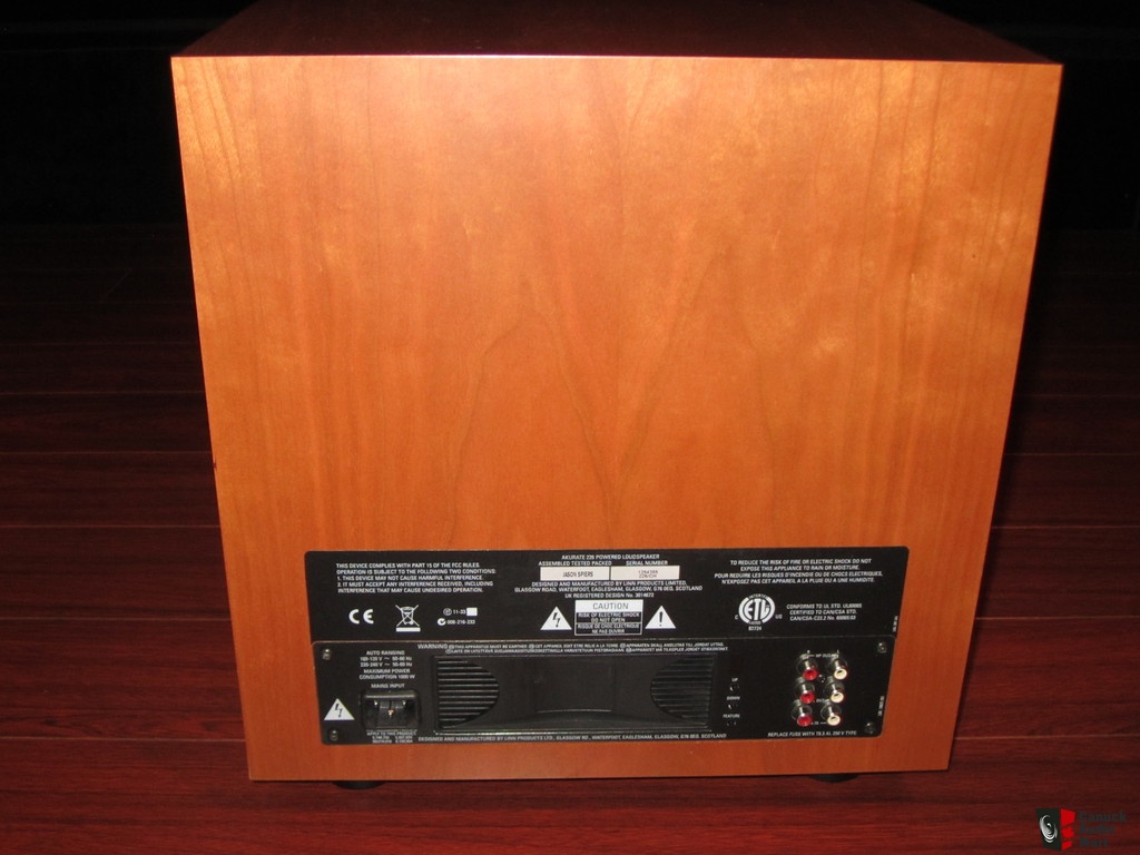

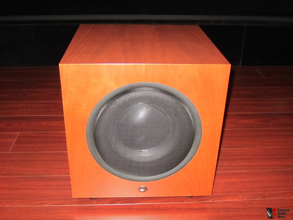

Linn Powered Subwoofer Model Akurate 226 - Schematic needed for LBL 196/3(A)
On main PCB I read this:
PCAS350/L2R 03-08-04 SERVO'D BASS BOARD PCB350L2
On sub board (part of SMPS-section) I read this:
PCAS350A/L2R DESIGN: DSW,AR,RS,ES
The following deficiencies I note at a visual inspection:
1) burned and damaged SMD resistor (maybe between 0R22 and 0R47) in series of the source from one of the four MOSFET's 20N6055 (primary area of SMPS)
2) 0R (i. e. shorting) between G-D-S of all this MOSFET's
3) overheating arround several electrolytics (e. g. C806, C809, C813, C105, C107)
Who can upload the schematic diagram of this module - particularly from the switch mode power supply section?
What are the main reason for the damaged MOSFET's ?
Thank you very much for helping.
