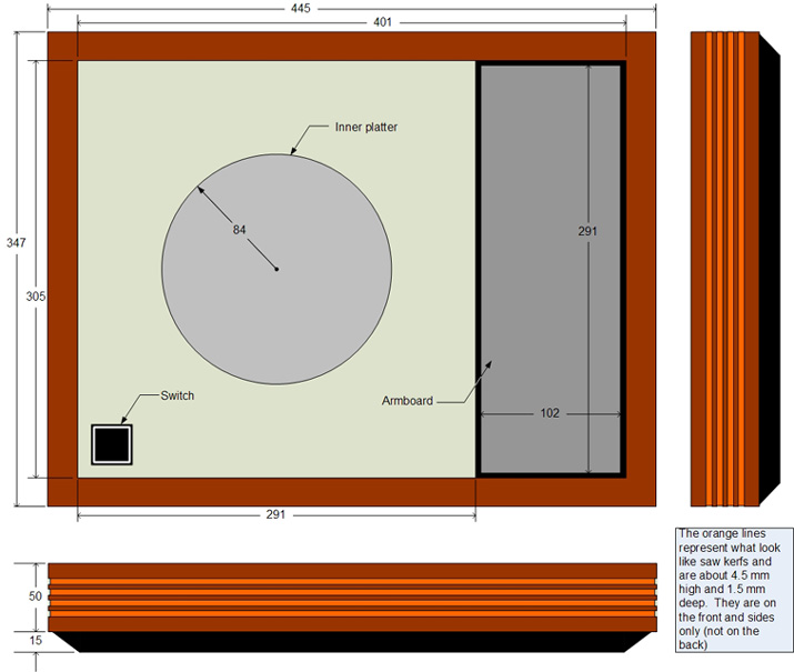

Do you still need these measurements? If so, let me know what you need and I'll try to get them this weekend; but I'm fairly busy at the moment, so if you can be specific about which measurements you want that would be good.
OK, here's a 95K version...
The feet are not shown.

willie000 said:
I would need a coplete drawing, with the sub chassis supports ...all the internal dimensions really
Hi
This would unfortunately call for a bit more dismantling than I can undertake just now. Sorry I can't be more helpful.
Perhaps someone else has the information readily available?
