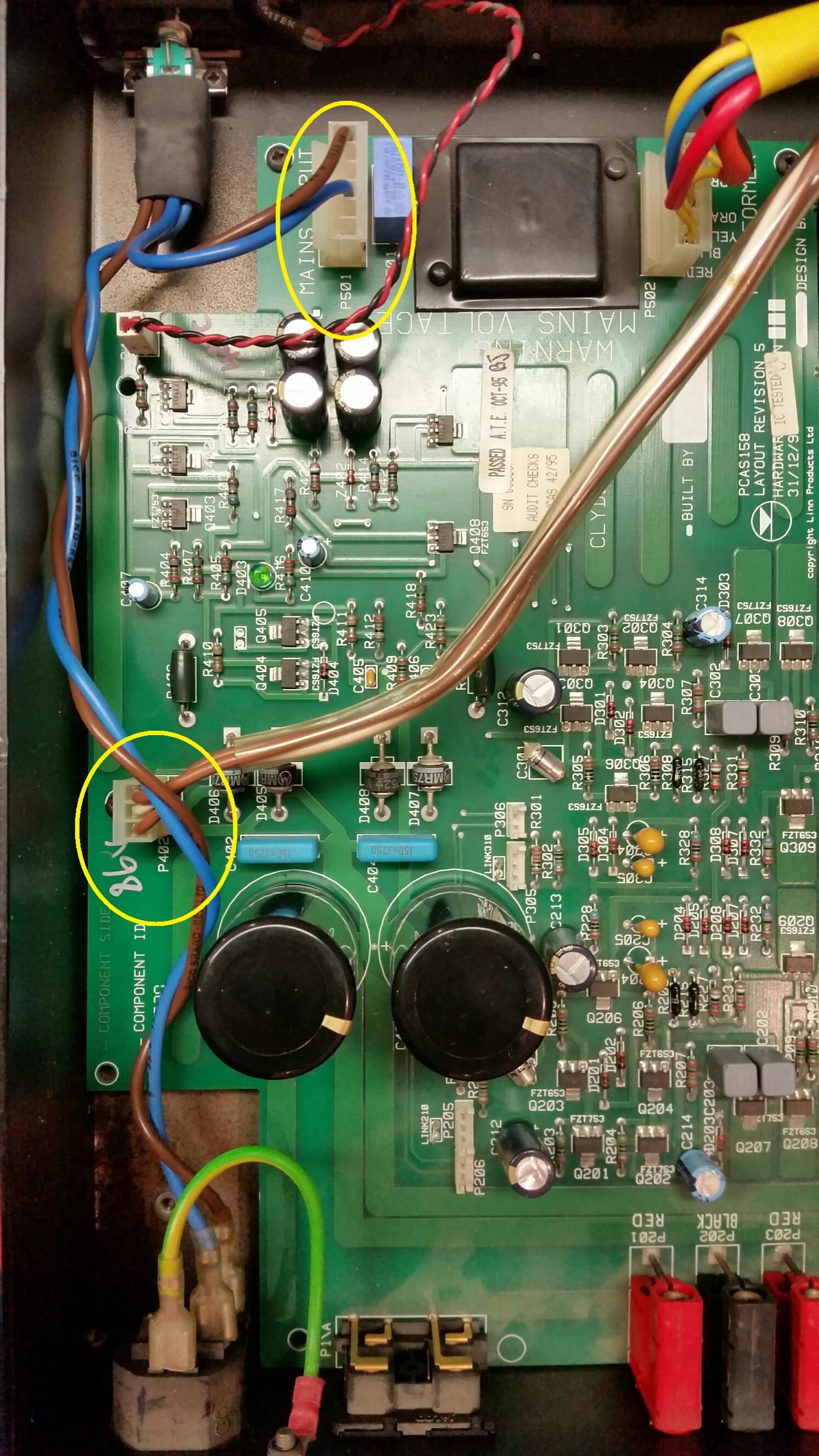

I measured the VAC read out on P402 (1st_brown-to-white and 2nd_brown-to-white):
With main (ON/OFF) switch on [but amp is in failure mode, i.e. not playing]--> 33-0-33
With main (ON/OFF switch off - 0-0-0.
So I guess the VAC reaches that point OK, even though the amp fails to amplify.

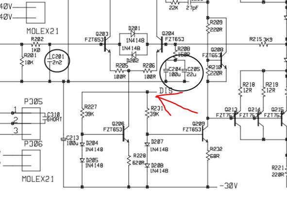

I'm just looking closely at the circuit to see what is or could be common to both channels and I spotted this......

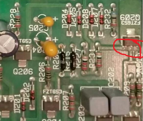

The line marked DIS will be a bias voltage of some kind, possibly a delayed voltage to minimise switch on thumps and so on. I'm wondering if this voltage is disappearing for some reason. It seems to be shared between the channels, and if it goes missing I suspect it would cause your symptoms. The expected value could be anywhere from around minus 20 all the way to plus 40. Anything in that region will work as a bias voltage. If it falls to nearer minus 30 then the those two transistors Q206 and Q209 will be cut off and the amp will go quiet. That's the theory anyway 😉
Firstly, make sure the 3 pins are soldered properly. Look at them with a bright light and magnifying glass. There should be no trace of the solder cracking. In any event, having done that and if you are confident then I would resolder those points.
Also, if you can get the amp to misbehave then it would be worth comparing the voltages on the print going to those pins in both faulty and non faulty states before resoldering or even touching those pins. And be careful. Don't short anything.

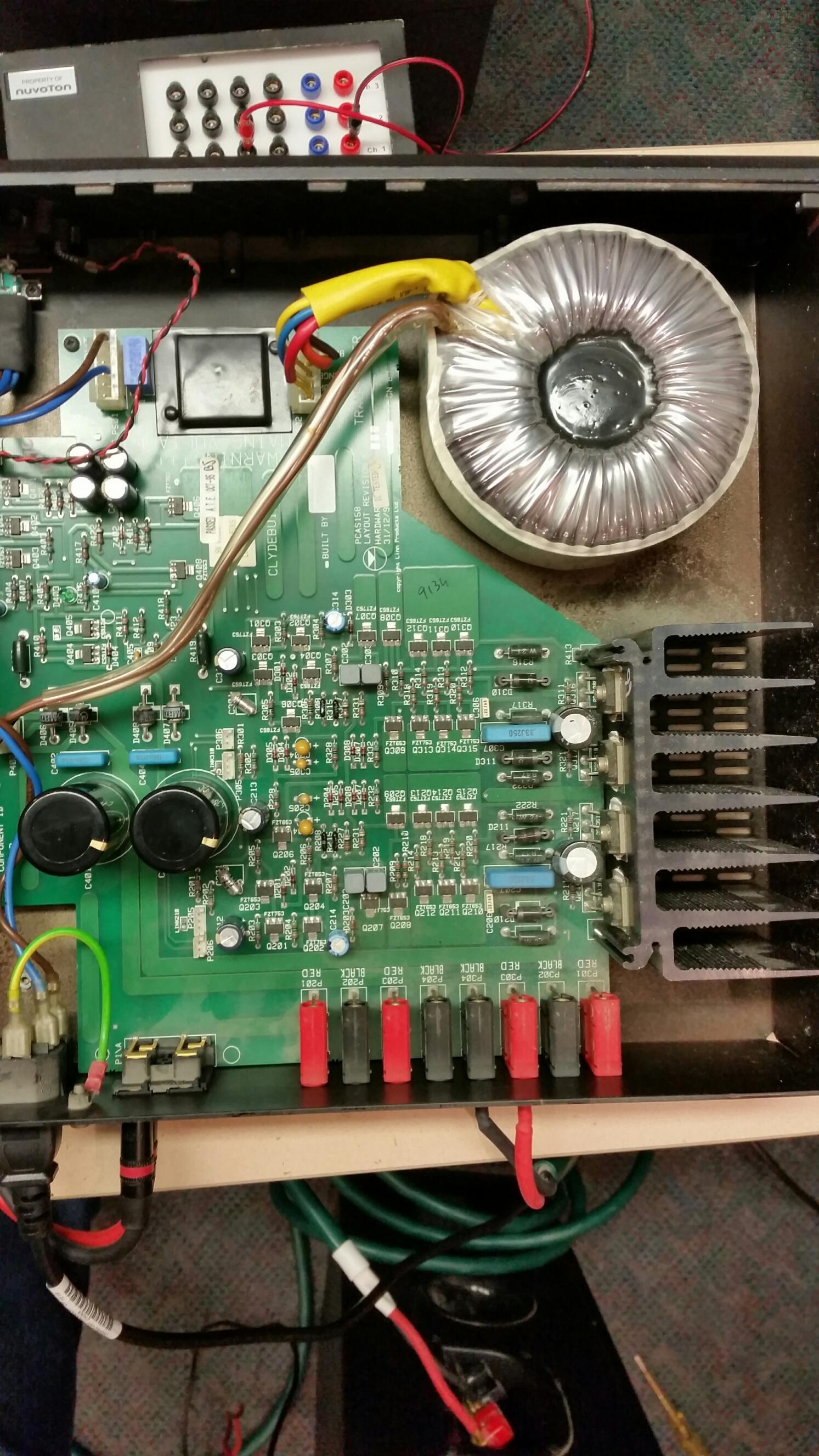

I recently bought a LK100 for a good price with no listening possible. Once at home I opened the box and discovered filter cards inside.
The cards were welded directly to different electronic components then I suppose the batch number is the oldest version of LK100 production.
I removed all the cards, replace one small resistor and took the opportunity to change all the caps at the same time.
All was done properly with good audio caps.
But now I got a "buzzzz" in my speakers with a level too high to be acceptable.
