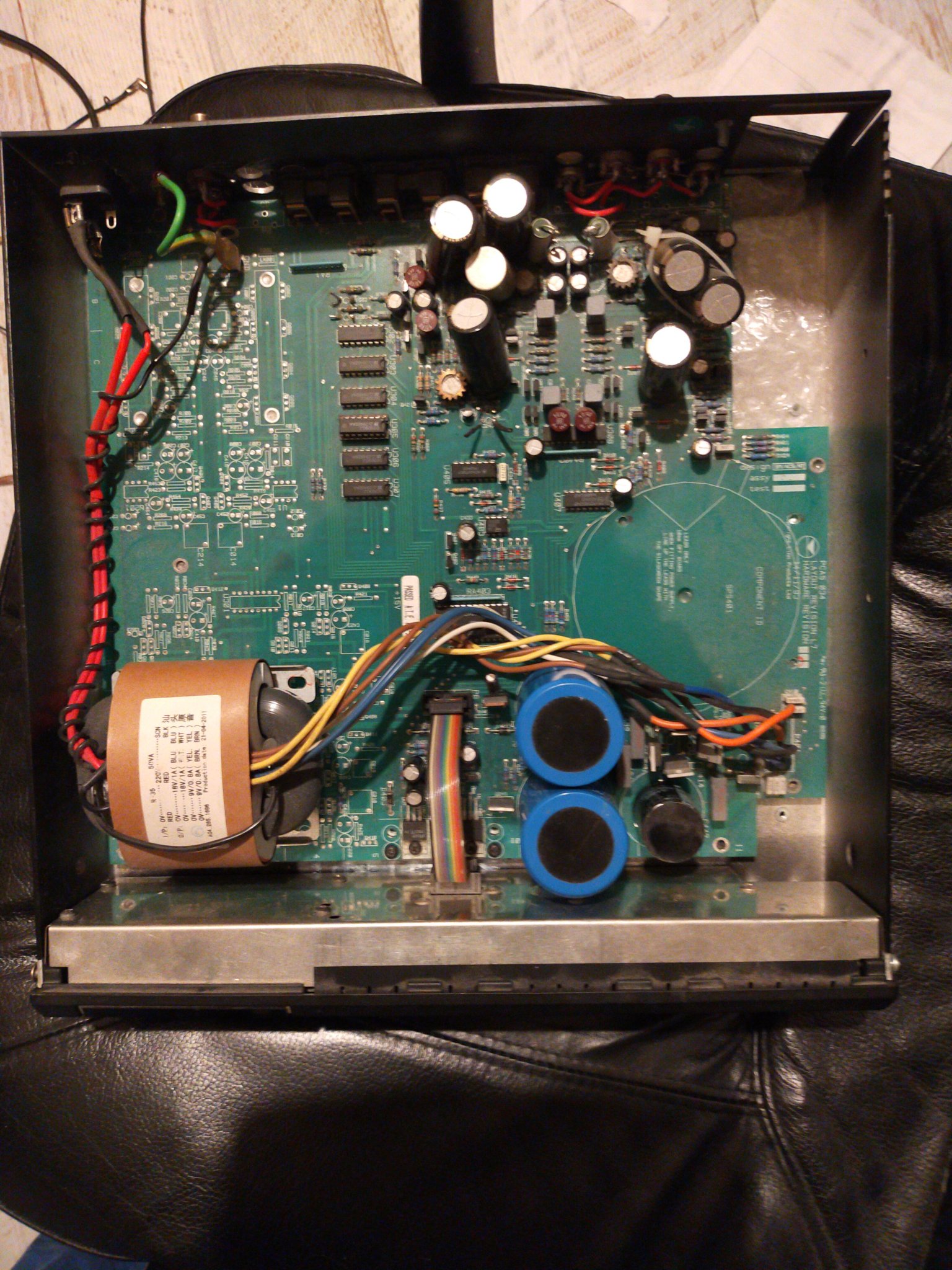

Kairn Brilliant SPS fixed
Thanx to pinkfishmedia it was easy to replace the faulty capacitors inside the "ashbox"
The presumably "dead" Kairn bought at 50€ is now resurrected!
i'm happy like droopy!

Are there in the meantime the schematic anywhere available ??It seems to be very hard to find a schematic of this SMPS
For troubleshooting on a "LINTO"-device from Linn I need currently the schematic of the SMPS. I note, that no voltage on the supply output will be provided.
The actually MC-RIAA amp works perfect (checked with an outdoor power supply).
Are there anywhere the associated schematic in the meantime for these switch mode power supply ?

Obviously there is nobody, who had create a schematic diagram. Maybe one of the members has also a faulty power supply of the same modelFor troubleshooting on a "LINTO"-device from Linn I need currently the schematic of the SMPS. I note, that no voltage on the supply output will be provided.

If I have at least a second PCB device of the same model, I start the troubleshooting.

Here the PDF schematic of the preamp itself (please note: first generation Linto, not currently version !!! ) I have created this schematic for the introduce of an interface (to connect an external parallel regulated power supply) some years ago.

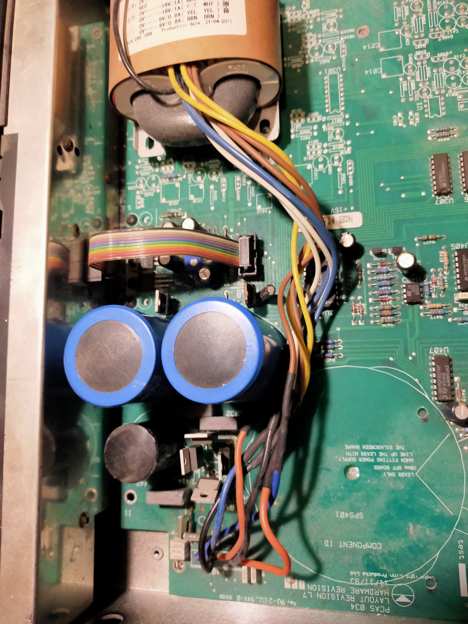

Hi. Has anyone tried replacing the smps with a more simple, linear power supply?
I'm curious if there was a particular reason for using switch mode back then, whether the schematic asks for one.
Does anyone know output voltage of the original supply rails?
Thanks for your reply. I went through the whole thread and it seems I've overseen that tiefbassuebertr actually included most of the power supply diagram in the preamp schematics.
I expected a much more basic supply for a phono preamp. Have you been satisfied with the sound after the mod?
