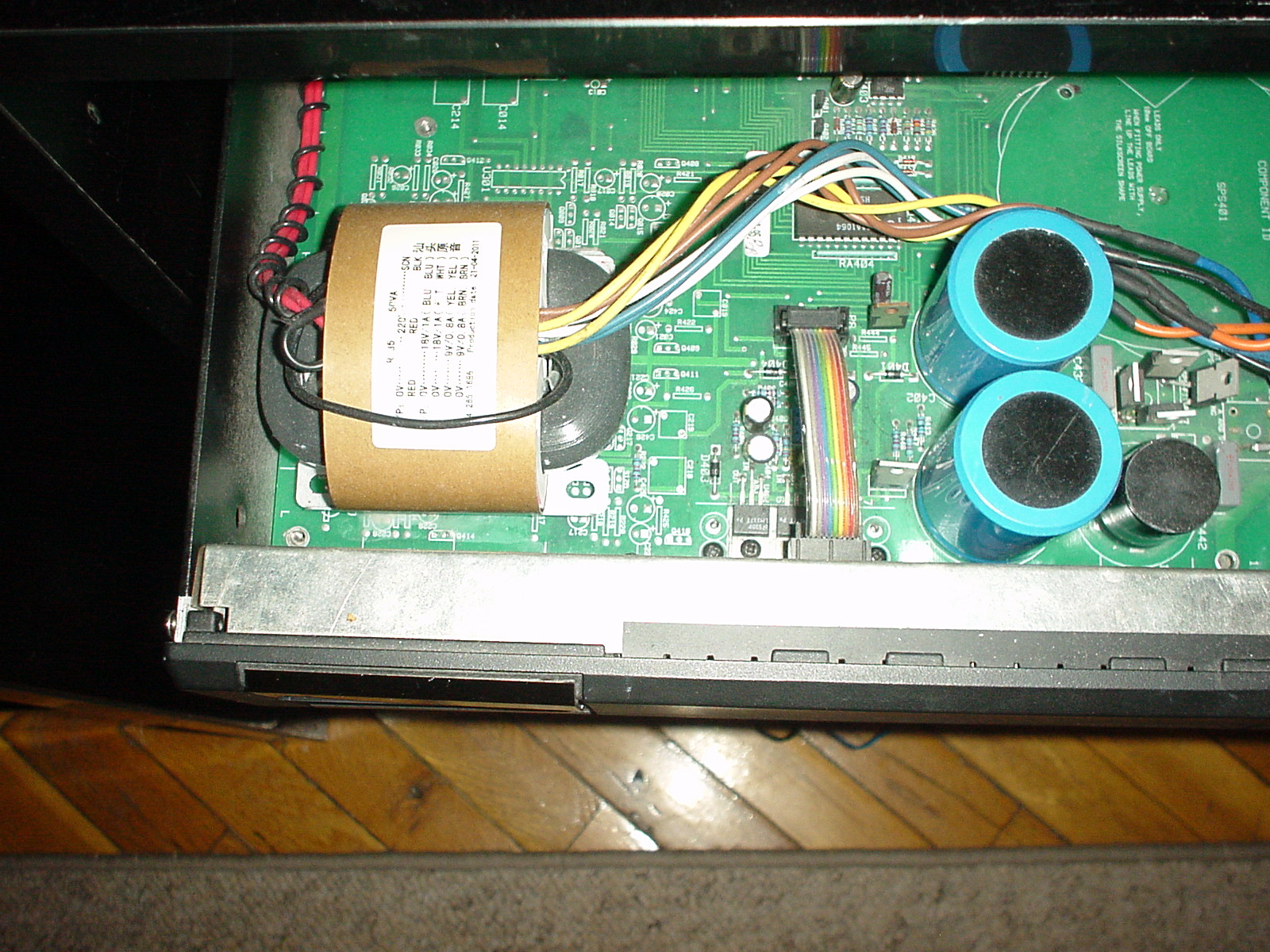

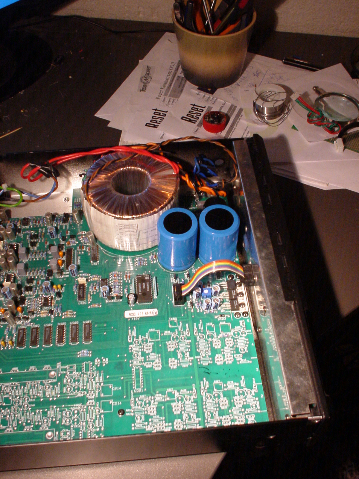

Thanks to everybody who tried to help. At the end of the day we have replaced the SPS with a normal toroidal transformer and now it is OK.

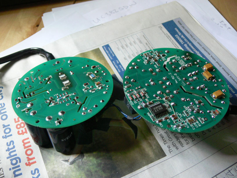

Great work. Unfortunately the showed device is the PCB of the line/phono preamplifier model "KAIRN" and not that one from LINTO. The still needed Schematic is that one of the SMPS device from LINTO.Looks like that at the moment. I will have to change a bit the housing - no problem. Replaced 14 electrolytic caps with 22 uf tantalum and opamps.

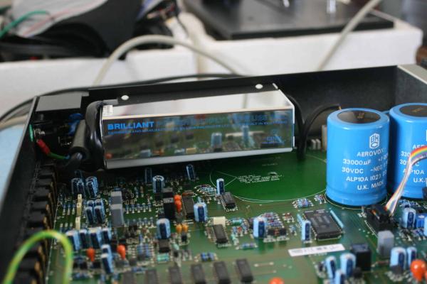

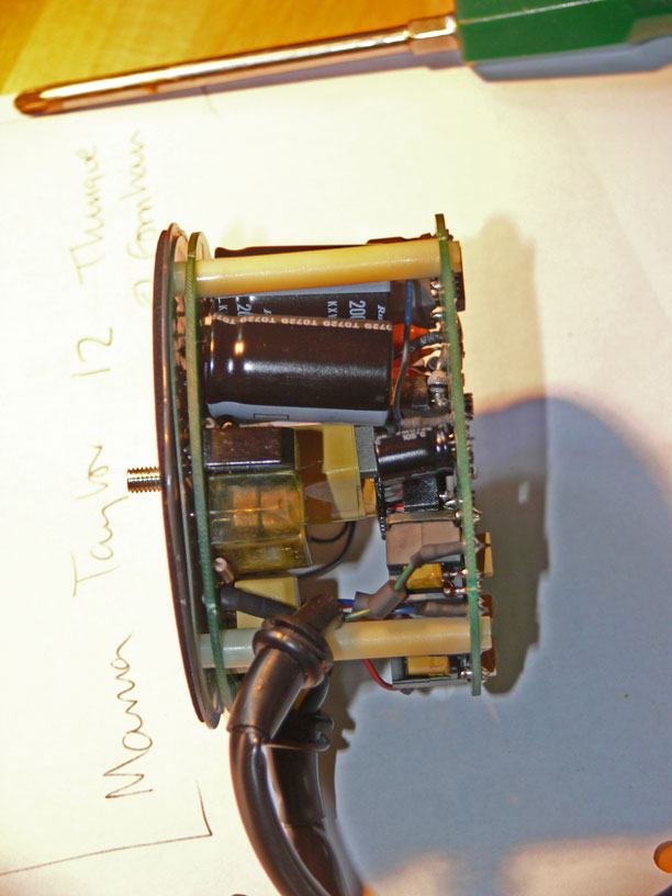

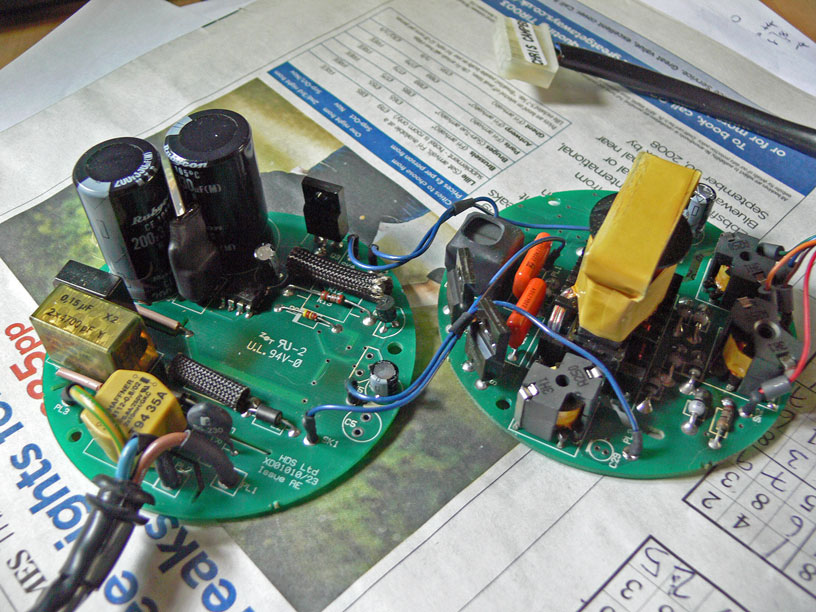

Here some additional pictures of the first picture from there, found about Linn Brilliant SMPS - naked! - pink fish mediaThe first picture shows the embedded SMPS, from which is the created schematic.
The second picture shows an other (older?) "Brilliant"- version from Linn. This schematic I don't have !!
(except the last pic - from this version I need also a schematic diagram).

Hi, you can try using an R-core transformer instead - I have changed the toroid in the KAIRN for this one.schematic for "LINTO" SMPS still needed
Regards
yes, like used in the first editions of that models.Hi, you can try using an R-core transformer instead - I have changed the toroid in the KAIRN for this one.

Definitively it is a right step ahead IMHO. Will post here the whole story of my mod I am very cslose to finalize-long story At the moment it is singing like a bird.🙂Is it possible by replacing the switchmode power supple with a transformer?

No. You need additional a rectifier bridge or four pieces of high speed diodes, capacitors and voltage regulator, both for positive and negative voltage rail. Instead a serial regulator I would prefer a parallel regulator. And instead one supply for both channels I would prefer two monaural power supplies to optimize the GND management.Is it possible by replacing the switchmode power supple with a transformer?

Fully agree but I have just replaced the diodes with hyper fast ones paralleled with 0.1 uF and simply delivered the required voltage by an R-core trafo - works fine so far.
Thanks for all the info posted here. Our unit was tripping power light then dead. fault caused in our case by C19 on the AVS PWB.

Sorry I am late, it was long time ago and I do not remember exactly the voltages but you can see the photos and judge what to do - definitely new hyper fast soft recovering diodes /Fairchild/ and an R-core trafo.
