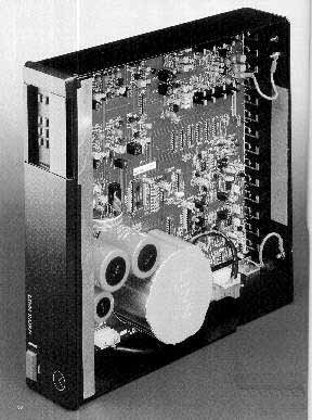

In the attachement the schematic of "Brilliant" SMPS from HDS-Power. I have created it some years ago to carry out the repair service by 12 pieces failured devices. Except the transformer and the very special enclosure (see the embedded version inside of "Kairn" from the attachements) no custom made devices there are in use.
The first picture shows the embedded SMPS, from which is the created schematic.
The second picture shows an other (older?) "Brilliant"- version from Linn. This schematic I don't have !!
By the way - an interesting solution for the voltage select 115VAC/230VAC from SGS-Thomson (ST) also inside; more information (circuit description) easy to find about the appropriate application notes (see datasheets from "ST and "TI").

Following my post #11. Is it the round SMPS that you are after, I have found some photos of the insides of this SMPS.
