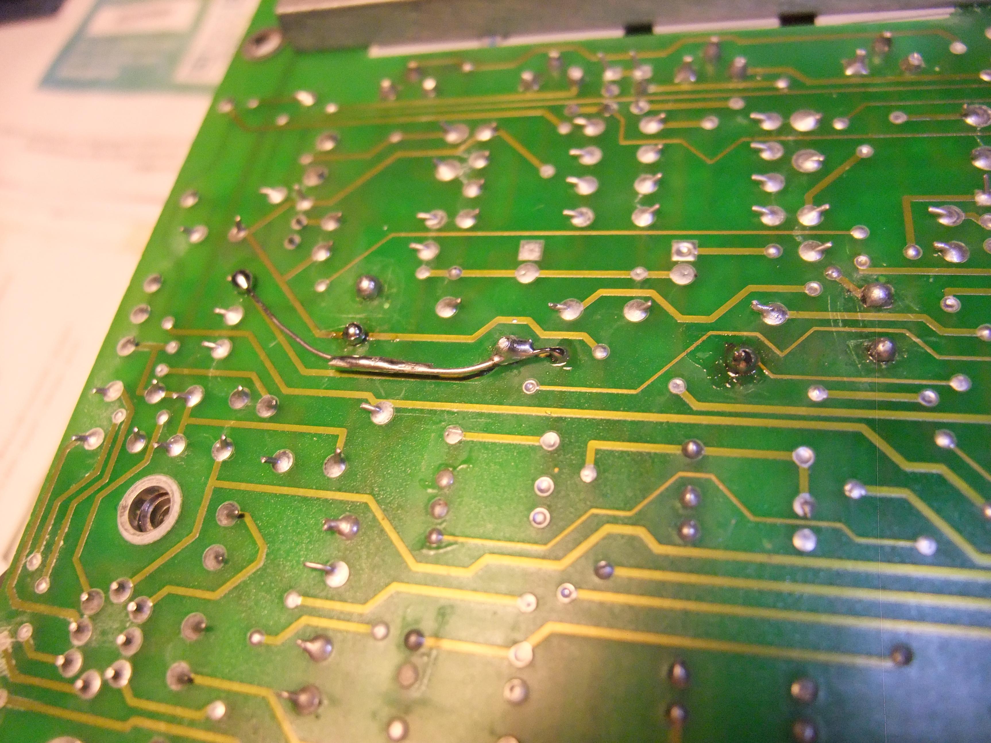

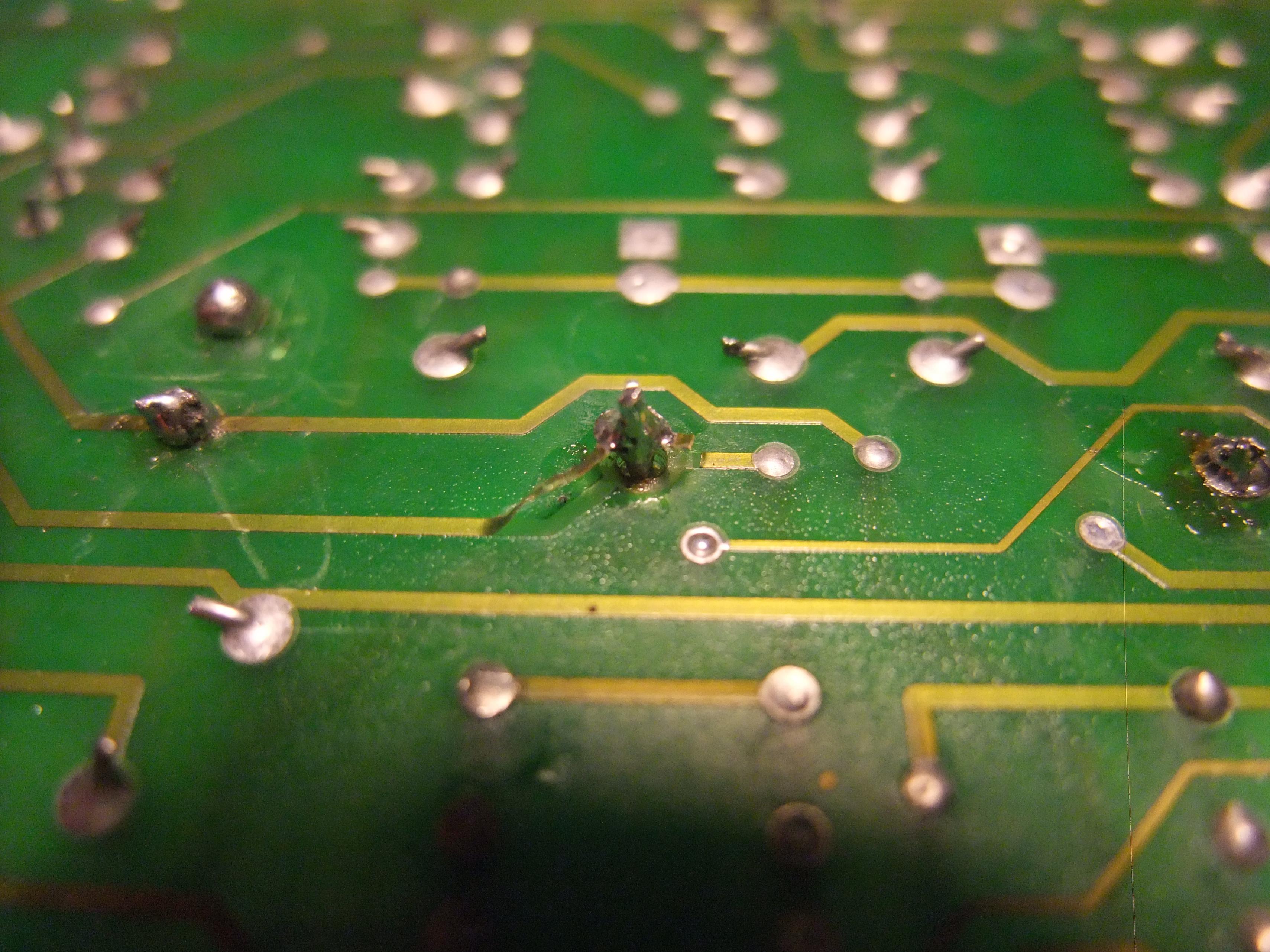

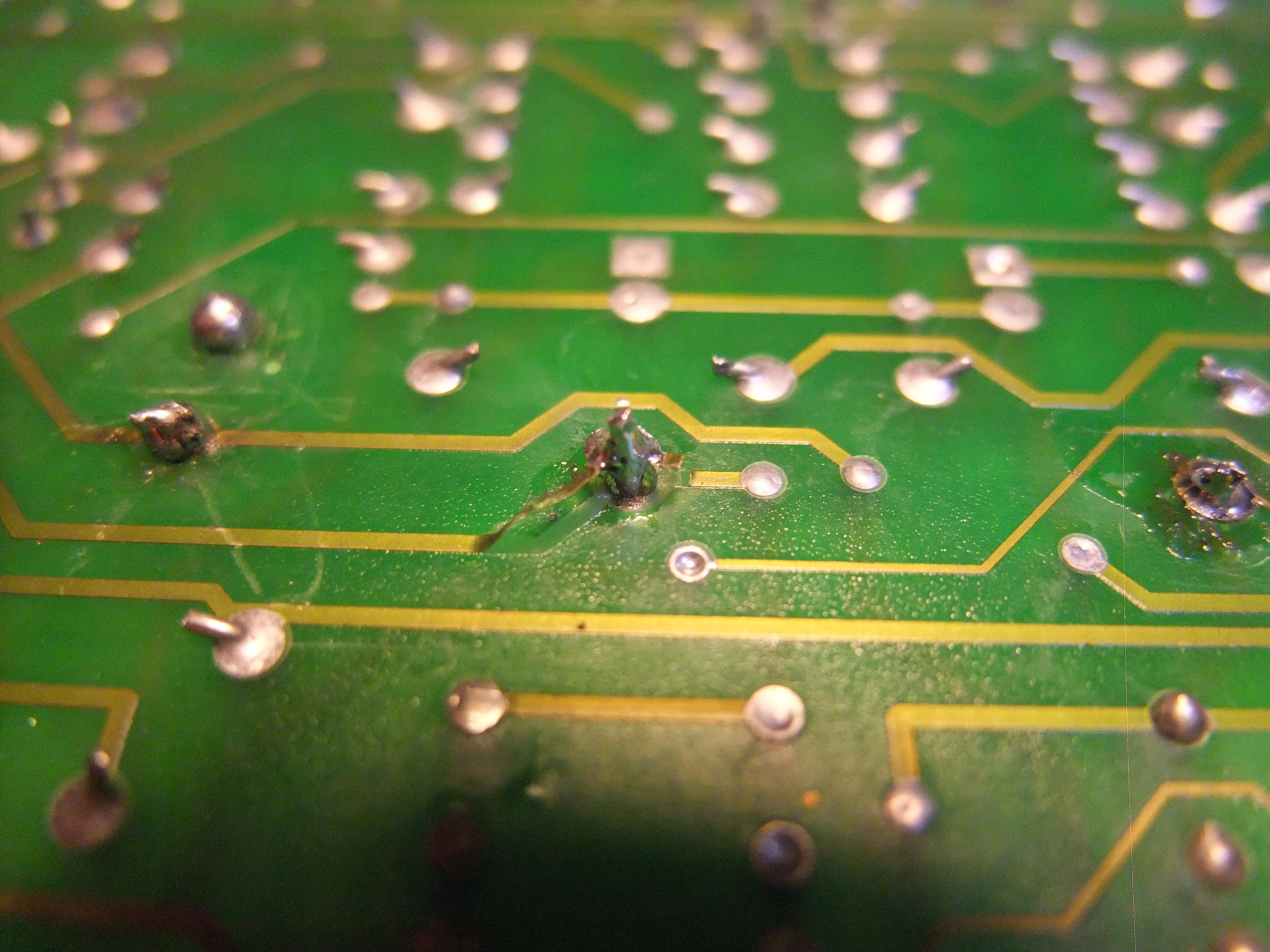

The easiest way to remove U4 is to snip the leads on the component side, as close to the board as feasible, then remove each lead separately.
The replace of U4 by a new device with socket did not fix the error.I found my self-made schematic of the version from previous posting by accident (go to attached images - it was in a place where I would normally never have put it).

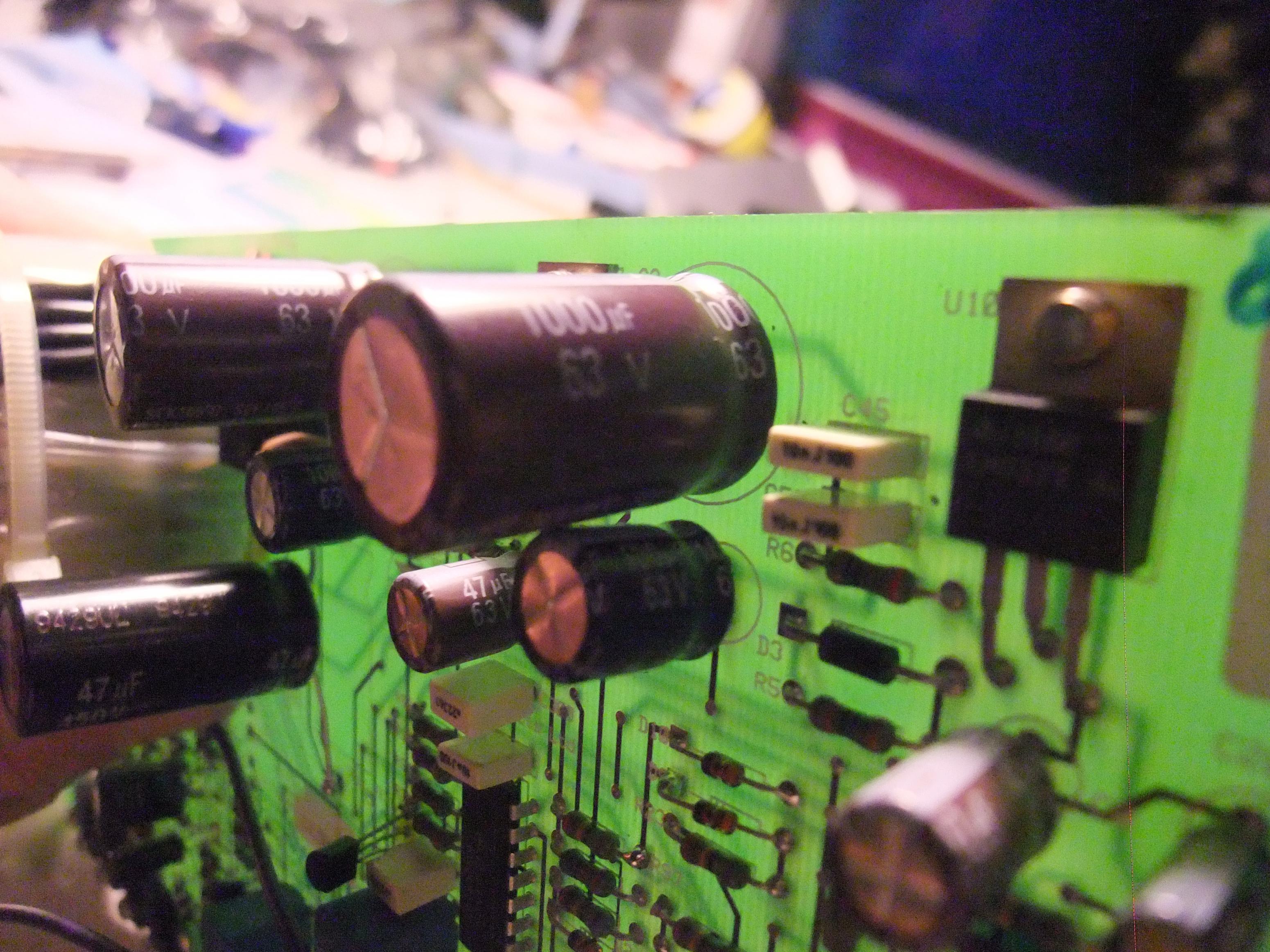

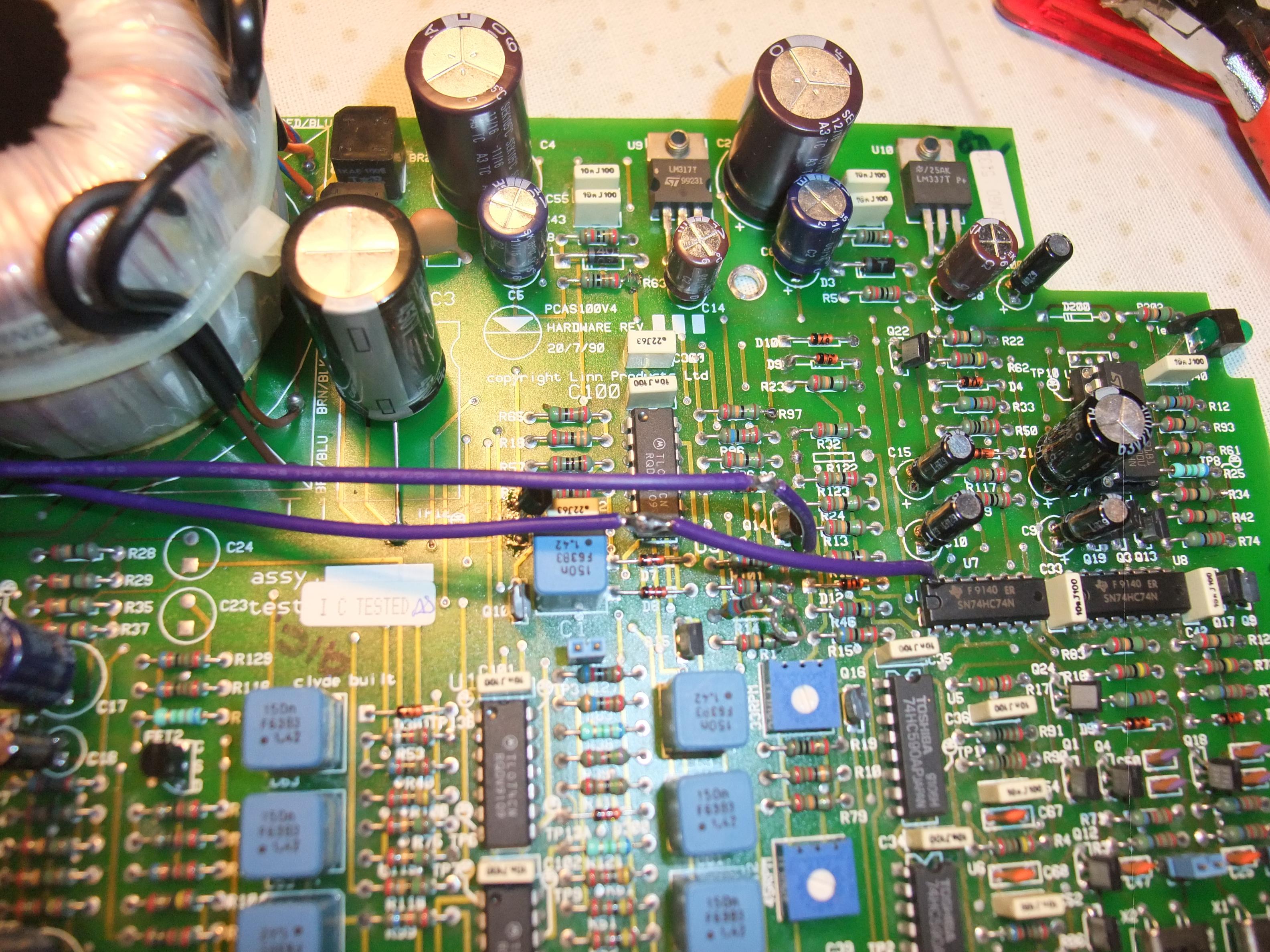

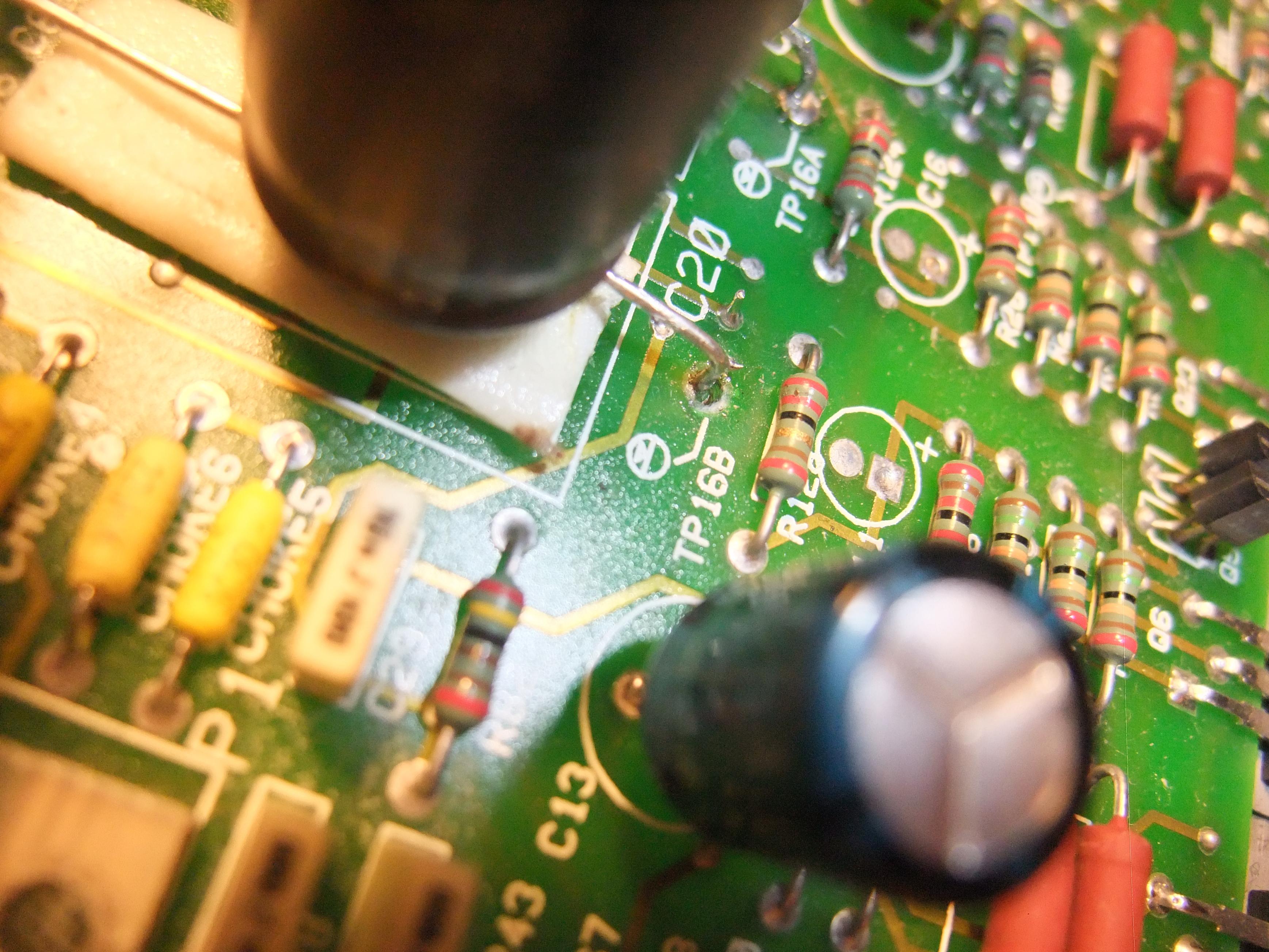

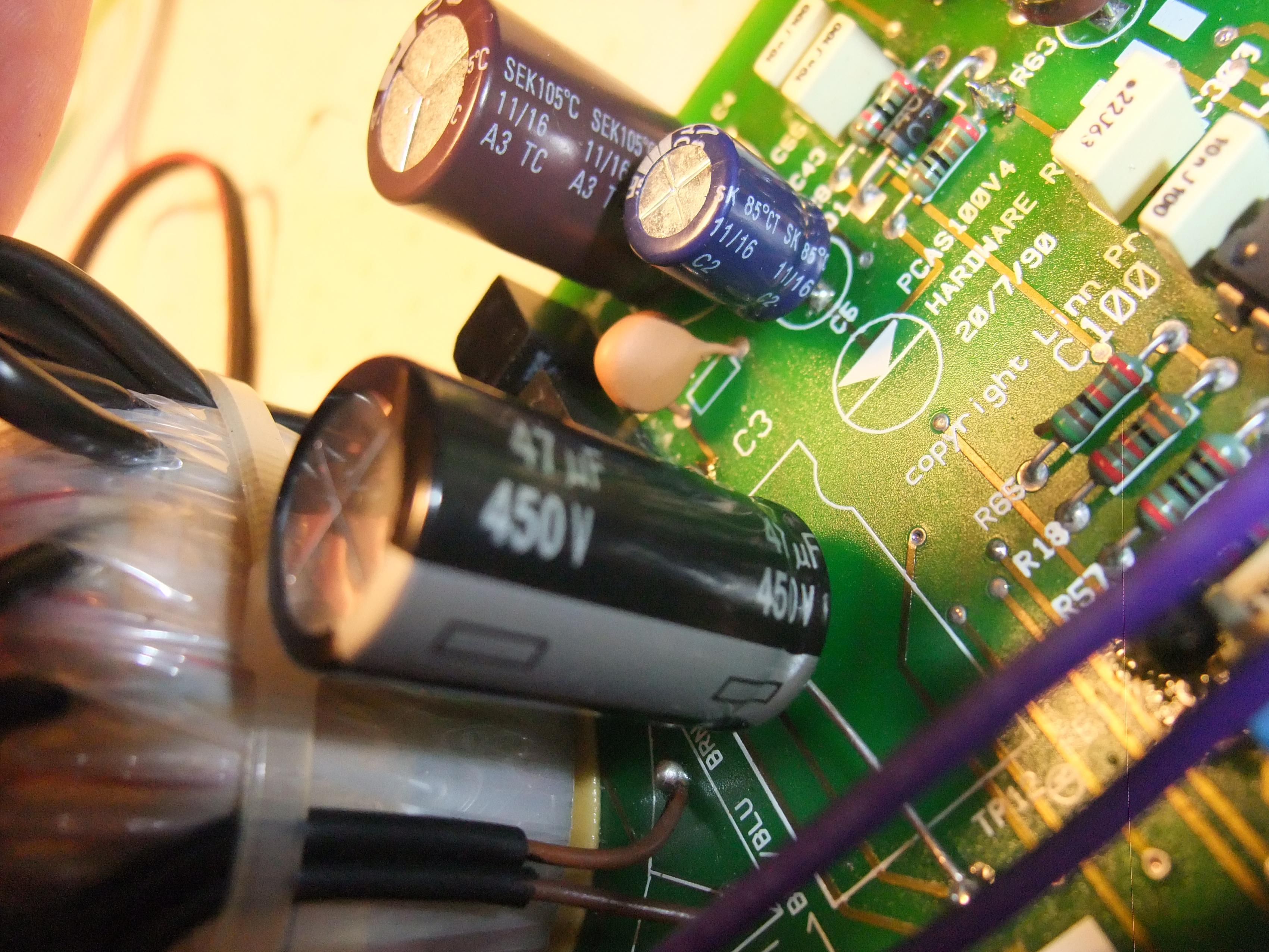

At weekend I receive such a version for repair with follow unwanted effect:
The increased gain for the start-up phase of the plate returns again and again in the interval of 5 to 7 seconds.
If there is a correct operating, Q10 - controlled by PIN5 (Q) of U4a - switches the resistor R14 (6K2) to the resistor R64 (150K), but only for any few seconds (start-up phase) until the target speed is reached.
Then the transistor Q10 turn off the resistor R14 and the gain factor is reduced and is only defined by R64 and an additional not showed NFB-Resistor (to maintain the speed).
The question is now, why the gain does not remain at the value for normal operating and goes back to the enhanced value for the start-up phase.
At PIN 14 of U2 (TL074) and collector Q14 so as at R123 (22R) and PIN2, U4 (74LS221 or 74HC221) is a square wave present (2V4ss) and a DC voltage of 2V2.
Maybe U4 must be replace (this is very difficult, because the PINs are bent over on the solder side).
The actually question is this:
How can I prove without desolder whether U4 is faulty or not?
Thank you for advices (go therefore to the first four attached images).

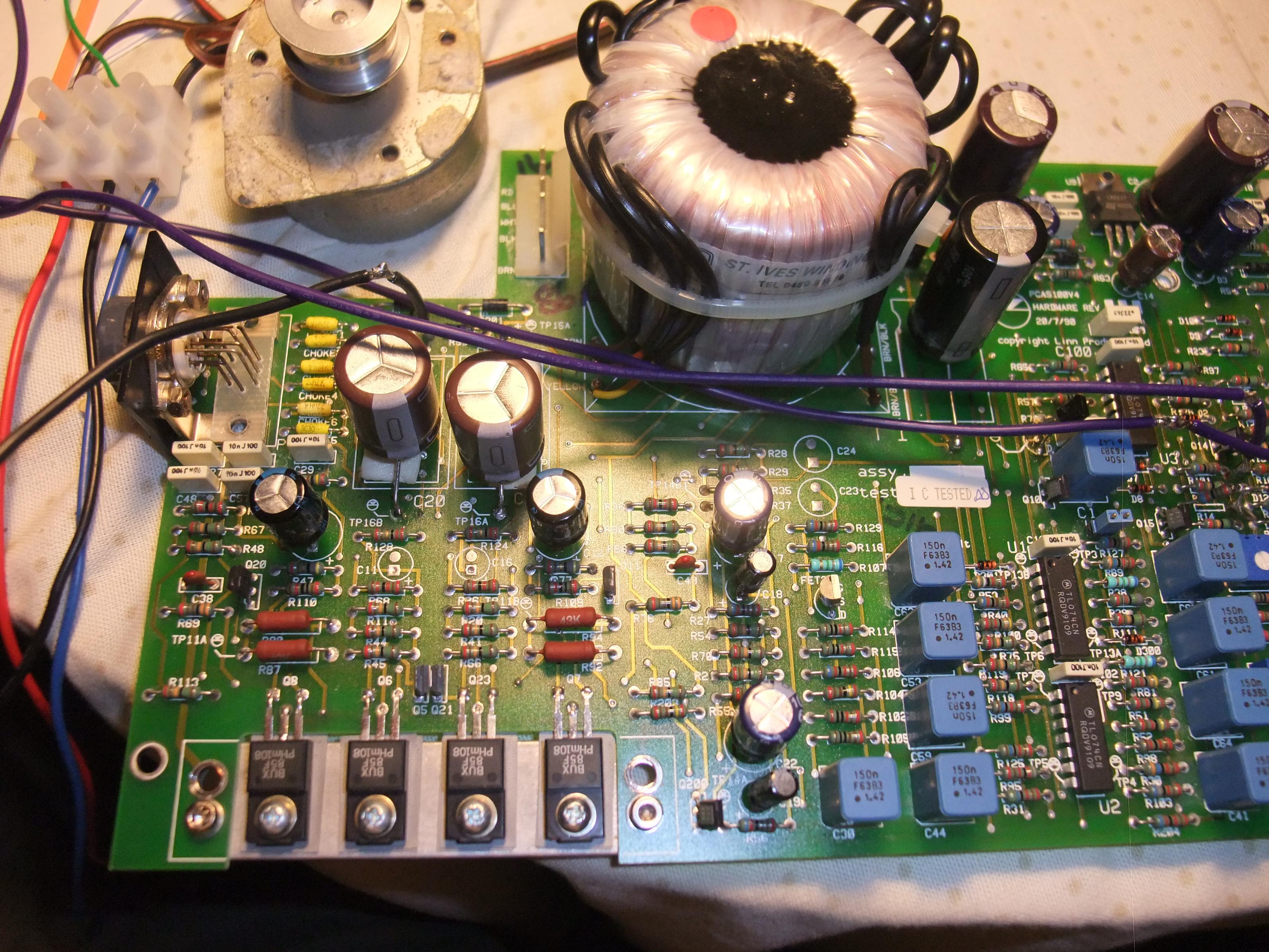

During the further search for the cause of the error, I noticed the following drawing error when I was creating the circuit diagram at those days:
On U4B, pins 12, 11, 10 and 9 must be exchanged for pins 4, 3, 2 and 1.
With U4a, pins 4, 3, 2 and 1 must be exchanged for pins 12, 11, 10 and 9, i.e. exactly the opposite of U4B. This means that the schematic must be redrawn for correct understanding the theory of operation.
During further troubleshooting it turned out, that the voltage for correct operation must be 5V on C, Q22 and R22 and PIN9, U4. Because there is to measure only 2V2, the above desribed unwanted effect is present.
The question is now, how works the section arround Q3/13,R59, FET1, U3 and D7-10 (first image, post #40) and which voltage values are correct while start-up and normal operating phase.
Thank you for advices.

On further troubleshooting attempts I note, that after the removal of the transistor FET1 (J112/U1898) the device operates at first glance in the correct manner (i. e. the gain remains now in the low-gain mode after the start mode with high-gain).The replace of U4 by a new device with socket did not fix the error.
I removed FET1 (J112) because it had a D-S connection despite the fact, that the gate voltage was -9V
The question now is as follow:
What are the tasks of the following parts:
U4 (PIN1-2-3-4-13-14-15), Q13, Q3 and FET1.

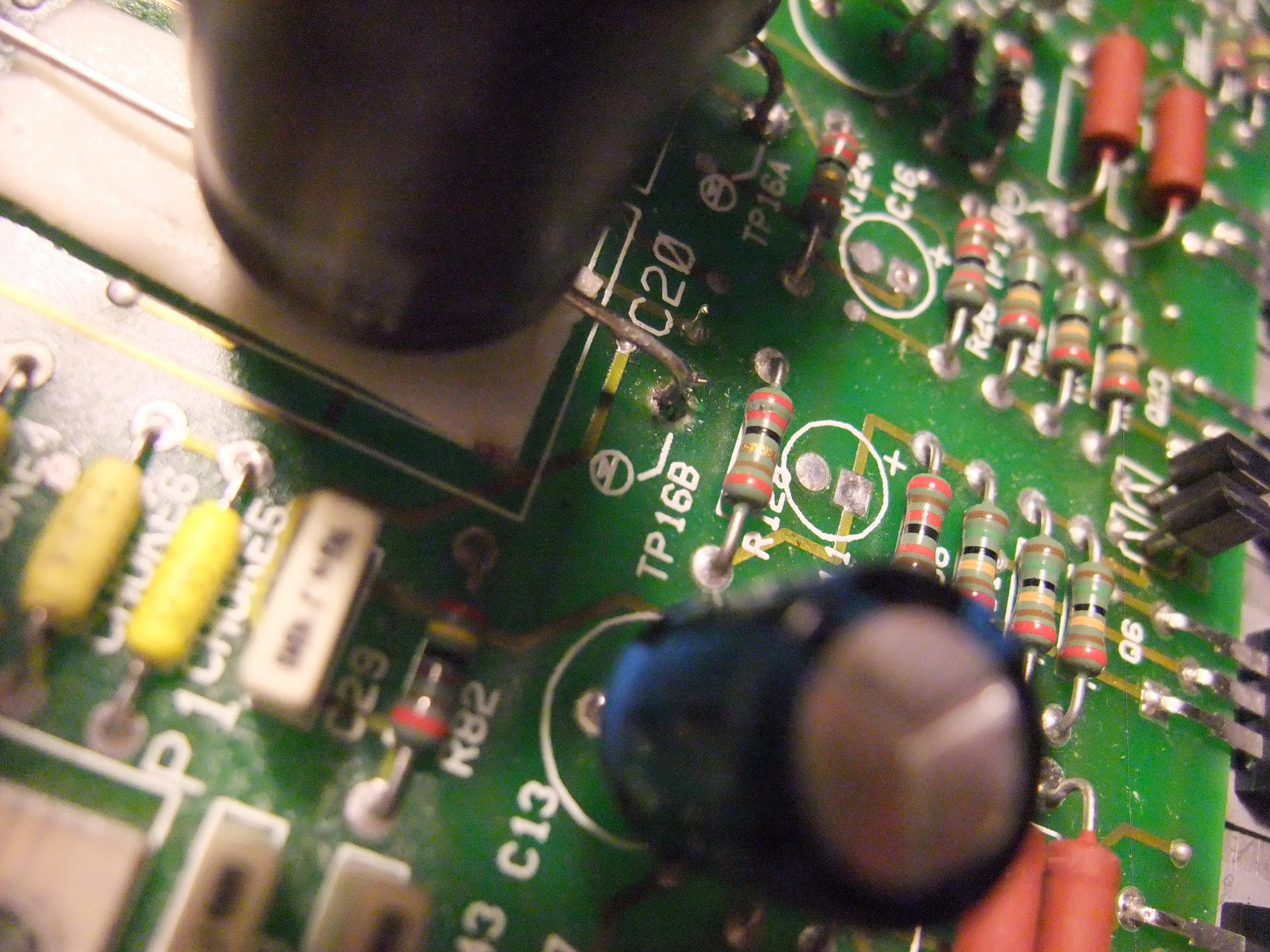

after replace the jFET by a new device from ON-semi the Lingo operates in the right manner, i. e. after brake by hand the motor pulley the motor voltage raises on the initial value (90VAC) for some seconds, to then return to the value for normal operating (50VDC). This wasn't the case without the jFET.
But the original issue occurs after a short time again and again the new jFET was defective (permanent conduction between drain and source, even at gate voltage from -9VDC). The reason therefore you will find in the attached images number one until five (the last four pictures shows the new electrolytic caps - all 63V and 450V versions).
Before the electrolytic capacitors C20/21 were replaced, however, the interruption in the conductor track (between Choke 2 and C20 near by TP16B) that was visible on the first two images, was only a invisible hairline crack, which resulted in temporarily voltage peaks at the source of FET1 and R59 (4R7).
After the interruption of the conductor track has been eliminated and the FET1 replaced again, this motor control device from Linn is now working properly even after a long test phase.
Unfortunately such causes are always very hard to find.
