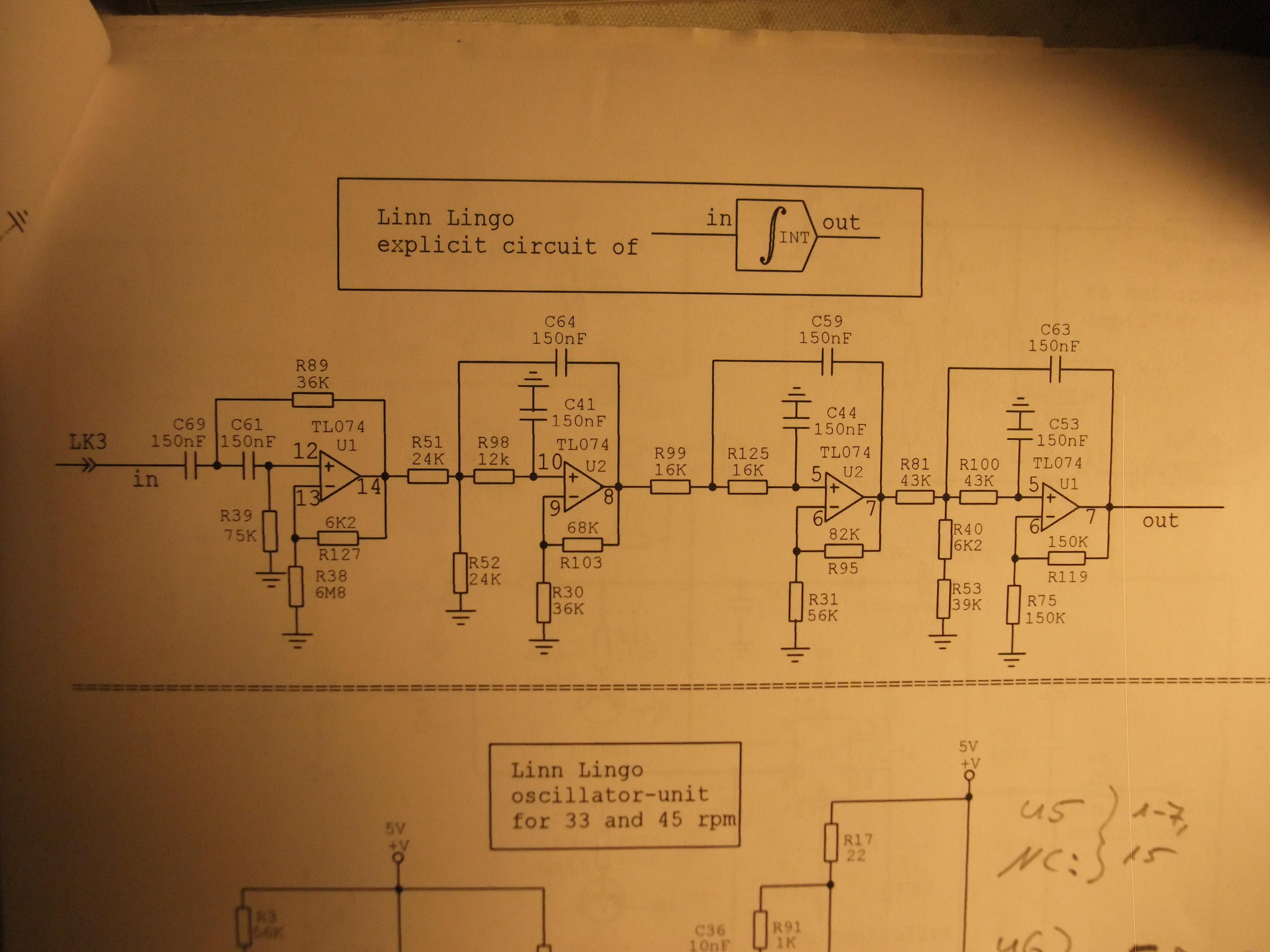

I just looked again at the Lingo circuit again. The designer obviously was making it complex for the sake of it. I don't understand using a simple transistor cyrystal oscillator when a 4060 does it better. Maybe he thought the 4060 was about to die. The output stage is very like the Valhalla which is ironic as Linn were convinced the two were very different. The Lingo uses TL074 in place of LM324N quad op amp. The filter looks to be similar to Ti Filter Pro solution ( was freeware and maybe still is ). If LM324N is used at low current it can give good results. 1mA perhaps. It has many virtues in near rail to rail use and seems to be based on a comparator ( LM339? + class AB stage ). I suspect if +/- DC rail version of the Valhalla could be built it would be better. Easy to say, harder to do. A State Variable Filer oscillator could be better. A simple strobe to set the speed. 33 1/3 - 45 would could 2 pence and a switch if so. ESP Audio show how that's done. The TD125 of which the LP12 is a cousin had the Wien variant of that and lamp stabilisier. Reading the TD125 review got me into hi fi. If Linn requested a 6 V version of their motor from Airpax it would have been better. It wouldn't be hard to hand wind that. The motor is very simple inside.

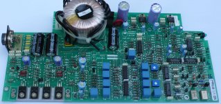

I am looking for the schematic of this version:
Linn Lingo Power Supply, 1994 model breaking down
In the attached image you will find the component side from the PCB.

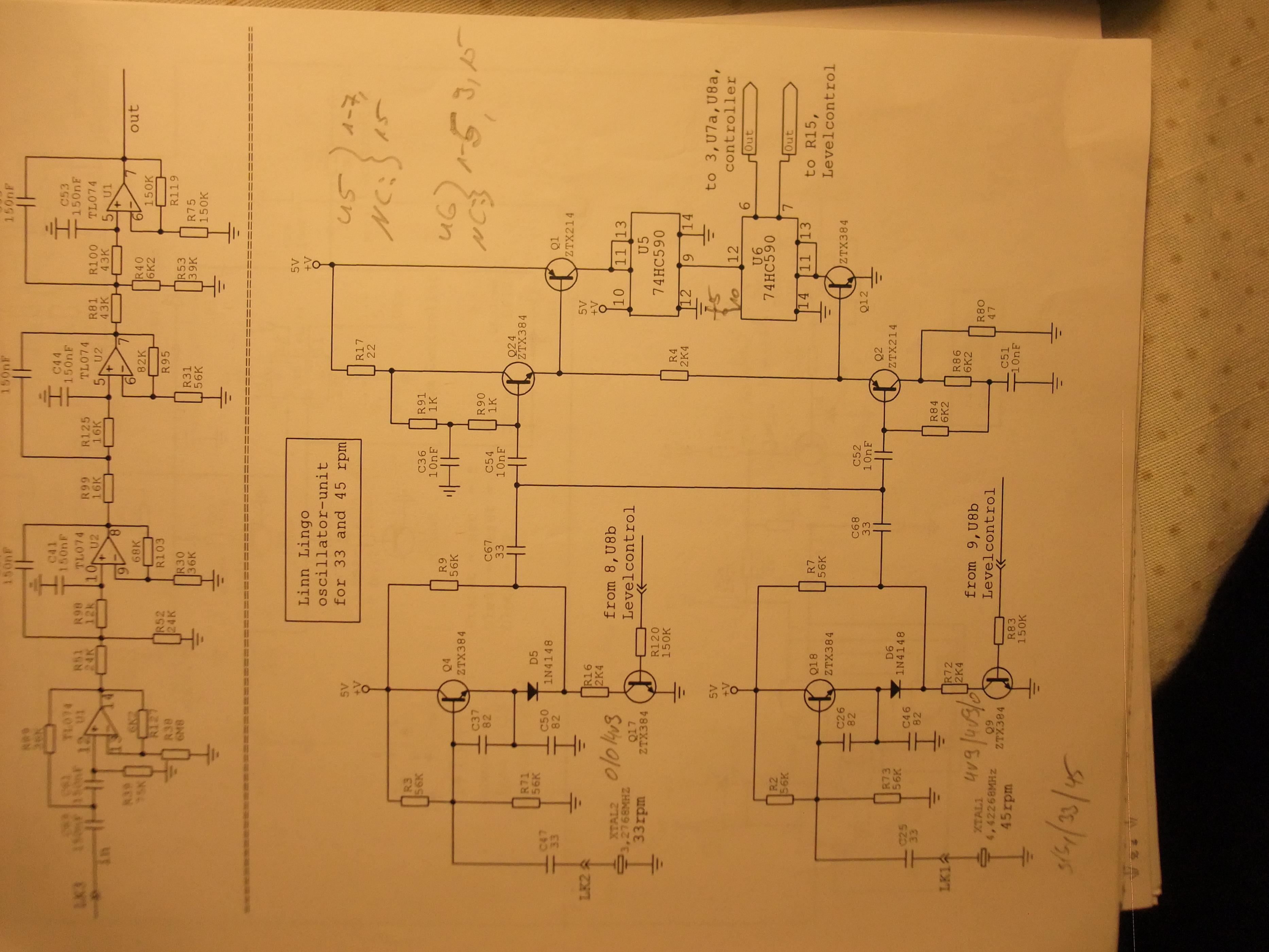

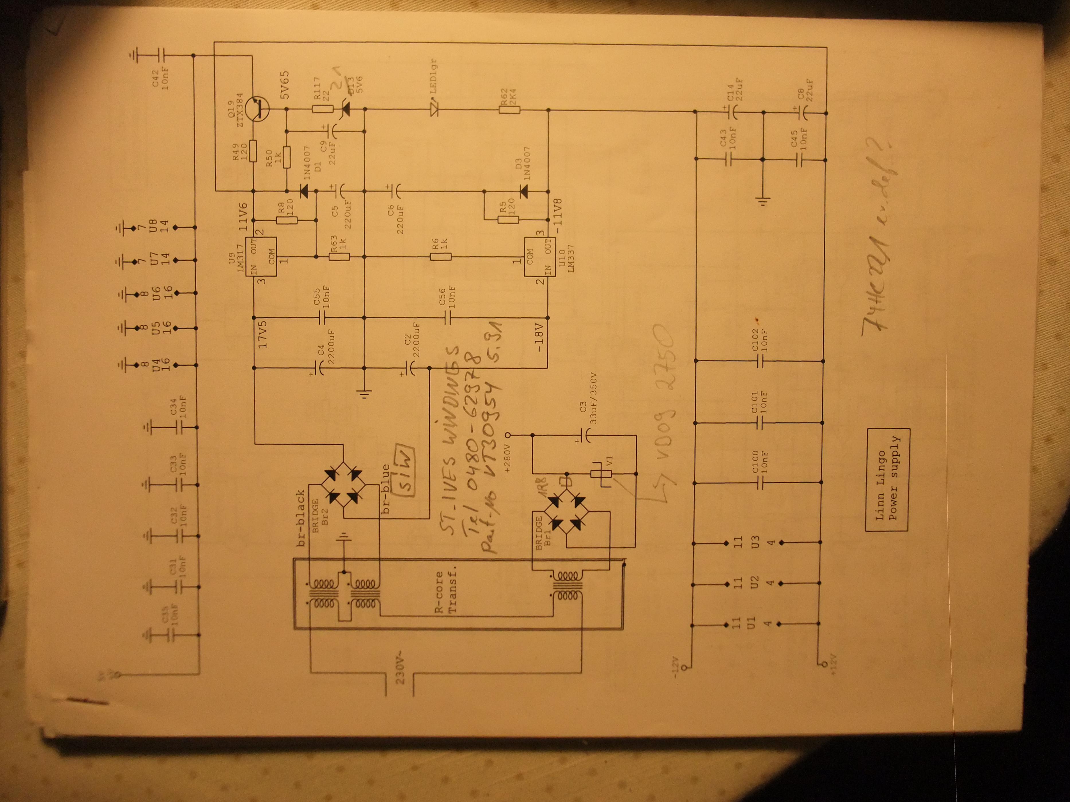

Schematic here

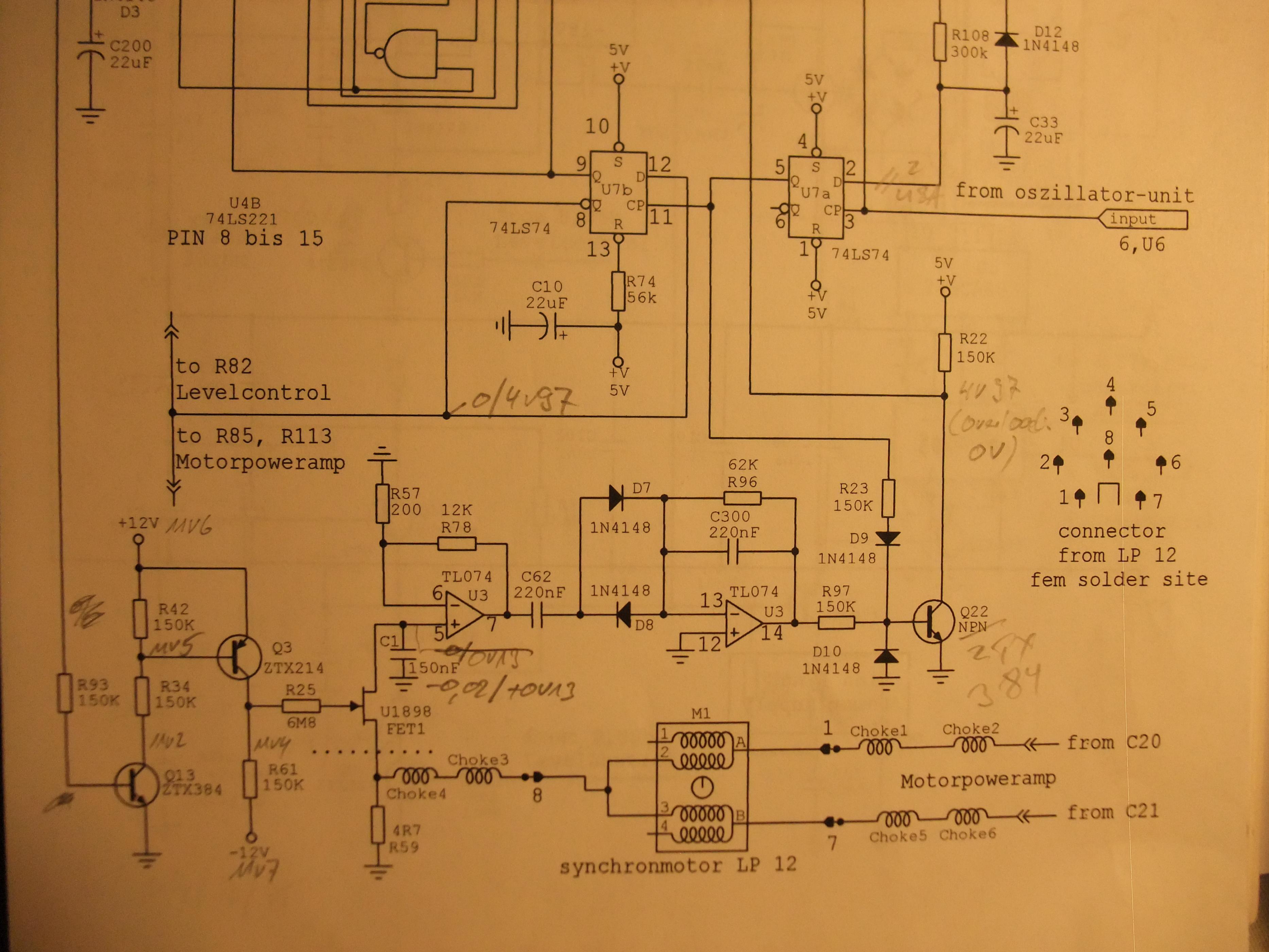

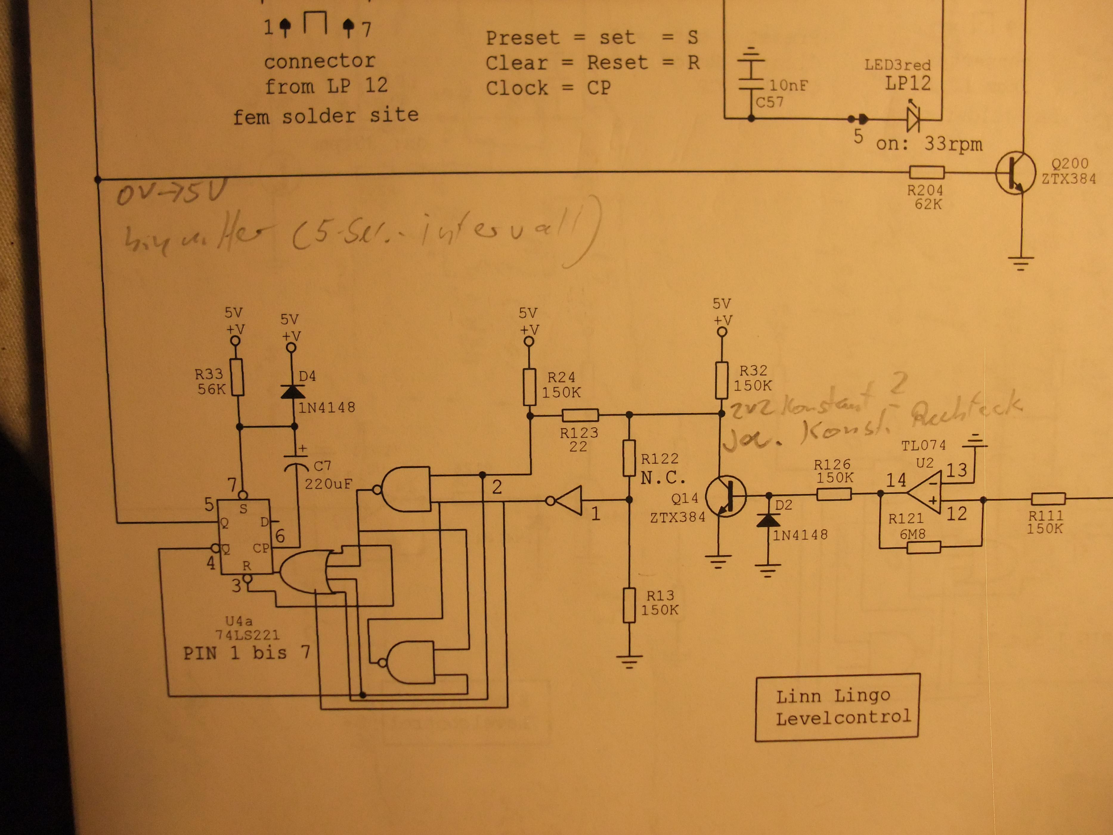

I found my self-made schematic of the version from previous posting by accident (go to attached images - it was in a place where I would normally never have put it).
At weekend I receive such a version for repair with follow unwanted effect:
The increased gain for the start-up phase of the plate returns again and again in the interval of 5 to 7 seconds.
If there is a correct operating, Q10 - controlled by PIN5 (Q) of U4a - switches the resistor R14 (6K2) to the resistor R64 (150K), but only for any few seconds (start-up phase) until the target speed is reached.
Then the transistor Q10 turn off the resistor R14 and the gain factor is reduced and is only defined by R64 and an additional not showed NFB-Resistor (to maintain the speed).
The question is now, why the gain does not remain at the value for normal operating and goes back to the enhanced value for the start-up phase.
At PIN 14 of U2 (TL074) and collector Q14 so as at R123 (22R) and PIN2, U4 (74LS221 or 74HC221) is a square wave present (2V4ss) and a DC voltage of 2V2.
Maybe U4 must be replace (this is very difficult, because the PINs are bent over on the solder side).
The actually question is this:
How can I prove without desolder whether U4 is faulty or not?
Thank you for advices (go therefore to the first four attached images).

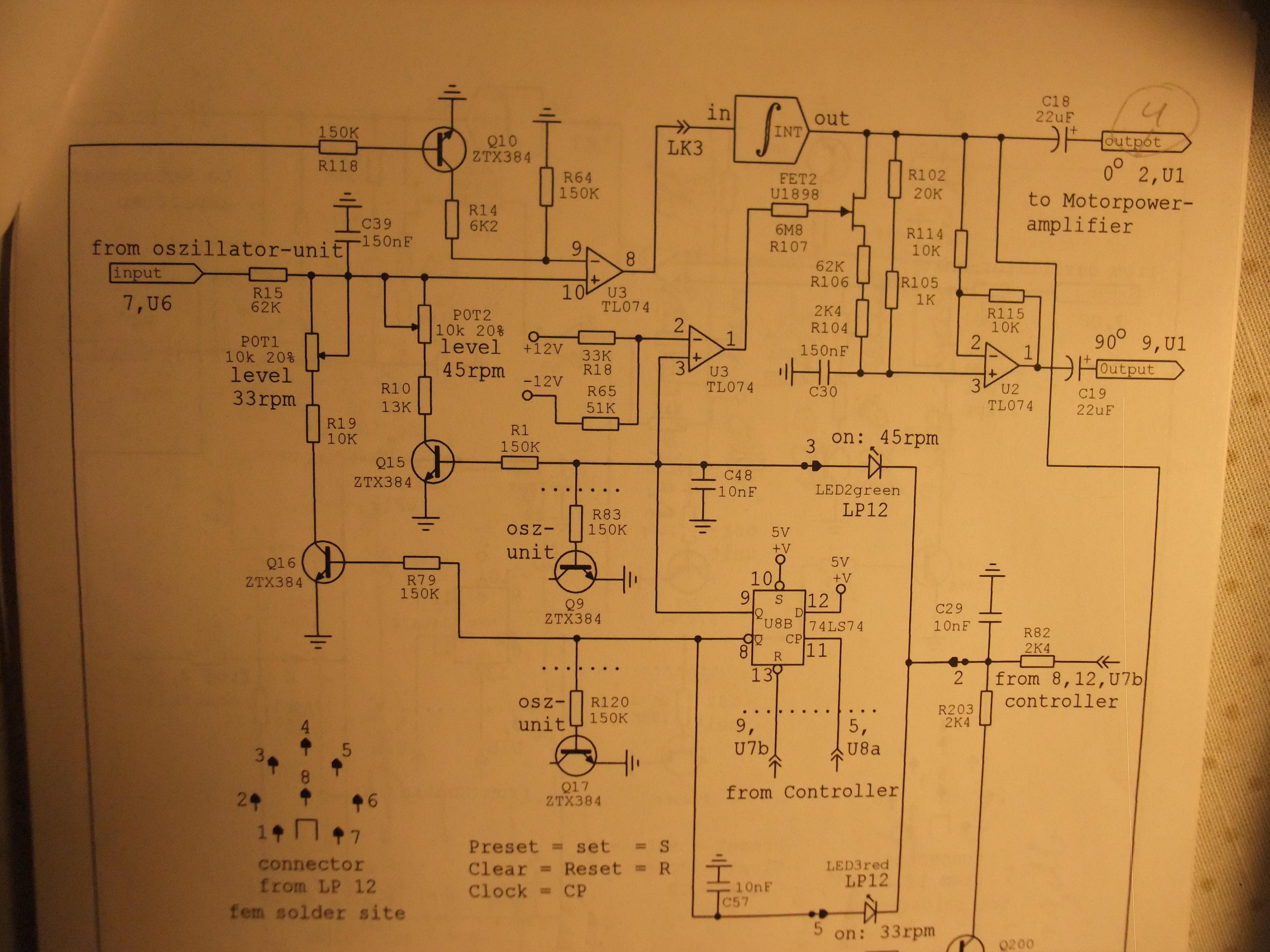

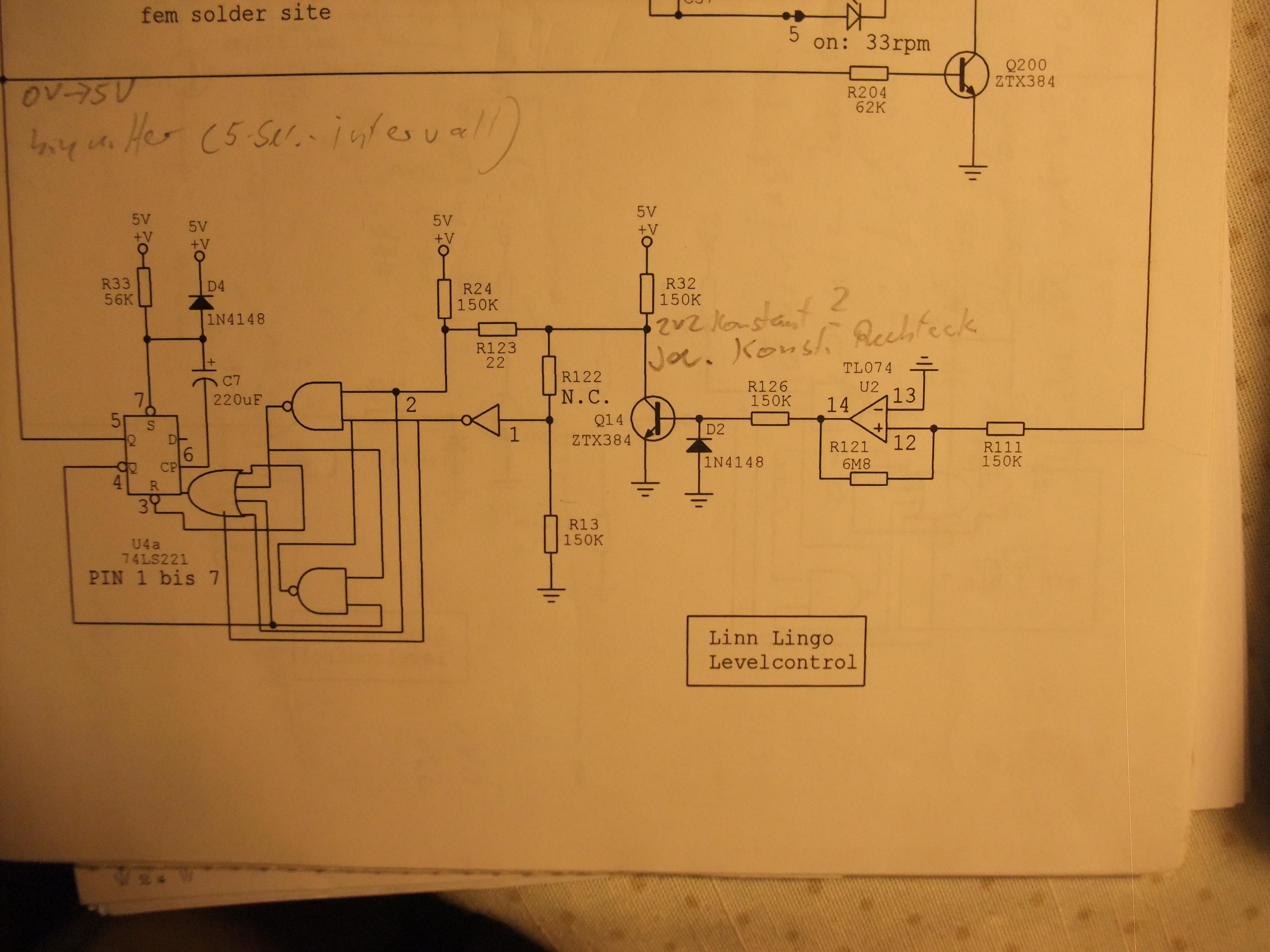

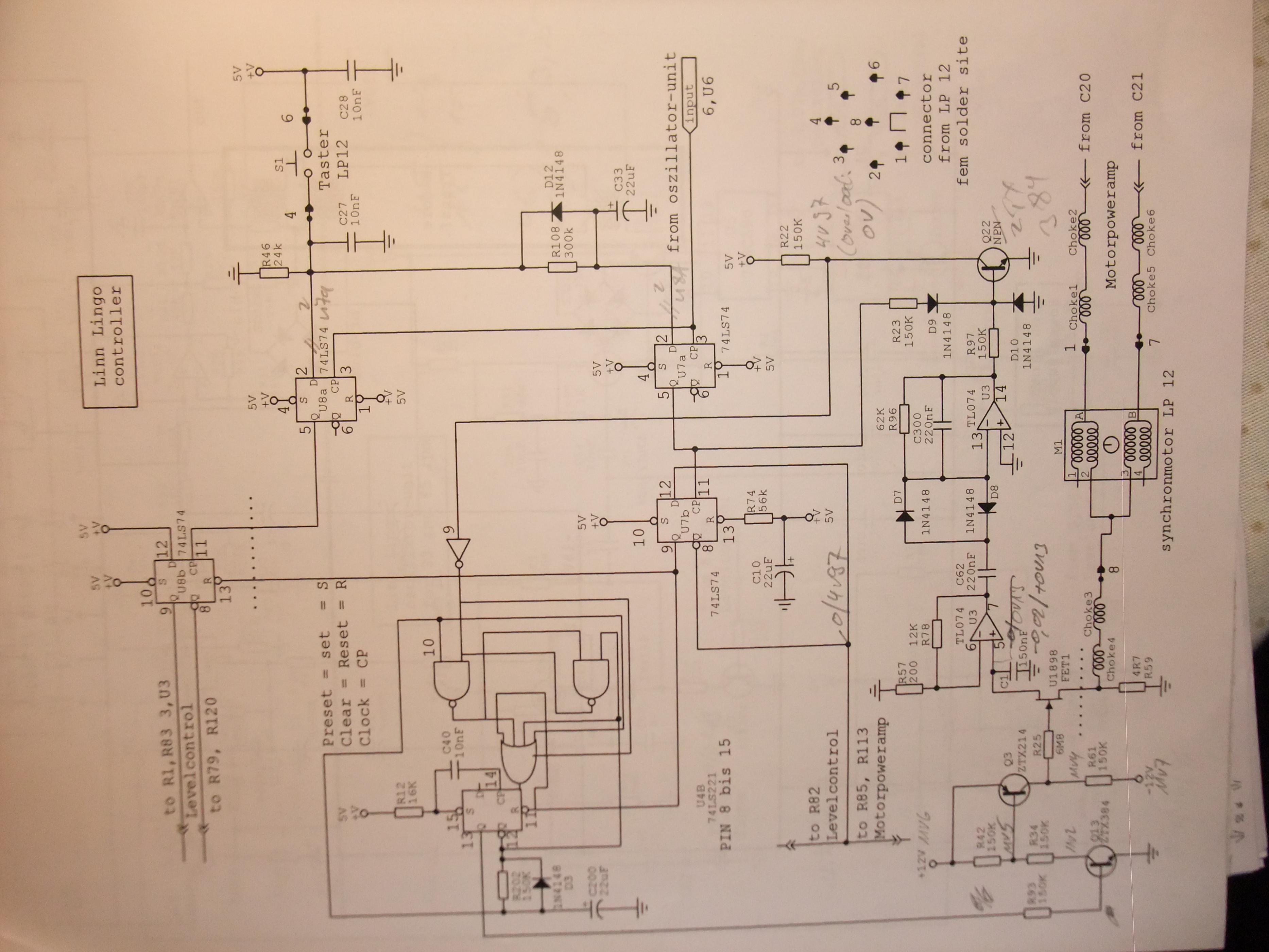

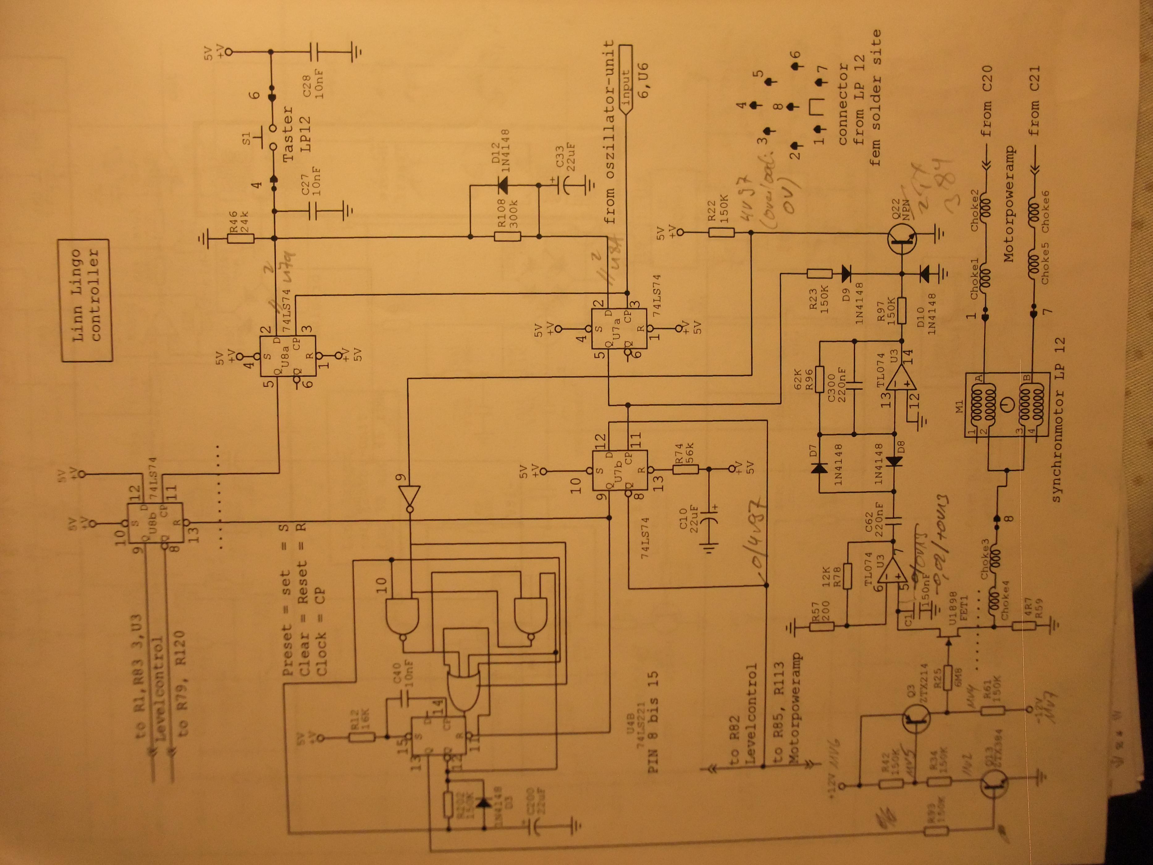

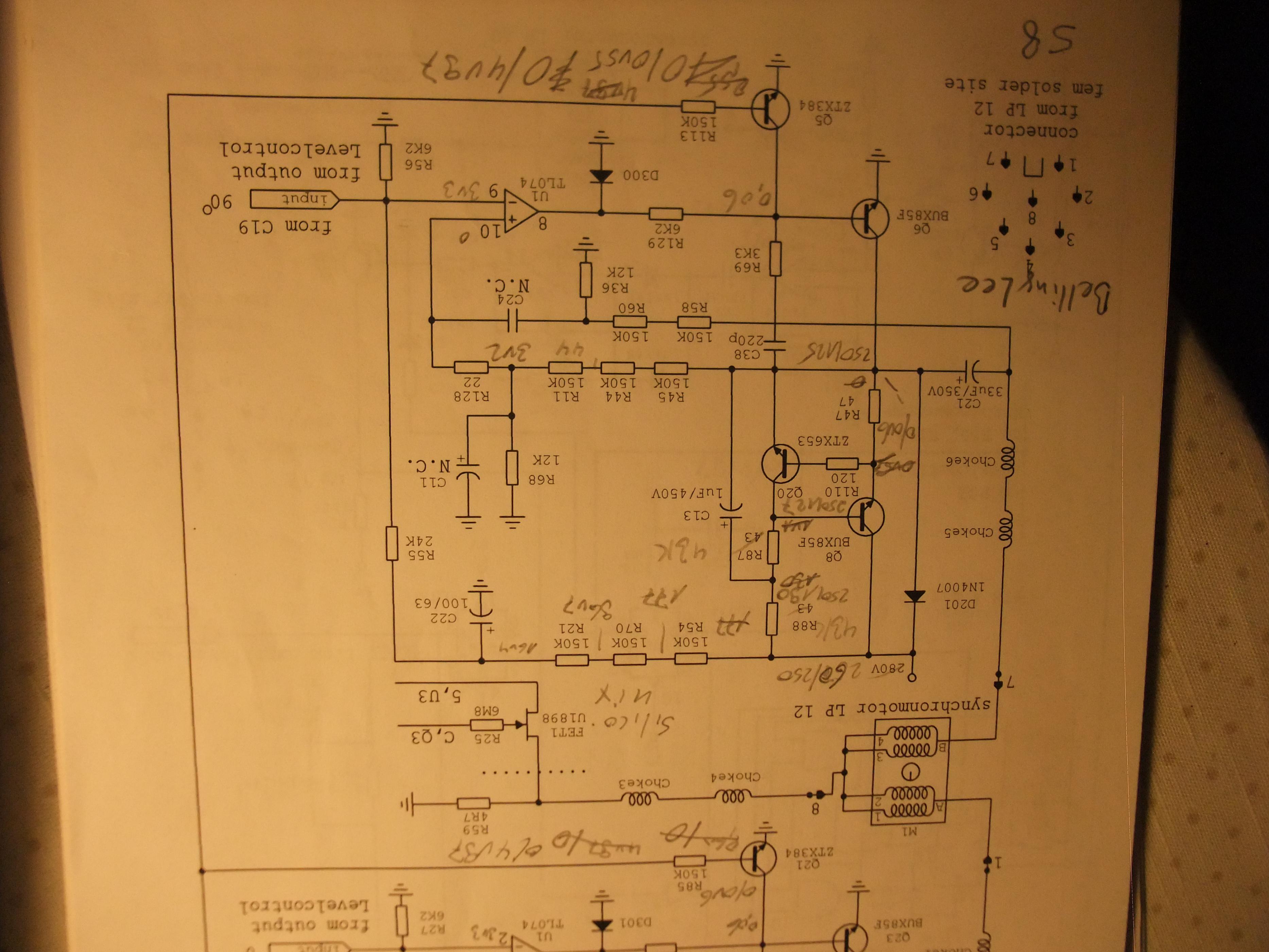

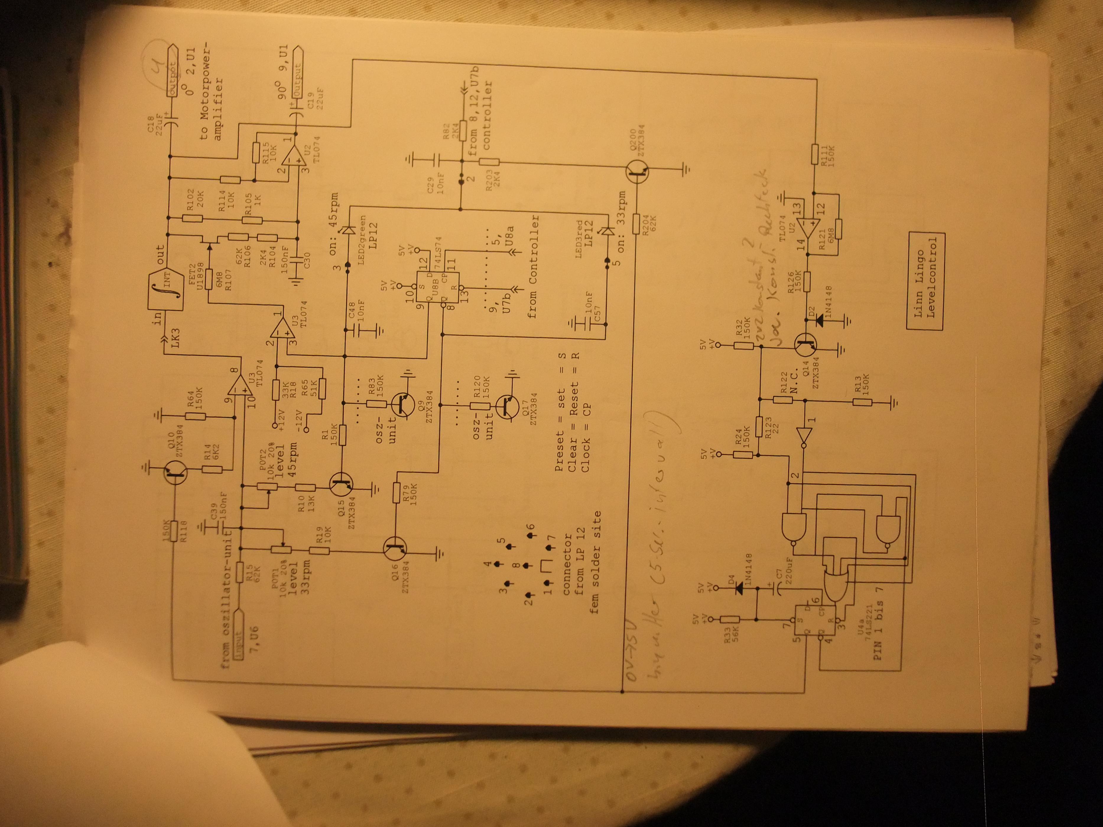

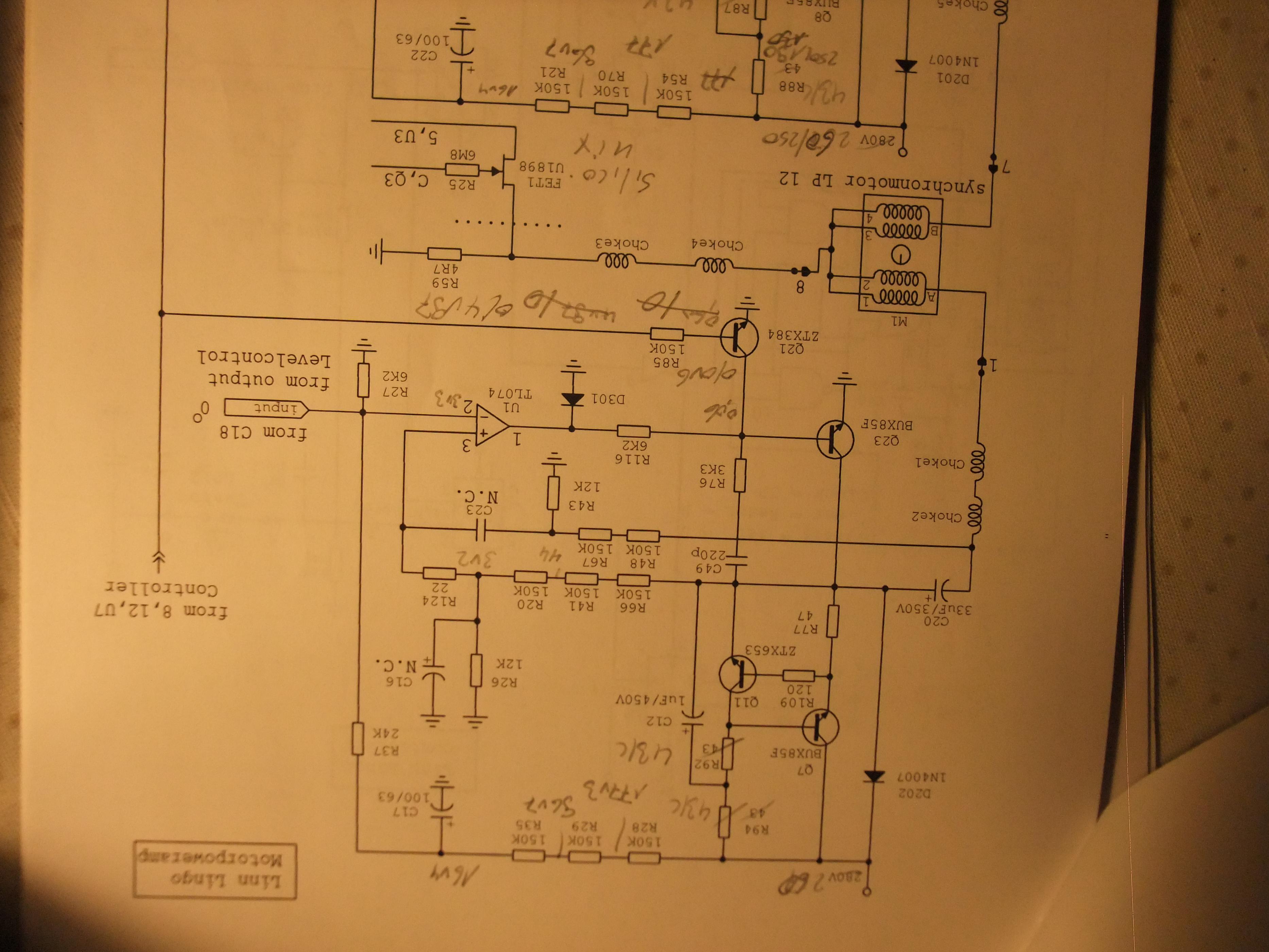

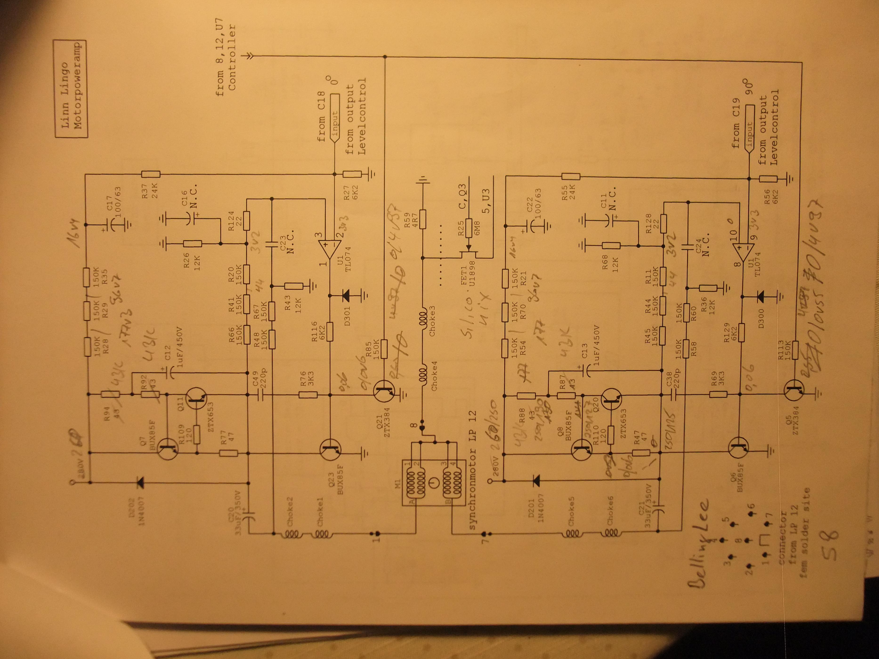

here are the remaining schematics
Please note (very important): Drawing errors cannot be excluded
