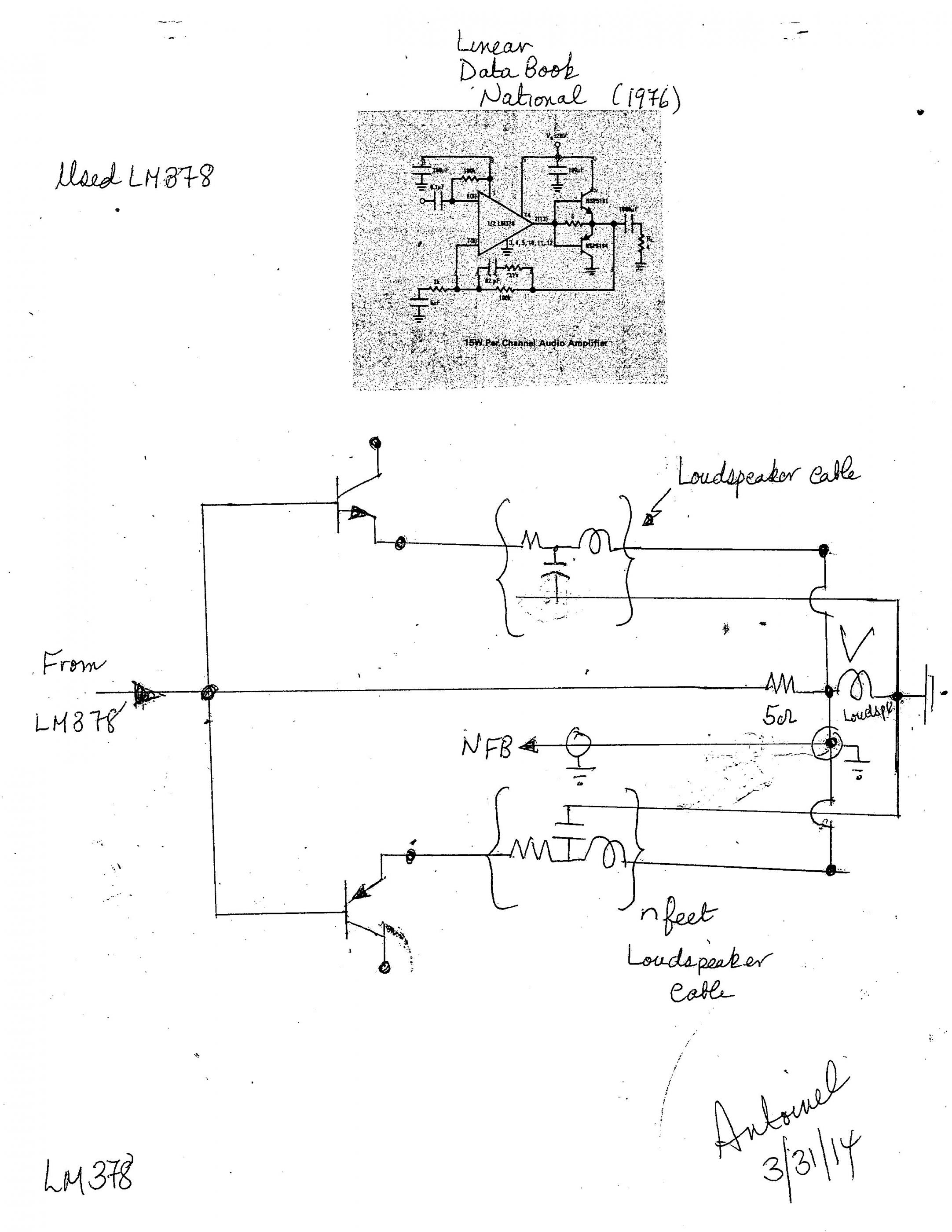

Hello tiefbassuebertr and DIYers. The attached picture shows the following:
- The top part is an example of an old schematic under current discussion less inductors attached to the emitter legs per the valid Linn patent.
- The lower hand-drawn portion proposes a simulation, and a non-commercial schematic which utilizes two loudspeaker cables as part of the bjts' emitter circuits.
- The article "Speaker Cables: Science or Snake oil" by Nelson Pass [www.firstwatt.com], shows a simple model of a loudspeaker cable in Fig.1.
- Each foot of a 2-conductor loudspeaker cable is represented by a network of a resistor, a capacitor and an inductor as I show in the attached bottom portion of the picture.
- One may wish to study a loudspeaker cable at several lengths, and/or many commercially available cables.
- A legitimate objective of this proposed study is an attempt to improve upon the Linn patent. Noting that any patent is merely a stepping stone to create future inventions if desired. There's absolutely nothing wrong or illegal to pursue such studies.
- May wish to demonstrate that a 10 foot 18 gauge zip cord [for example] per output bjt gives an "amplifier system" having a performance that is superior to the Linn amp. Wishful/optimistic thinking by me as the proposed "amplifier system" [aka LM378 amp plus 2n feet of loudpeaker cables] may oscillate and/or perform way worse than the parent by National, or by the Linn am; both used as prior art or references in the study.
- Loop NFB starts at the loudspeaker terminals. Reminds me of Kenwood's Sigma Drive.

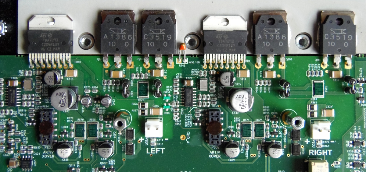

Here is a picture of the Klimax Chakra 500 TWIN prototype.
My suggestions for the marked areas are:
A. Bipolas with "Chakra" inductors (obvious)
B. OpAmp for ??? (most likely a DC-servo ? in the feedback path), you will find this in every Linn amp with Chakra circuit.
C. Sense resistors. Most likely sensing the V+ and V- current through the TDA and the bipolars. As the manual of the klimax tells us, the amp will monitor the current and will turn-off the amp in case of ultra high current. You will find this also in all Linn amps.
D. Boucherot network
E. A pair of diodes to minimize inductive backloads.
F. Most likely a quad OP-AMP. But what for ? The Klimax senses the input and turns-on when the audio input is >100µV. This quad could do this and at the same time acts as an input buffer (?).
G. This is R1 in the patent circuit.
Any other suggestions ??
Ideas and questions welcome.
