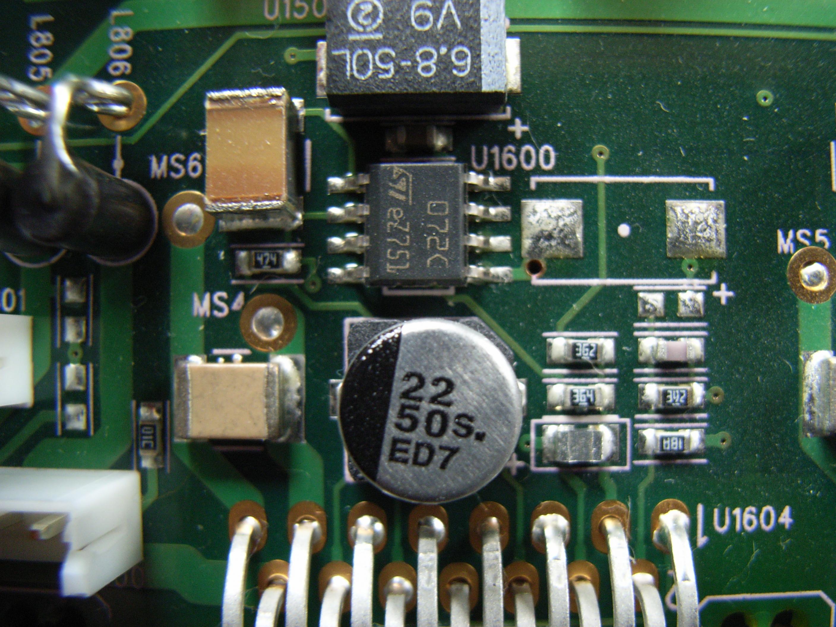

Indeed that's what I thought too, looks like some ST micro chip, unless they have ST make them for them.
yep, just looks like ST, i considered whether they had contracted them to produce it for them, but i find it doubtful, any company that really did spend years 'developing' a 'new ultra-linear ic technology' would generally get their own name printed on it. the moq would be so high to do that, that you would think they would throw such a service in.
nope and i better watch my words here, it looks to me to be more of a case of 'mutton dressed as lamb'

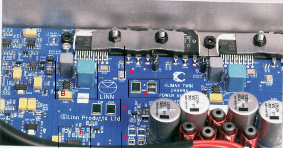

I assume the Linn Chakra circuit is the one in the patent drawing. It is an interesting apporach.
What really interests me is the purpose of the opamp in front of the TDA. This dual opamp can be found in every Linn amp, including the Sneaky DS (which does not have the Chakra circuit). I will attach a foto of the Sneaky DS, a Chakra 500 Twin and a Majik I.
I guess it is a DC-Servo, but I am not shure.
What do you think ?

What a total bollocks Patent application - talk about reinventing the wheel! its just Basic text book "Current Dumping"!
Edwins A+AB WirelessWorld artificial back in about 1971 "Invented" or at least the first time I'd seen principle, with Quad taking the idea one stage further and used a Bridge circuit to linearise the forward Gain as the "Current Dumpers" contributed to the transfer gain.
As David has already said, Quad (and others) uses Inductors in the Emitters to "shape" the crossover region between devices since the very early days when supposedly "complementary devices" where anything but - or in the case of the mentioned Quad designs the use of Quasi complementary output stages...
It says volumes about Linns designer "William Miller" that he's tried to patent a well known basic circuit topology... I suggest he learns a little more about basic audio design first before believing he's invented anything clever....

Hello. I did not see a value for their inductance. The site showed graphs of their impedance as a function of frequency starting at ~0.5 MHz. Maybe a DIYer has an answer.Those inductors are ferrite beads.
MURATA|BL02RN2R1M2B|FILTER, EMI, 7A, RADIAL, DOUBLE | Farnell United Kingdom
