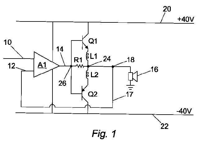

If you look at the patent schematics (upload of the pictures wasn't successful, I will upload them later), there is something new about the circuit.
They have added some inductors "for axtending a switching off period of the second amp (with the bipolars) to smooth any switching discontinuity", as the patent says.
When you look at fotos of the Linn amps (i.e. C2200,Klimax Chakra 500) you will notice the
inducters close to the bipolar transistors.
That's the new circuit by Linn.

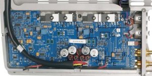

Klimax Chakra 500 Twin
Here is a picture of the Klimax Chakra 500 TWIN prototype.
My suggestions for the marked areas are:
A. Bipolas with "Chakra" inductors (obvious)
B. OpAmp for ??? (most likely a DC-servo ? in the feedback path), you will find this in every Linn amp with Chakra circuit.
C. Sense resistors. Most likely sensing the V+ and V- current through the TDA and the bipolars. As the manual of the klimax tells us, the amp will monitor the current and will turn-off the amp in case of ultra high current. You will find this also in all Linn amps.
D. Boucherot network
E. A pair of diodes to minimize inductive backloads.
F. Most likely a quad OP-AMP. But what for ? The Klimax senses the input and turns-on when the audio input is >100µV. This quad could do this and at the same time acts as an input buffer (?).
G. This is R1 in the patent circuit.
Any other suggestions ??
Ideas and questions welcome.
First Schematics
This my idea of simplified schematics for the Chakra circuit.
1. 1st stage as input buffer and low pass filter
2. TDA with OPamp in feedback path as DC offset servo (I have seen this a couple of years ago in a Burmester 878).
3. The Chakra stage withe the bipolars and the inductors.
4. The output shows the boucherot and the protector diodes.
Any mor suggestions on this ?
Kind regards
Kind regards
I think the bipolars are placed differently, see http://www.diyaudio.com/forums/chip-amps/42578-about-linn-power-amps-2.html#post582631
Hi Jo!
The inductor is connected to the emitter,you are right. But the transistors could still be connected as in the other thread (but I'm not sure). They always try to hide things in patents and with the TDA7293 it really works well to put the bipolars there. Can't anyone check this on their chakra amp? 😀

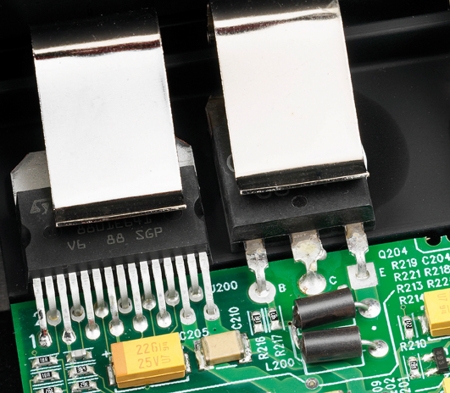

Those inductors are ferrite beads.
MURATA|BL02RN2R1M2B|FILTER, EMI, 7A, RADIAL, DOUBLE | Farnell United Kingdom
The output stage is nothing new and is a form of current dumper, I have used for years. The only thing I see different are the inductors on the emitters of the output devices. I seriously doubt the patent will hold up in court.............just my two cents.
Right. Probably wrapped around some copper-nickel alloy wire to replace the "ordinary" emitter resistors. Looks more like voodoo to me... 🙄
the text would lead you to believe that they developed their own chip, doesnt look like that?
Indeed that's what I thought too, looks like some ST micro chip, unless they have ST make them for them.
Looks like a simplification of the 405 current dumper to me. Back when the 405 circuit was analysed in Wireless World, I built a LF351 opamp based prototype with a pair of output transistors with no bias and single output inductor. I found that even with no bridge, feedback was enough to make this circuit work pretty well into headphone loads.
ST make power opamps, enough to drive 1V into 4R before the dumpers take over
