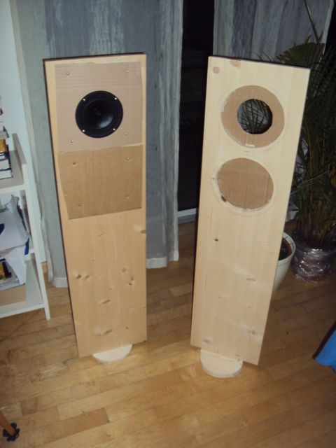

I build my dipole Watsons in less then an hour.
I made a simple passive crossover for my Watsons. They span around 2 and 1/2 octave
from 200 Hz to 1200Hz. I have Behringer equipment for time delay and response shaping but i will do the first listening tests with this passive crossover and without delay.
I will also place the Watsons in a different way. I will put them on my side, like a big headphone.
