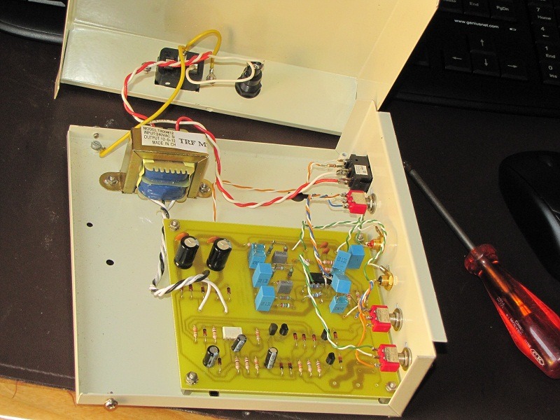

I recommend to not simply use a LT filter, as it will amplify all frequencies below boost down to DC. Add a high-pass filter to protect the woofer from signals at frequencies below its usable bandwidth. You can use a high-pass filter to do both, by tuning it to give a peaking response where you need the LT effect.
https://sound-au.com/project197.htm
use a high-pass filter ............... by tuning it to give a peaking response where you need the LT effect.
you are creating some undefined conjugate - use ltx as intended or not at all
It's not clear what gave you the impression of an "undefined conjugate". No reason for it to be undefined. Back when I designed the circuit I had built, I was using Speaker Workshop, an early freeware loudspeaker measurement and design software. I was able to define a high-pass filter as target curve and tune the filter to achieve the desired final response.
LT is a solution to a part of the design problem. That is, to extend LF range downward by introducing a shelf filter. But it introduces a new problem: possible LF overload. A complete solution would include a high-pass filter to limit LF energy into the woofer. However, it does not need 2 sections (i.e., LT + HPF): a single peaking HPF can achieve both.
