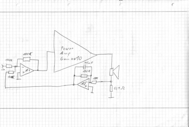

2. Generally the linkwitz transform for improved bass gives high
gains at low frequencies. This will run the amp at higher power levels
than without linkwitz transform.
Hi Angel!
I did not try to change the Q with a linkwitz transform, but
with a negative output impedance of the amp!
Nice thing, for low frequencies you can imitate any driver Q.
If you look at the speaker itself there is a mechanical Q and an
electrical Q. The elctrical Q is a result of the magentic field , turns of bobbin, and coil resistance. The electrical loop is closed through the
amp. The output impedance of the amp is considered to be about zero, as it is typically much much less then the coil resistance.
So the resistance of the electrical loop is normaly the resistance of the loop.
If you increase the resistance of this loop the Q will increase, too.
Simply put a series resistance (and increase gain of amp in order to get the original signal level to the speake)
By lowering the resistance of the loop you can get lower Q.
For this your amp would need a negative output impedance.
For low frequencies you can achieve this by measuring the
current through the speaker and feed this signal back (positively!) to the input of the power amp..
The attached schematic will make an -0.9 Ohm impedance.
1 A current through the current shunt will give a 0.1V to the inverting amp A2. Output of A2 will also be 0.1V.
A1 sums the current signal with the input.....
0.1V of the current signal + input will be given to the power amp.
The 0.1V of the current signal will result in 1V more out, due to the gain of 10 of the power amp.
This means 1A current through the speaker will make 1V MORE output, which means a negative output impedance of abpout -1 Ohm, well - 1 Ohm + 0.1 of the current shunt = -0.9 Ohm.
You can play around with various opamp circuits and you can simplify it down to 1 OP amp or no additional OP amp if you integrate all this into the feedback of the power amp.
But for first steps I would go this way, without modifying the power amp.
You have to take care for the following points:
-Check the gain and phase (inverting/ non inverting) of your
power amp!!! If your amp is inverting then you must use A2 in a noninverting connection.
- This current feedback is only suitful for low frequencies.
15nf in parallel to 10k cut off it effect above 1kHz. If you skip
the 15nF you can expect oscillations.
General this feedback may cause issues if your amp is critical
in frequency compensation.
-Value of negative output impedance must always be less than the
coil impedance!!!! Otherwise the circuit get instable as the
the loop (resistance of coil+ resistance of speaker)
is regulated to a negative overall resistance!!!!
-You may readjust the overall gain with the input resistor.
-Be careful and forget this idea if you are not familiar with
designing OP amp circuits, feedbacks, and frequency compensation.
Malfunction can cause defects in the power amp as well as in the speaker.
Good luck
Markus
