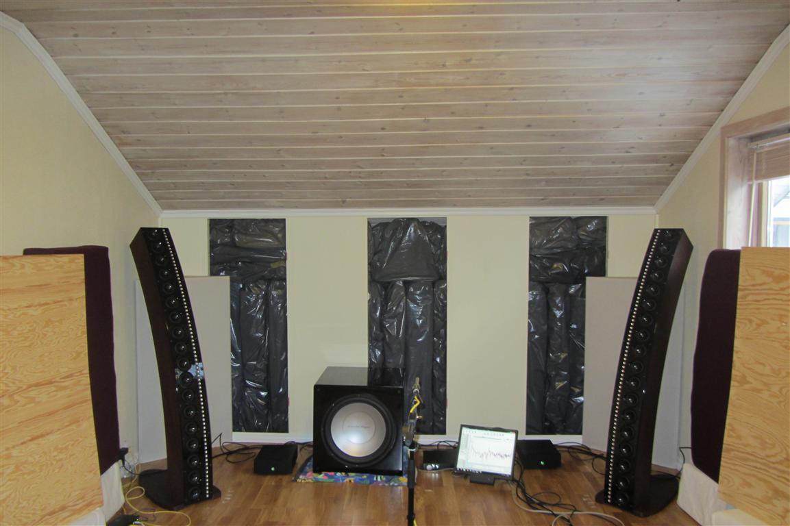

Omholt, is this your room?
attachment.php

I don't see any listener located in the room ...
What's happening in there ?
:rolleyes::(
I'm waiting the 11th of april to see the movie 'Oblivion'
where the Earth is inhabited by drones
are those the target listeners ?
