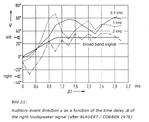

This from Blauert:
UNIVERSITY OF MIAMI
Horizontal plane localization of sinusoidal (solid) and narrow band noise (dotted) as compared to a reference sound of wide-band noise at 0, 40, and 320 degree azimuth locations. Shown versus frequencies to 5 kHz. Reprinted from Blauert (1999) with permission from the MIT press
You can see localisation accuracy improves towards lower frequencies. There is no evident trend to be seen that localisation accuracy would get worse towards 500Hz but all the curves merge together and not deviate. Actually the highest deviation is to be seen above 2kHz.

Maybe you'll like to take another look at the figure in my post #1402.
The localisation angles for wide band signal are shown with arrows. The localisation angle for narrow band signal is the dotted line. You'll see at low freqs the angles for wide and narrow band signals coincide, whereas at high freqs the angle for narrow band signal deviates from wide band angle. This is to say localisation angle be determined based on low freqs rather than high freqs, quite opposite than you suggest ?

Your Blauert figure is for the case of direct signals - probably no more than 1 ms apart?

I may finally get into hold of what are we talking about 🙂
Yes I believe my picture was within the interaural difference below 1ms.
Your picture is interesting in that after 1ms low freqs affect the perceived angle much more severely than high freqs.
This implies low freq reflections are more severe than high freq reflections.
This results in we need high directivity speakers at low frequencies in order to minimise low freq room reflections.

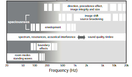

This is fig. 5.2 from Toole's book. At least for any spatial issues it suggests less importance of the range below 500 Hz imho.
Again coming back to this regarding the localisation part of it, is this table based on perception of real sources or two speaker phantom sources ?
- Elias

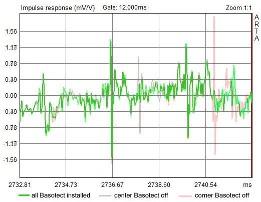

This is a magnifying glass into the impulse response. The front wall reflection is the grey one in the middle. The corner reflection is the light red one to the right. The description in the link concerns only the front wall reflection. I could show that two 40x40 cm pieces of Basotect are sufficient to do the work. It doesn't need the complete wide piece along the desk.
Rudolf

We must be well aware, that I'm not talking about primary stereo localisation in the free-field, but about localisation stability in the superimposed sound field: How does a reflection, arriving 5-15 ms late, affect the original stereo localisation?
With those two frontwall/corner reflections "in place", some off-axis phantom images had a tendency to (sort of) cluster or bloom around the frontwall mirror points and the front room corners. This tendency changed with the pitch of the sources/instruments.
After applying the Basotect in those spots, the phantom images are "locked" in their position and more evenly distributed.
You could always argue that this "can be only the beginnig", but it is the largest step one can do with the least effort.
