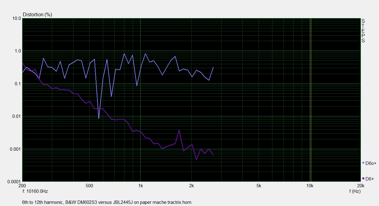

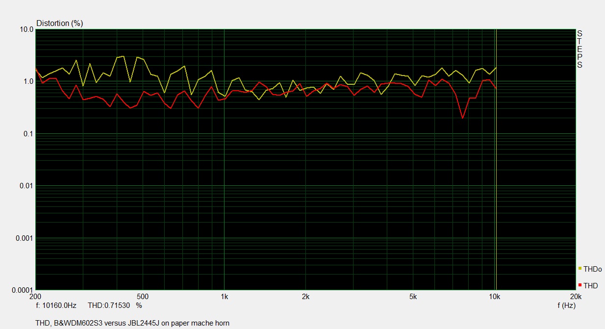

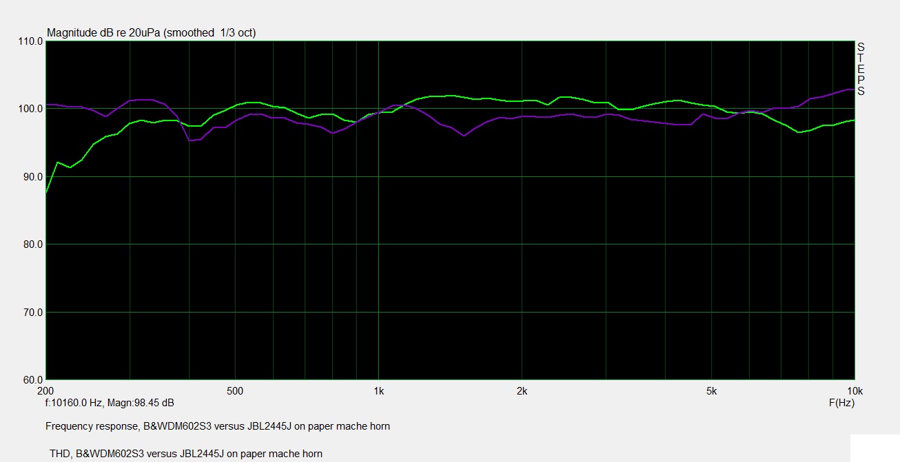

I've been trying to dig into this problem of quantifying dynamics. Here's some tests I ran recently.
Test Equipment: STEPS (ARTA), EMU 0204 USB soundcard, Dayton mic. Calibration using sound calibrator (+-0.5db), i.e., SPL values are absolute. Amp is Class A solid state rated to 40W at 4 ohms, so the higher harmonics driving the B&W should be low (but I haven't checked).
I wanted to find out what made the tractrix horn plus JBL 2445 combination sound so "dynamic" compared to a standard speaker, such as the B&W DM602 that I have on hand. This B&W is a standard two-way, with the woven kevlar (yellow) driver and metal tweeter.
The test is to measure distortion at 100 db at 2m. It is an indoor test and is somewhat corrupted by reflections, but it still shows something (IMO). The mic is setup at 1m, and the result is normalized for 2m.
So, here's the data. The first pic shows the frequency response of the JBL2445 on the tractrix horn and the B&W. It is 3rd octave smoothed. I was shooting for 100 db at 1 kHz, and made no effort to EQ the rest of the response. The horn/JBL combo is the one that has more output at 2 kHz. The next pic shows the THD of the two and it's pretty close.
But we know that THD is meaningless and higher harmonics are important. So, the next pic shows the 6th-12th harmonics. Overlay is the B&W data. And now, some difference shows up. The horn is way lower than the B&W. The B&W distortion is also less smooth, but that may be because of the reflections.
STEPS uses a heterodyne method for calculating distortion. I played with the integration time and other parameters a bit and found that apart from the integration time, not much else has a big impact on the result. If someone wants to suggest optimal values, I'm all ears. I'm still not certain whether I'm using the right values.
Reflections are definitely corrupting the B&W data, but the important thing I feel is to look at the overall trend and not the absolute value at a single frequency.
