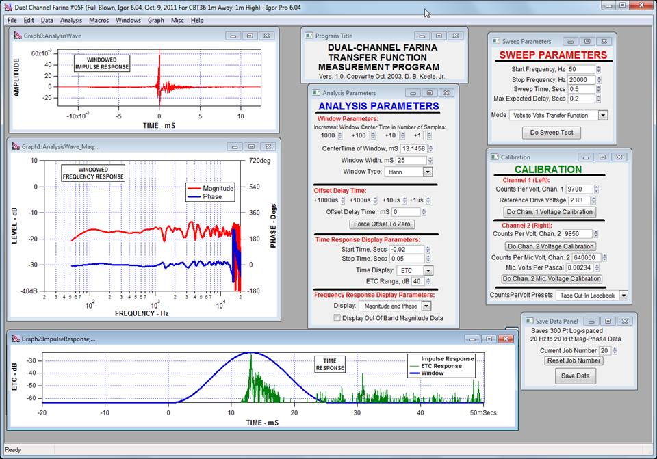

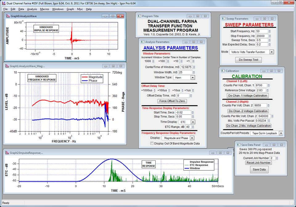

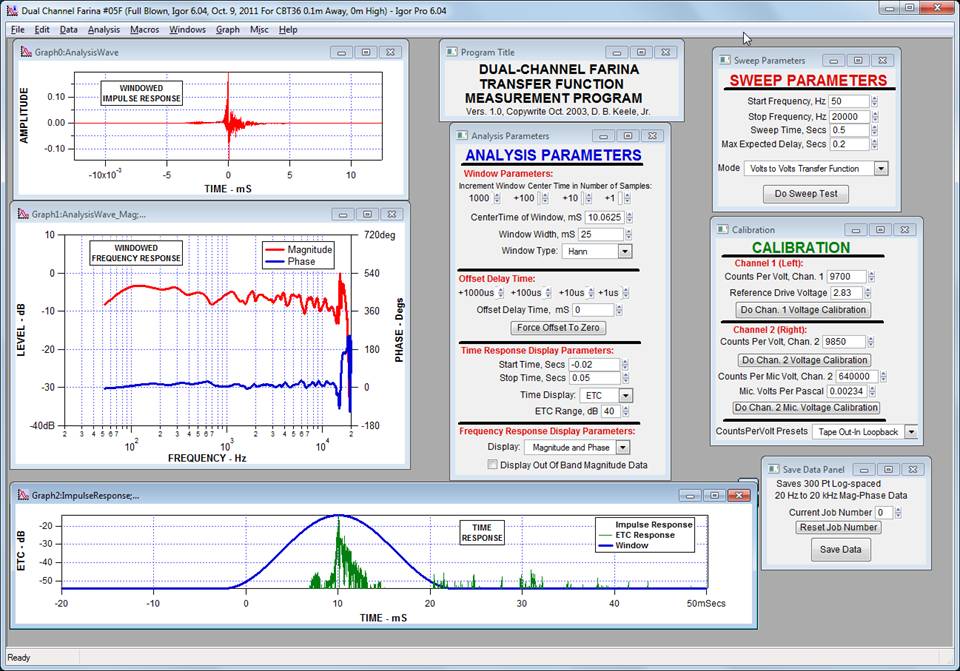

The room is always the weakest link, or the speaker and room integration. Even the best speaker can sound poorly. An uneven frequency response, flutter echo, loads of high gain specular reflections, bass resonances, long decay etc. will not exactly give you a goosebump experience. I have yet to hear a proper setup at a show or in a store. The result is below mediocre at best.
Below are some impulse responses of CBT36. See at the top for description (distance and height). Sorry that I don't have anything more zoomed in.

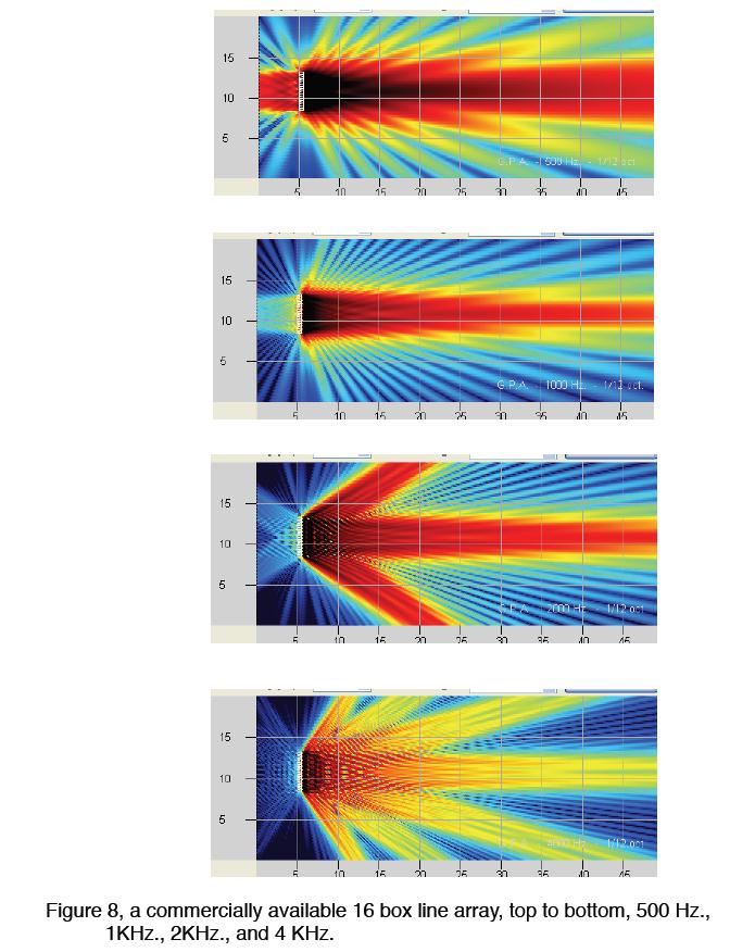

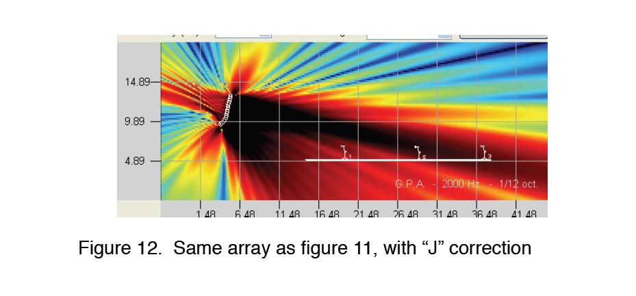

I concur. CBT behaves differently from a simple J array or similar arrays. For example it does not have the (near field) lobing problems. In fact it solves the problems those traditional line sources have.
Yes. A line array has a lot of lobing.
