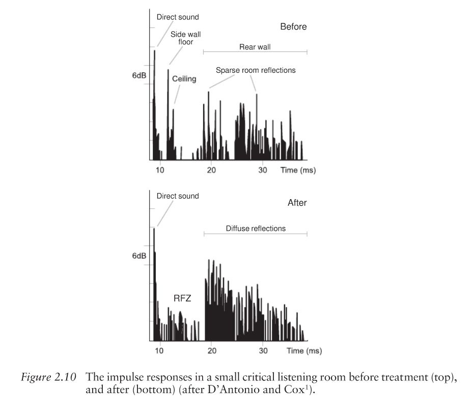

Personally I prefer a combination of correct and sharp image with a diffusive backwall with it's enlargement and envelopment. Best of two worlds IMO. And it's not intruding on the recorded signal if the diffusion arrives late enough.
attachment.php
oh yes, RFZ rooms are best for all types of music.. back to pre-psychoacoustic era!
It's up to you if you want an accurate and critical listening environment or not. I wouldn't call accuracy pre-psychoacoustic era. I've yet to hear anyone who didn't enjoy greatly a well designed RFZ room. I hear plenty who don't enjoy either a contribution from frontwall or sidewalls though.
We don't hav a lot of researches of different types of room treatment and speaker arrangements when it comes to preferences. We do however know a lot about accuracy and the effect of early and later arrival reflections.
Toole's researches are interesting, but doesn't necessarliy tell us that much. First of all they were not very conclusive. It varied with the music material. Secondly, the room and the way they were treated obviously would have an effect. It's not exactly a shock that several preferred some lateral reflections in an anechoic chamber. The speakers may also have had an effect.
As far as I know Toole never conducted the researches in a LEDE/RFZ type room with diffusive energy from behind. I wouldn't be surprised if the result would have been different then.
Either way, it's up to the listener what to choose. Very few get to compare different arrangements and often end up defending what they have already chosen. That doesn't take us any further.
