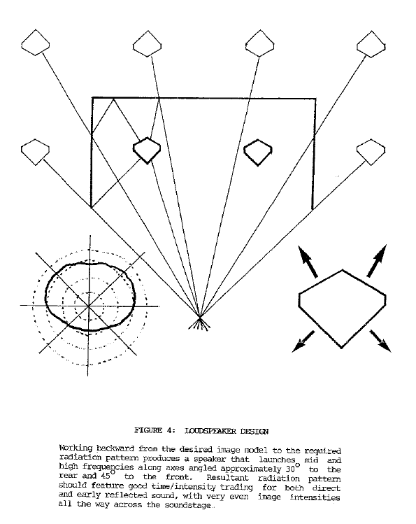

According to his 'image model theory' the ideal speaker directivity looks like this:
https://docs.google.com/file/d/0B0T6TlNEclozZTcxZGUxNTctNmNhMC00MDFjLTk0MzUtY2NkZjU2M2ViMDYw/edit?hl=en&pli=1
It should have 4 main lobes, and the rear lobes should be stronger than the front lobes. This way the speaker interacts ideally with the listening room according to the theory.
I see that the rear radiation is 6db louder than direct. This will be equal in amplitude considering the distance from the listener, but very delayed.....where as the sidewall reflection is 6db less than direct.
Your invention uses stronger sidewall reflections compared to direct, yes?
So this is something to talk about.
I think the drawing is to be taken as a rough sketch - not saying that there should exactly 4 lobes as shown. What this drawing tells me is that I should have an omni or dipole pattern with a certain all-around shape, not something with 4 beam (which would be pretty impossible to build anyway).
jan
it does look very dipole like, but he can control the reflection level! not a bad idea?
Is the polar for the Orions right on the powerpoint? Seems a bit strange, no?
If you build a dipole with drivers that have, in their operating range, a wide dispersion, you have in effect build yourself an omni. Is that what you mean?
