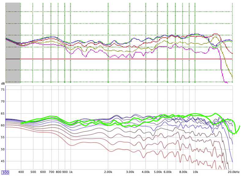

FWIW (as if it probably hasn't been posted throughout this thread) here's the frequency response on the Behringers:
VS Mark K's ER18DXTs
Different scale/conditions I know. But to me, that 1khz dip on the behringers in particular looks like it should be audible.
a 3db dip is audible for you?
I sure hope your room as many many bass traps and diffusers, because your room likely inflict much bigger problems then 3 db dip.
I will post soon my before and after in room response with and without treatment. I had 20 db dips and peaks, now all within 6 db.
That's the passive one, which is comparatively not so good, but in any case that measurement doesn't really look like it's reaching that low in freq. accurately. Pretty hard to find measurements of the active one, although you can see it in Geddes' polarmap program online (displaying a minor peak around 1kHz on-axis..., although in the context of the whole polar, it's probably better described as a slightly recessed response from ~1.6k-5k).FWIW (as if it probably hasn't been posted throughout this thread) here's the frequency response on the Behringers: ... But to me, that 1khz dip on the behringers in particular looks like it should be audible
I'll measure the active ones.

What about John Krutke's measurements of the passives?
Why do they differ so much from the example above?
Judging from his measurements, it looks like the WG is too small.
Hmm, I think the waveguide looks okay in that, but I had to fix the scale for the difference. It is a bit different in the upper mids, but same features... I think I'd go with John's on this one.http://zaphaudio.com/temp/b2031p-system-horizontal-offaxis-0-15-30-45-60.gif
