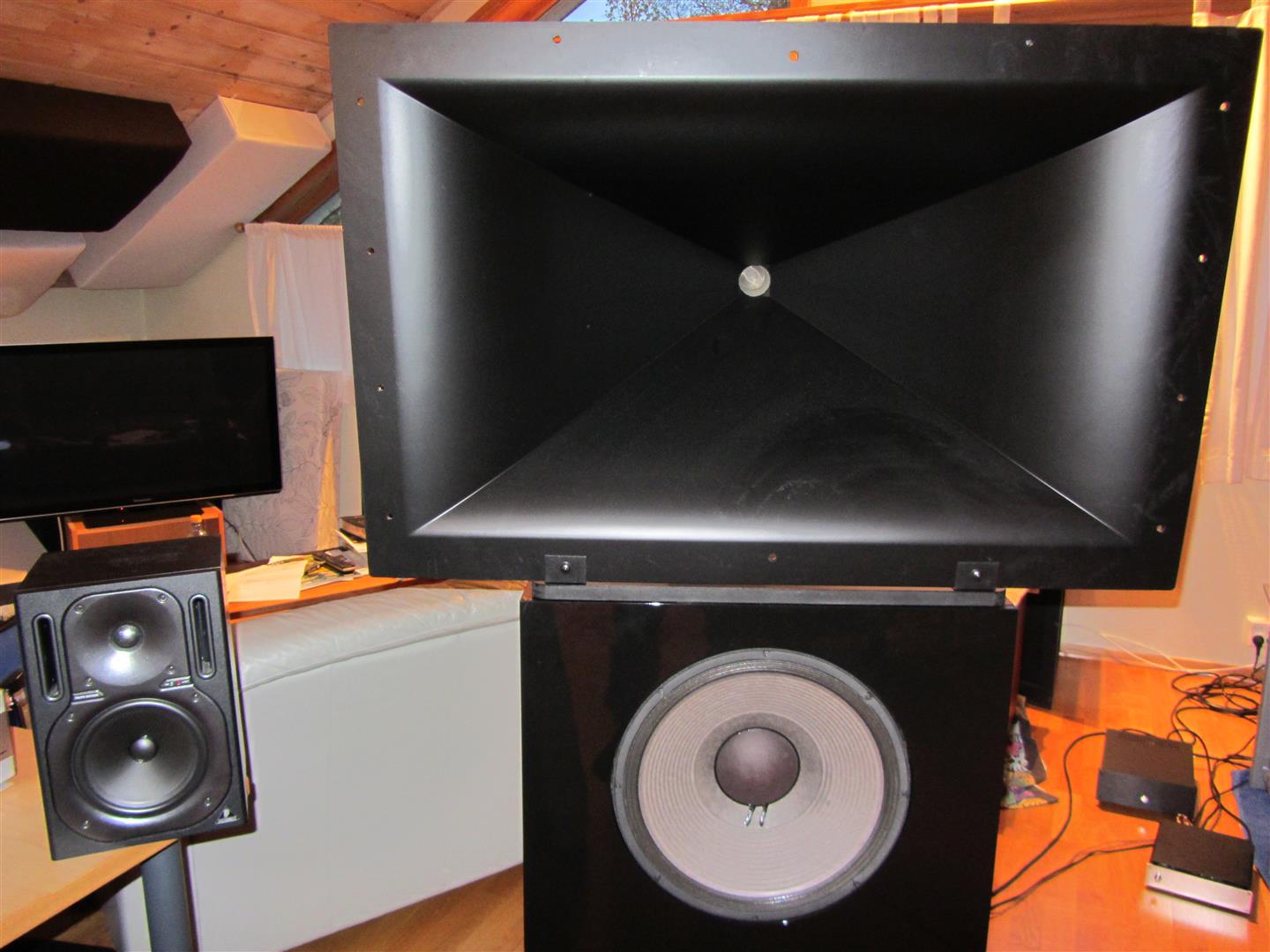

Though the Behringer might be better then Orion, it's still a speaker with huge compromises.So we should all get a $400 pair of B2031A's and put away our DIY stuff?
I would say there's more then a slight audible difference between my Behringer and K-402 horn with JBL 2226 below. But who knows, perhaps I want the more expensive speaker system to sound better to justify my money. So in reality it's only placebo and bias kicking in.
