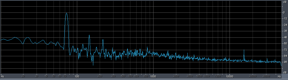

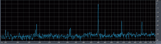

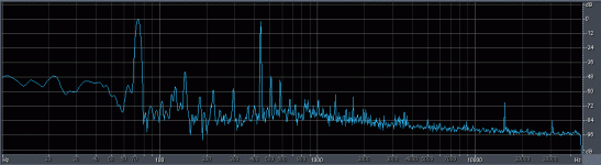

Here are results using very nice 5.24" mid-woofers. Two woofers are setup in separate enclosures, and placed for center to center distance of 12". 73Hz and 440Hz sine waves are used for testing. Microphone is placed equidistant from centers of each driver.
Response for each woofer to 73Hz signal looks like:

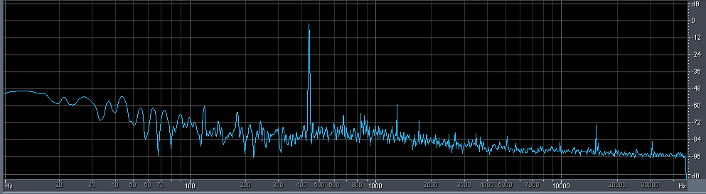

And response to 440Hz signal looks like:

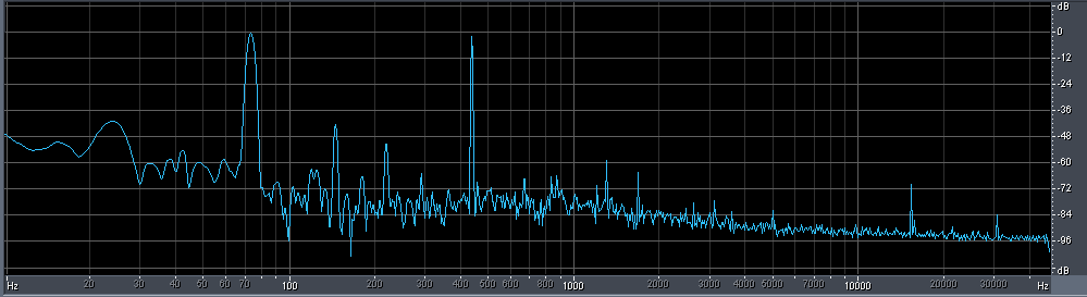

Response when one speaker has 73Hz signal, and other speaker has 440Hz signal:
No IMD is visible. The microphone circuit is not introducing any obvious IMD.

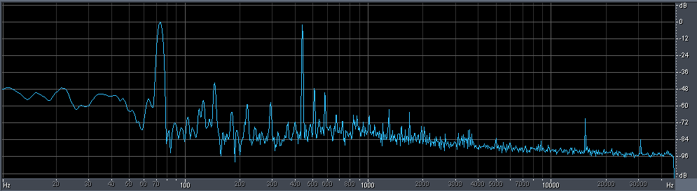

Here is response when single driver is fed two tone signal of 73Hz and 440Hz signal combined:
IMD components are clearly visible. In this test setup the difference is audible too.

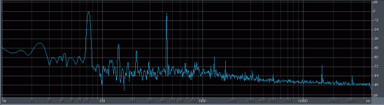

With bigger FFT, IMD difference components are resolved from HD components of 73Hz signal:
When 146Hz and 440Hz signals are combined, IMD is greatly reduced:
At these levels of IMD, I have great difficulty in reliably hearing the difference when 146Hz and 440Hz are reproduced through two different drivers and when they are reproduced by a single driver.
In typical application, this woofer can be used below 73Hz, but when driven hard audible sound quality decays.

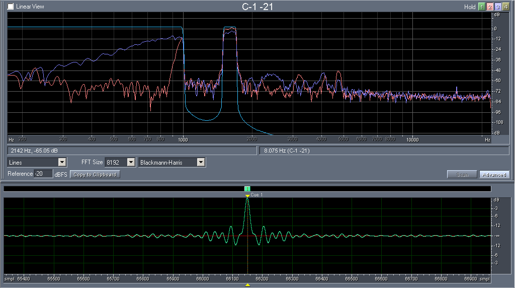

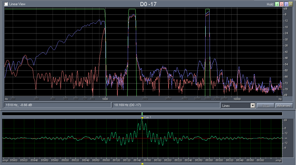

More food for thought. Here are results using 2" wide band driver. A broadband burst signal is used, depicted by white trace. Electronic 1kHz high pass filters of 24dB/oct and >100dB/oct are used:
When bandwidth is added to burst signal around 6kHz:
Clearly the path in speaker design is use of electronics in constraining driver bandwidth.
From last two pictures, it is also clear that what is passed off as noise floor, is floor of modulation distortion that rides order of magnitude above that seen with electronics tested with purely resistive loads.
Electronics capability far exceeds transducer performance, and advances in audio are dependent on understanding transducer behavior.
