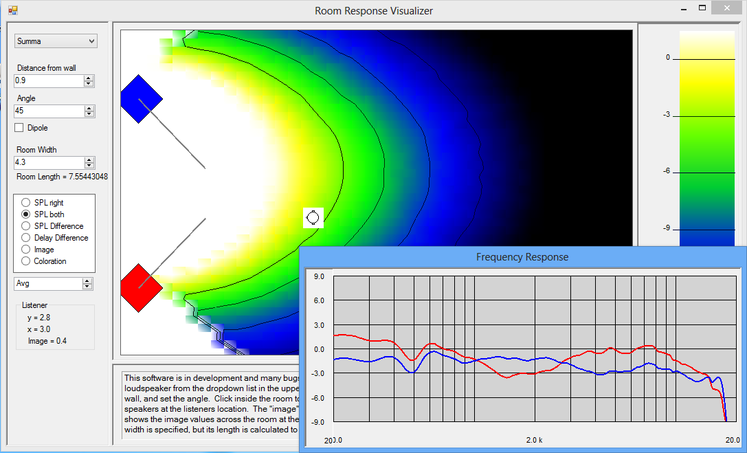

Thanks but where's the main listening position?
Centered laterally of course, about ten feet back from the speakers. At this distance the image is almost independent of the location on the sofa, about four feet wide.

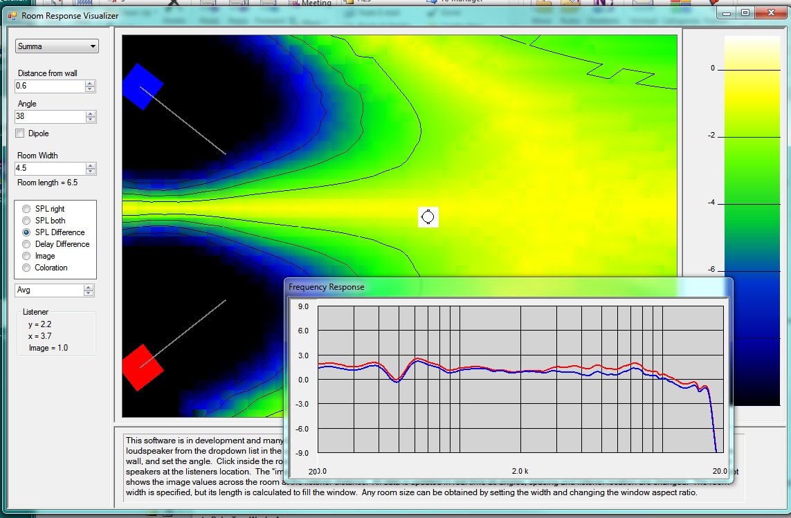

Then your contralateral reflection arrives a bit earlier and louder than in my room.
By the way, your setup doesn't look too good in your software:
So what, it is still lower in level and later in time than if the speakers were not toed-in. That's the point.Then your contralateral reflection arrives a bit earlier and louder than in my room.
Markus, why are your posts always so derogatory and biased? Show a better spot or better distance and better yet show some other speakers as well!! None of them are any good by your standards. You take the extreme worst and make it seem like it is the norm. I see why others get so frustrated with you. Your positions are seldom fair and balanced.
I don't think he could've stated what he felt was a fact with any less vitriol.So what, it is still lower in level and later in time than if the speakers were not toed-in. That's the point.
If you consider yourself to be a wise man then I think you should start ignoring trifles. Other people do it very well.

Is the dip in your response curve about 50hz the port tuning of your enclosure? Are you using any eq on this system?
I ignore other people very well, but I have so much respect for Markus that I get annoyed when he gets unreasonable. Markus is one of the most informed people here, but sometimes he just gets obstinate. But he knows all this.
Earl,
What speaker are you talking about? There could not be a dip at 50 Hz on any speaker that I know of because none of them go that low. I use no EQ on the passive systems, only the crossover. The active systems have a more complex crossover that one might call "EQ".
If you mean the dip at 500 Hz in the woofer, that is a resonance of the spider. All 15" woofers that I have tested have this same problem. Remember that the scale is only 3 dB per division. That makes even small aberrations look large.
