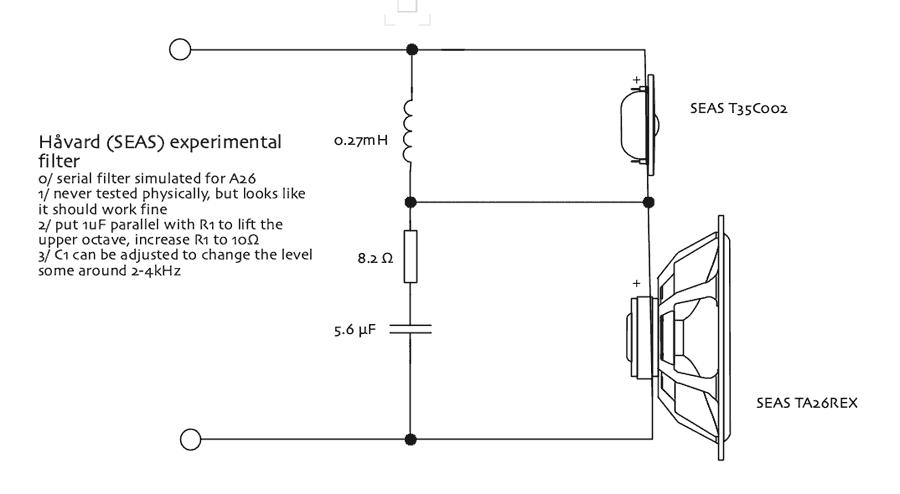

1---will current drive break anything due to fist order passive between low mid and hi mid?
2--will the frequency change to the point where the linkwitz design is messed with?
3---am I forgetting to consider anything relevant?
Asking because I have four channel current drive chip amp that would be great to use due to compact form factor and I already have it of course.

That is actually very bad idea. The frequency response of a driver powered from a "voltage drive" 0-Ohm output impedance source and a "current drive" source with very high output impedance will be very different. Using your current drive amplifier will mess with the frequency response of the loudspeaker in a bad way.
I use current source and voltage source amplifiers interchangeably with 2-ways with a first order series crossover. They sound different but nothing has broken.
A variation on the A26 design. That looks like it might work pretty well.
The series crossover creates a nearly flat impedance load. That's why it works okay with an amplifier with high output impedance.

Just interested what kind of an amp you have? Is it diy your design?
Given that the Linkwitz is multi-amped.
Theren should be no issues as long as thedrivers are used in the flattish region of their impedance characteristic, but an OB does nothing to quell the resoance peak which will show up as a FR peak on the low bass.
New EQ would be required, but often the mostb common fix is to use a voltage amp on the bottom and current amps for higher up.
dave
Reactions: TBTL
Even with equalization, I would not use current drive for the woofers, because changes in temperature or drive level could shift their impedance peak. The corresponding peak in the frequency response then also shifts. The equalization to counter that peak does not shift and will be wrong.
