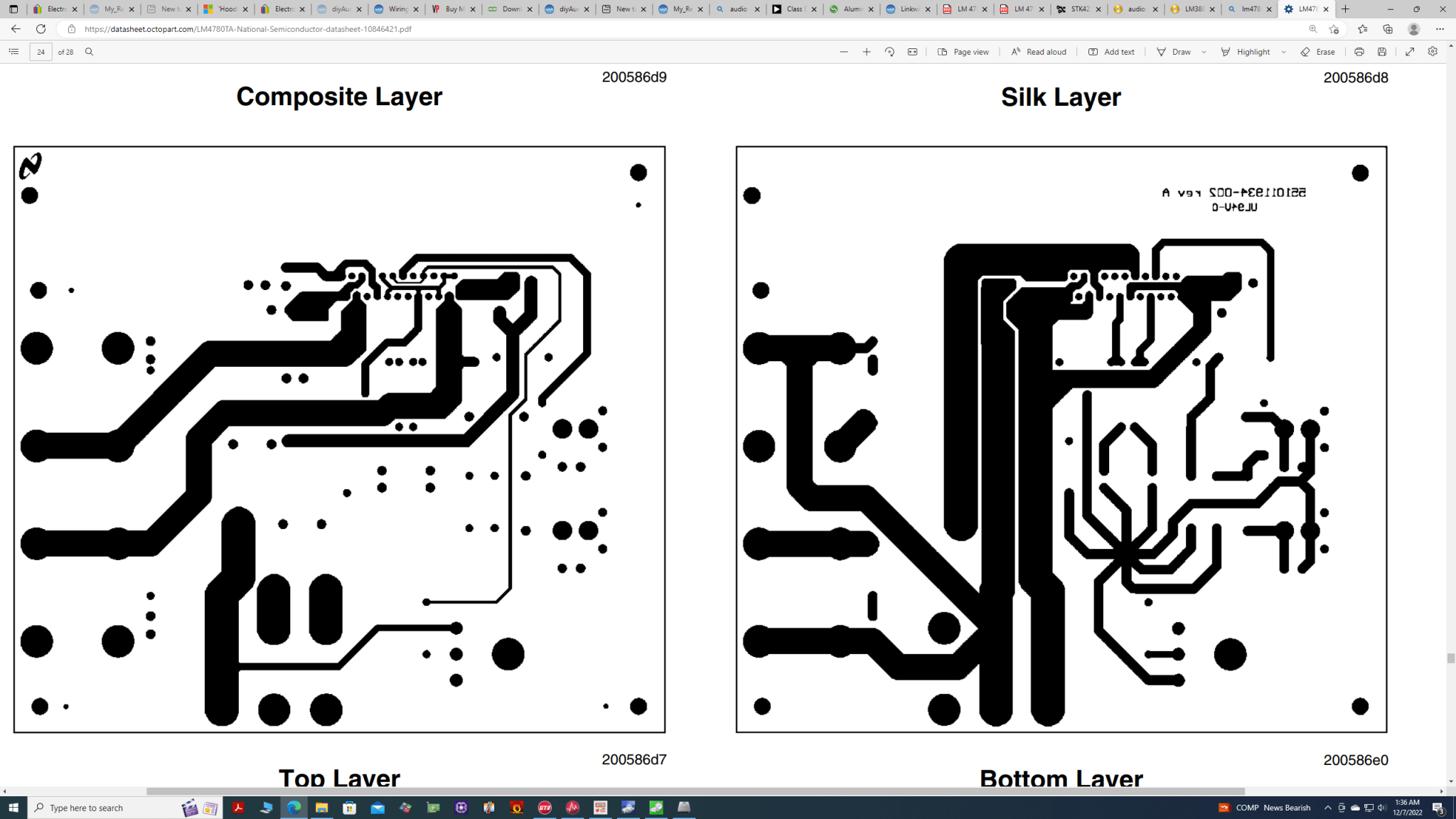

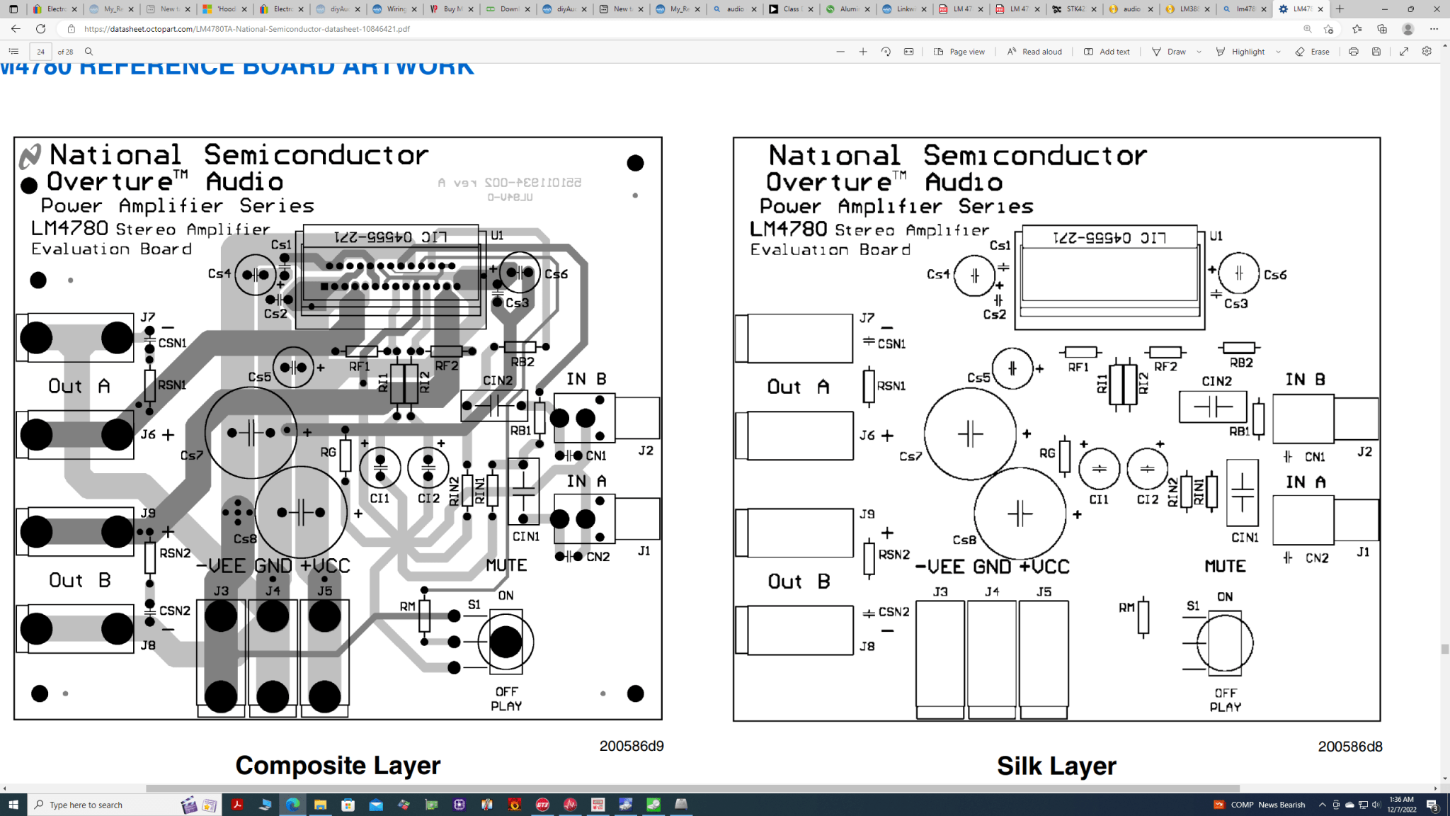

take a look at the National lm4780 stereo amplifier artwork .
Some pins are are NC(not connected ) but they are not connected internally and they are soldered on the board.
Do you have the boards to build the lm4780 pa03 amp?

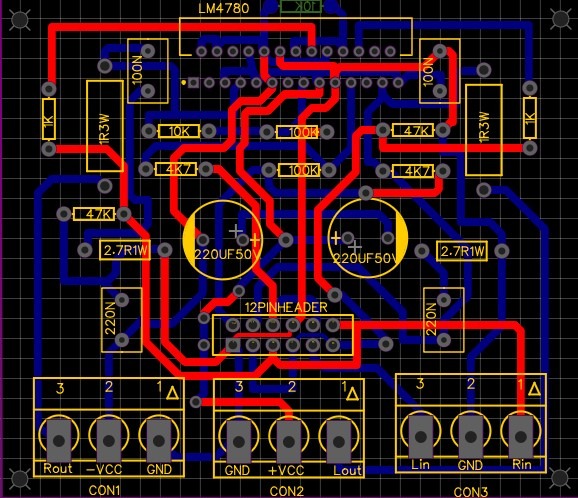

No doubt the data sheet is exactly as per what you have highlighted. Please check out the attached audiophile implementation of LM4780 and here the NC pins are connected. I wanted some info if there are any advantages in connecting these pins. As for the boards I have picked up a circuit from the net that supports 3 mode Stereo, Bridged and Parallel via few jumper settings using a 12 pin header. I am attaching the same. Have not ordered the PCB yet. For anyone interested in working on this design kindly note, I am not a professional PCB designer and hence mistakes are bound to be there and hence please do not use this design to build or order unless you are sure.
