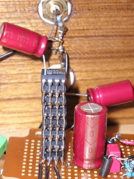

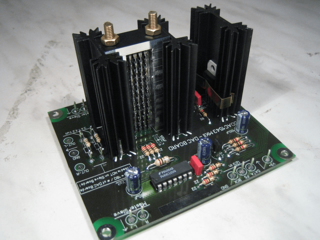

I thought it was simply a matter of piggybacking the chips. I saw somewhere someone selling a modular vertical stack of DAC chips but I can't find it anymore. The closest was this
Ah - that looks like it might be a stack of TDA1543 (dual in line package). Those chips do get seriously hot when stacked and run at maximum supply (around 8V if I remember right). I have tried stacking TDA1387 but being as its SMD, the legs aren't quite long enough to reach between chips. So I have tended to fill the gap between with solder - it works but has never been super-reliable. To get more reliability, I've soldered 30AWG wires between chips, its hard to get the result looking neat though and its jolly fiddly.

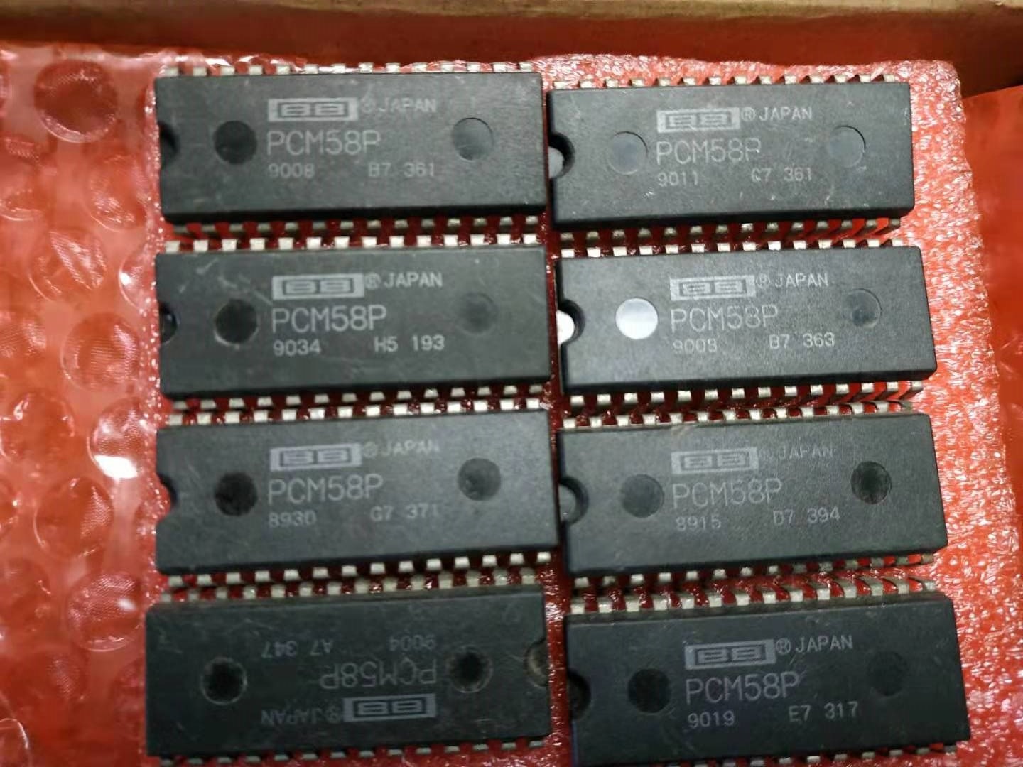

P.S. on the topic of lower noise chips, on paper these PCM58s which arrived yesterday look very good :
The heat isn't really concentrated - sure the chips are warm but given there's quite a lot of copper in the PCB (its 4 layer) the spreading effect evens out the heat quite nicely. Just doesn't disperse it far enough. Could be just a metal plate on the back of each PCB extending beyond the edges will do enough, as you seem to suggest.
I've now made some measurements - the hottest spot I've been able to find with my thermocouple has been 62degrees C, this in an ambient of about 23degrees. Which is probably just about OK sat on my bench but inside a box the ambient will easily become 20oC higher...
http://www.dddac.com/sales_1543.html

Yep thats the one. But did you see the 120 chip version?
