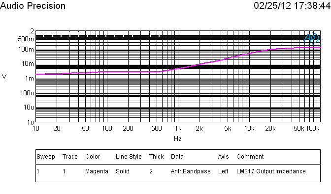

Thanks, jackinnj. Do you have any recommendation on value of the capacitor. I have used 100nF film cap as in datasheet but I don't have any instrument to measure noise. As you mention electrolytic I would guess the value would be much larger than 100nF. How about low ESR electrolytic?
I ran this in LTSpice with a 500k resistor as RSet
Thank you, I will try an electrolytic cap to bypass the Set pin at some point.
