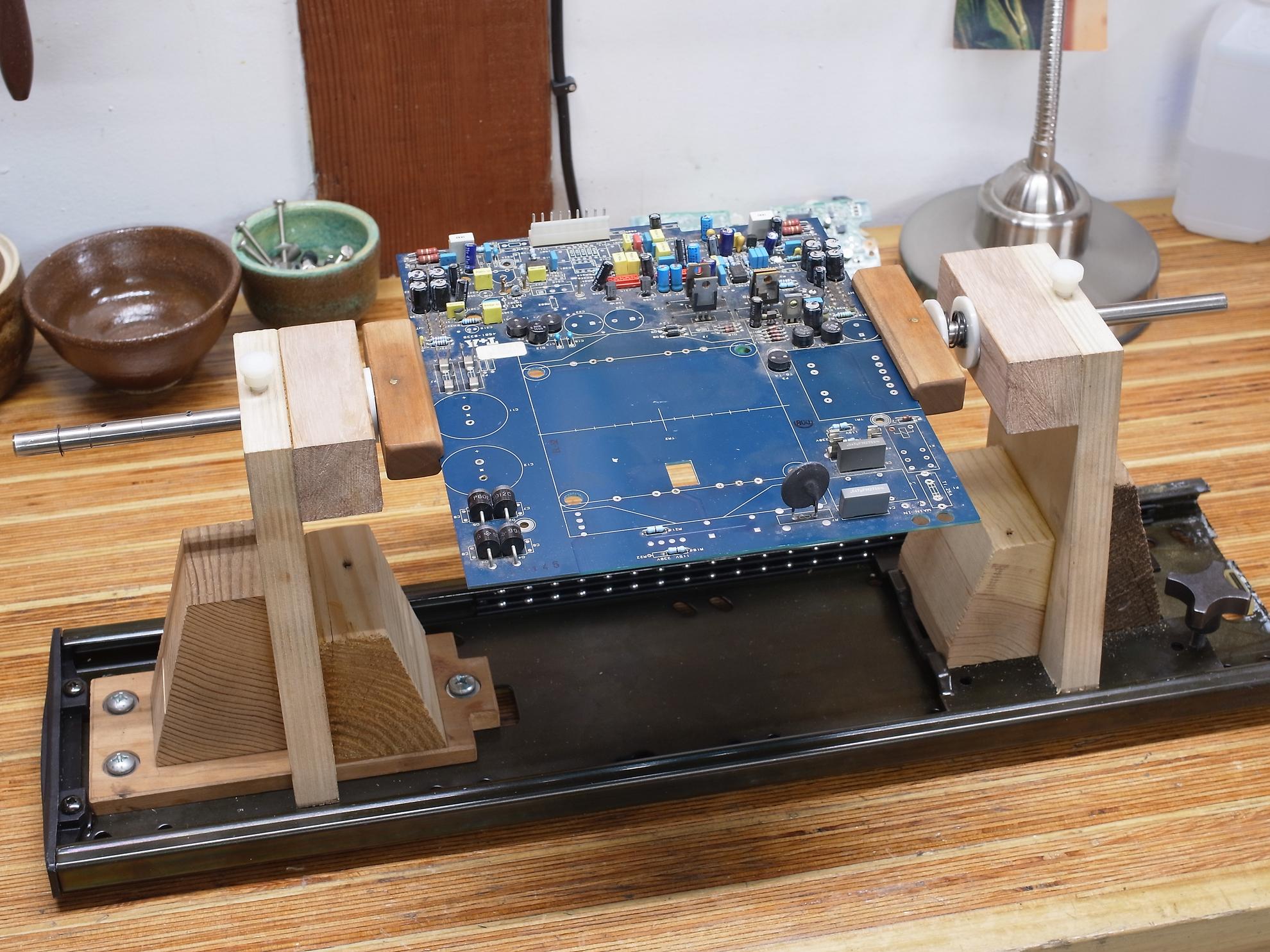

On a side note: I build a PCB board holder today, came out pretty nice, no wobbling, everything sits tight, up to 9" in width. All made from recycled parts (old printer, keyboard mount, wood).
I'll keep you posted!

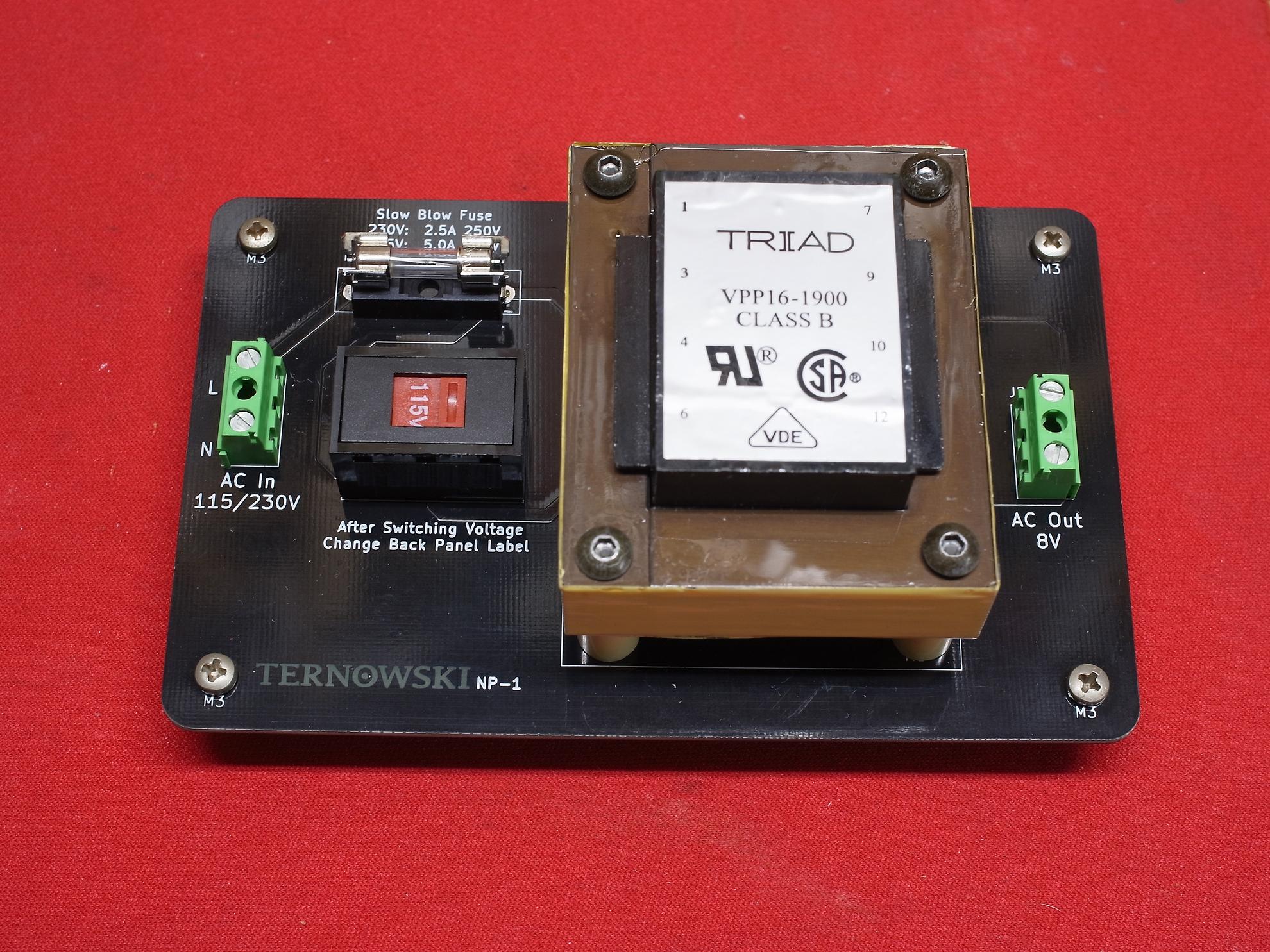

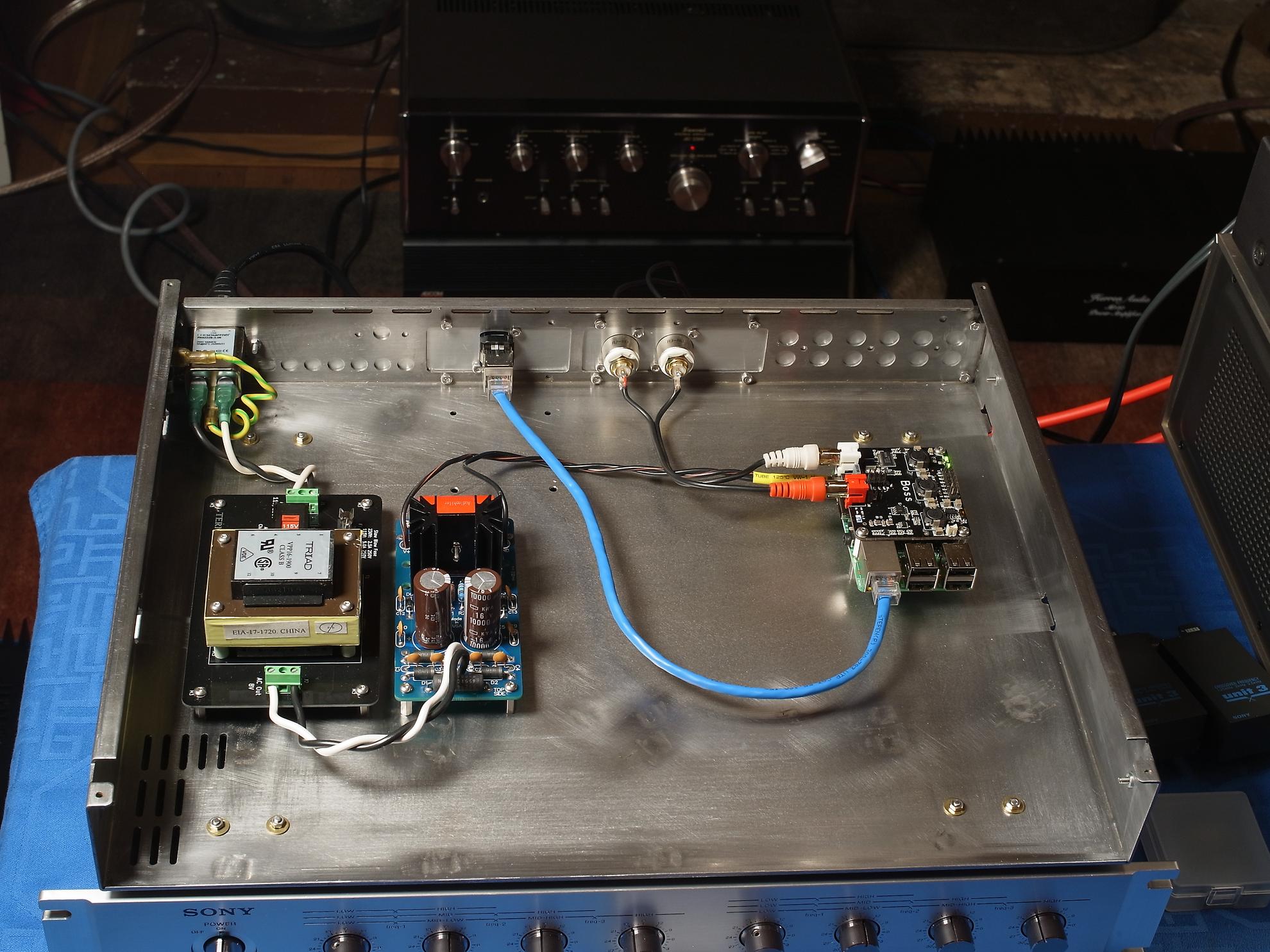

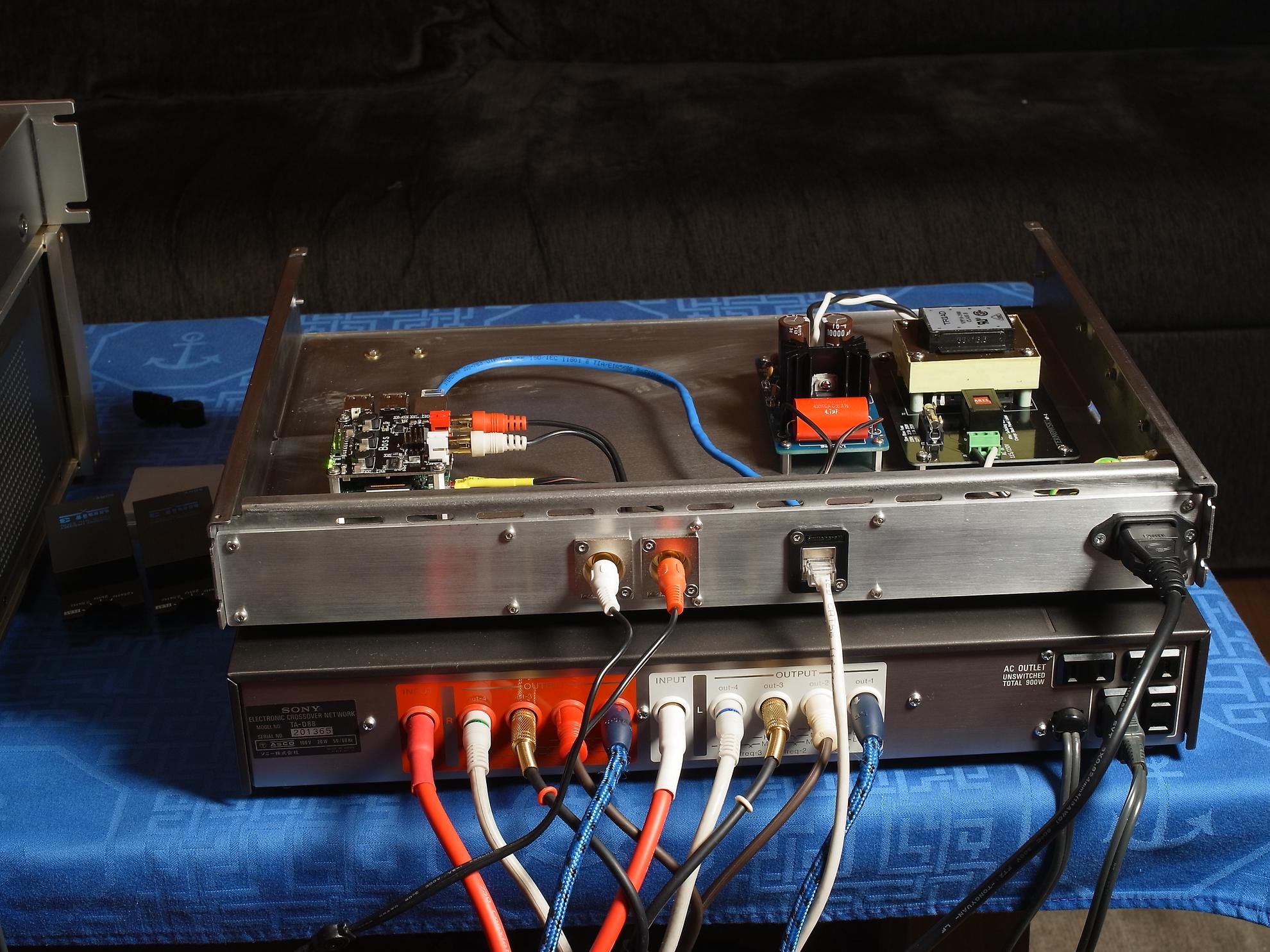

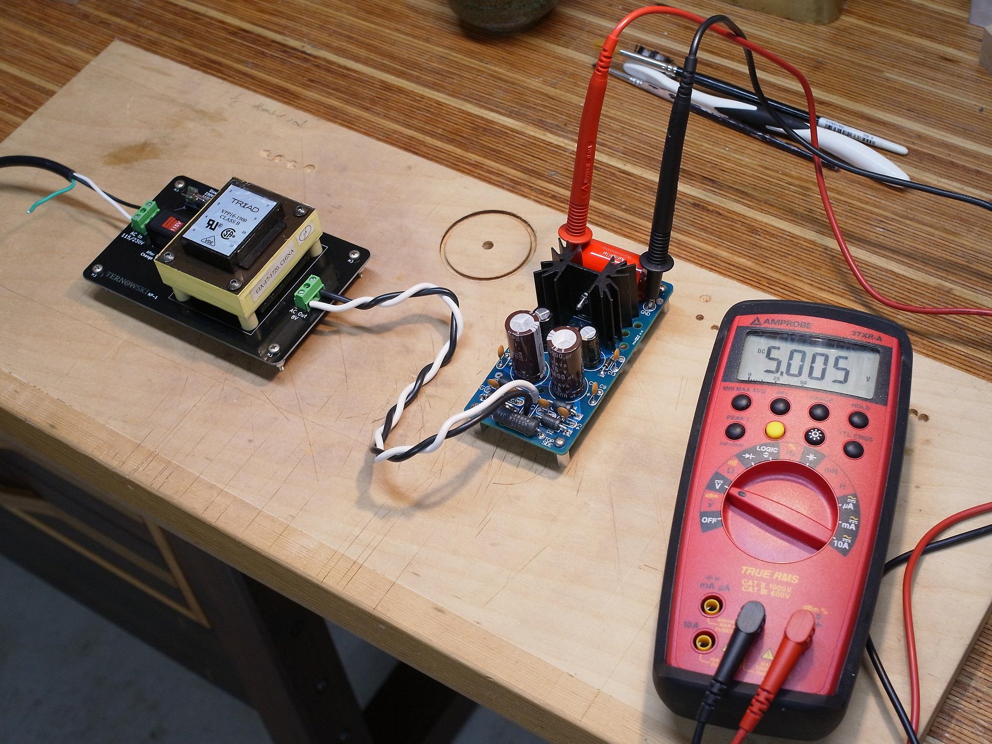

A little update...
I got the PCB board (from PCBWay) and all parts, soldered it together. Also got the LV Regulator and put it together. Everything went pretty flawlessly. Just tested the PSU today with the multimeter, and I am getting 5.005V DC. Looks like it worked out!
Next step will be to put this all into a case and connect the raspberry pi. I want to run it and check the temperature of the regulator/heat-sink, to make sure it is not running too hot.
For now I will just use an old pre-amp case that I have. It's the same size as the Sony Pre-Esprit components, so maybe I will end up just changing the front panel, if that works out somehow... we'll see.
Attached a couple of pictures.
P.S.: I have two extra "transformer" boards. If anyone is interested, I could provide these. The same parts would obviously have to be used, all available from Digikey.
