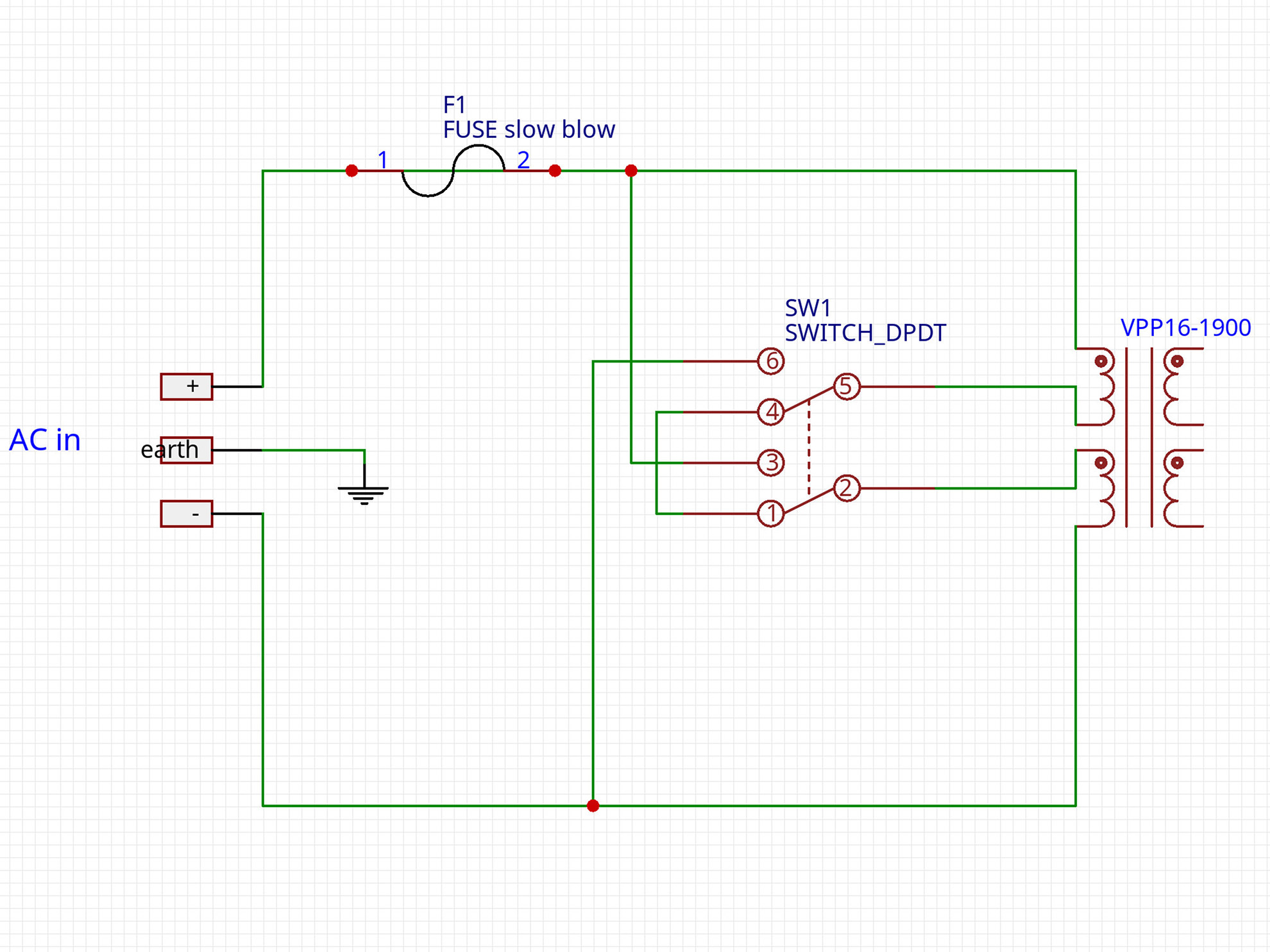

Attached is the schematic I have so far. Please bear in mind, this is the first schematic I ever created...

To be clear, you can use either full-wave-bridge mode, OR full-wave-centre-tap mode, but each requires a different wiring configuration of your transformer outputs. I suggest full-wave-bridge mode.

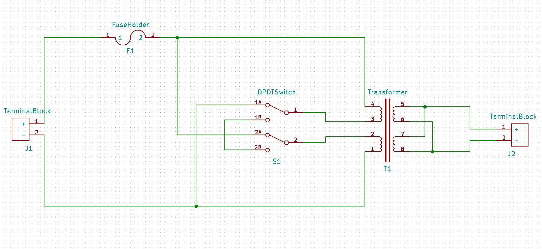

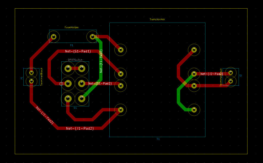

I have completed the schematic and the PCB layout now, and am just very curious of how bad (or good?) my first PCB layout is.
Attached screenshots of schematic and layout. This is basically a PCB for an AC to AC circuit, with a fuse, a voltage switch (115/230), a transformer and a screw terminal at each end. Missing are the mounting holes and some informative silk screen text...
Trace width is 2mm, which I understand is a good idea for higher voltages(?).
What I don't really understand is, whether I need to worry about ground planes. As far as I understand, this is important for low level circuits, but not for this circuit, which is really all AC. Could someone shed some light on this for me?

Looks good to me, with one reservation - I prefer to see the mains fuse as close as possible to the point of entry into the enclosure. So if the input side of your transformer board is mounted very close to the chassis AC entry point, that's acceptable, but if the cable length is to be anything more than a few centimetres then I think the mains fuse should not be on the board at all, but mounted to an appropriate point on the chassis.
You could, and possibly should, also add a 2nd fuse between the transformer secondary and regulator - 4A would be good. I see that the GlassWare LV-Regulator does not include a fuse at its input, so you should probably add such a fuse at the output side of your transformer board.

The board will be right behind the IEC inlet, my intention is to put it as close as possible.
Putting a fuse on the output side is a good idea. So that would go where the "+" is, right? Just confirming. Is there really a + and - in an AC circuit?! It's confusing me a bit...
By the way, the PCB layout is wrong... it's not quite obvious, but in KiCad the traces on the front layer are red, on the bottom green. I have all my traces on the front side of the board, where the components are mounted. As far as I know, with through-hole components, the majority of traces should be on the bottom. I studied a old (1998 or so) 2-layer amplifier board a bit... that's how it was done there, too.).
It also occurred to me, that I should really have all the parts ready before ordering the PCB... so that I can print out the board and place the components onto it, to see if everything fits. Oh well, it's my first time... a lot to learn...
Still need to mark the mounting holes and find some stand-offs, otherwise I think I got all the parts figured out.
Your incoming mains AC needs to be fused on the active line, which I see on your schematic is marked as "+".
This fuse is for safety ie. not electrocuting yourself, and not burning down your house.
At the transformer secondaries you can connect a fuse to either of the 2 output connections.
This fuse is to protect the equipment which your transformer connects to ie. it's easier to replace a fuse than to replace a fried regulator, or worse, downstream.
Yes, of course, makes sense... on the mains side there is an active and a neutral line, and earth which will go to the chassis.

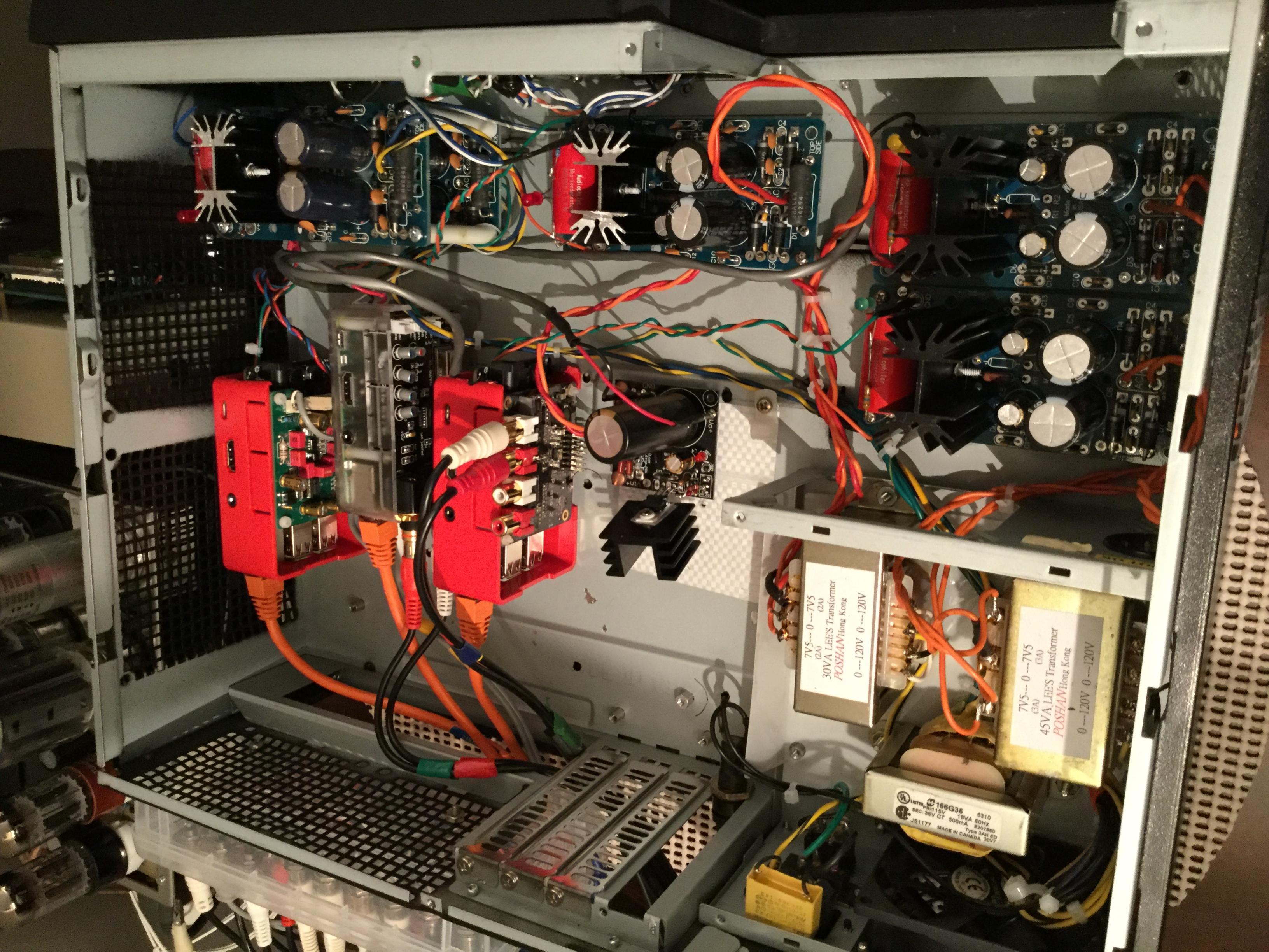

Here are some thoughts for your design consideration.
The Allo Boss has power pins to allow you to separately power it from the RPi. This will require another 5V regulator board should you choose to examine/test this configuration. Accordingly you will then have to re-lay your PCB for separate secondary windings instead of paralleling them to get two 8VAC outputs for your regulator. Lay it out so that the windings can be paralleled by a jumper on the board.
You can hard wire/solder power leads to the Rpi and the Allo Boss instead of using connectors/plugs. Use 22 or 24 ga wire.
I have some audio cable, 2 conductor shielded, 3.5mm black which I can send you for your build. It is new on a roll and I can take off 10ft. and send it to you. Send me a PM with your address.
The picture is of my RPi /HAT/DAC test platform where I have an Allo Piano 2.1 DAC with Reclocker, a ESS DAC with Kali Reclocker, and a Dial DAC all with their individual Glassware power supplies in a re purposed desktop PC case. I do not have any interference or cross talk between the units even with the different power wiring schemes.

I agree with ktham; your project is currently so extensive that it would be a shame not to go just a bit further and accommodate a second 5V supply for the DAC-hat.
The DAC-hat deserves a high quality, low noise, such as the LT3042, ADM7150, or TPS7A4700 ...
but I see the BOSS DAC's onboard regulators are LT3042 - OK, in that case I would exclude LT3042 from your choice of pre-regulators, because by combining two different regulator types your get to reduce two different noise bandwidths.
ADM7150 and TPS7A4700 regulator kits can be found at diyinhk. You could also try eBay and AliExpress, with some price versus quality considerations.
Regarding the transformer, sure, you could split your Triad's secondaries to supply two regulators, but it seems to me that you have plenty of space in your enclosure, so I would use a second (smaller) transformer for the DAC-hat. Something like this Hammond -
