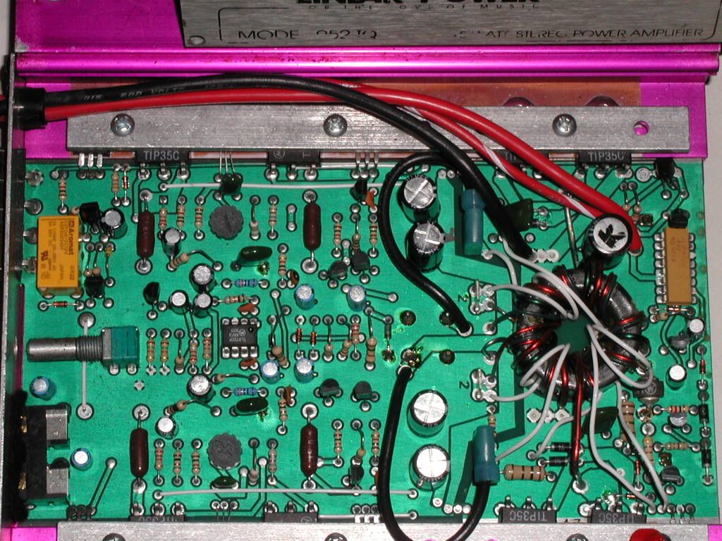

ca90ss if you could post some pics of the thermal protection on your amps that would help. Or you can email them to me. My email is woodworker507@bellsouth .net. Thanks for the reply.
Here is one of my 652's sorry about the poor picture quality, I really need a new camera

Thanks for the pic ca90ss. I think I have the thermal connected in the right place. Now I need to find what the proper power transistors are.
TIP 35 and TIP 36 are the outputs for this amp. You can probably get away with using TIP36's in the power supply also IMO. < for durability reasons only>

I have an old Linear Power 952 that needs the power supply repaired, however the parts are burnt so badly i cant tell what they once were.
Have looked at the pictures posted here but are not clear enough (laptop), the part is the smaller transistor (to220) looks like 2n6488 ???? , the larger ones are tip35 or 36's any help , schematics would be greatly appreciated. Also i have seen Perry had a picture of a 2502iq , it seems it has same problems, however someone had removed Q5 and the cap beside it , as well (from pic looks like 220uf,16v ?) .
nice pics tom , and thanks that clears up the main power supply main transistors (TIP35c in their TO-218 cases) but need the TO- 220 part number beside the white xformer wires.
