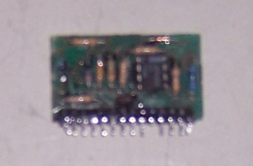

I got some pics of it I believe, but they are not high resolution. I remember seen a 2502IQ or it could of been a 2.2hv for sale recently on diyma that had that board exposed and it wasn't covered with epoxy either...really wanted to buy it just because of that lol.
I think I found a naked one.

Yeah but the resolution on the pic posted is very bad., take some clear high resolution pics...both sides are needed. I use a 10x magnifier with LED to take close up pics with my cell camera, you'd be surprised on how clear they come out (cell camera is 5megapixel).

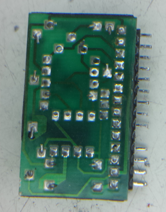

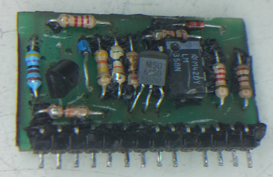

This is a good suggestion - I got a better camera and followed your instructions -
