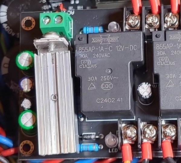

Linear IC Voltage regulators too hot to touch on both amp and preamp
I would use a chassis mounted heat sink, and 1.5 square mm wires to PCB, observing insulation precautions.
And if it is a wall wart, then change to one with a lower output voltage.
If it is inside the unit, a 10 Ohm 10 Watt series resistor on mains side will reduce the input volts to transformer, that is a common problem nowadays with higher mains volts.
Whacked out alternate is a wideband (90-270V) laptop power supply....that works very well, put some small caps in parallel to reduce noise...4.7 /47 / 470 uF 50 or 63V, between + & - rails.
That takes care of higher mains volts, and many people have a spare supply for an old laptop, which is not in use.

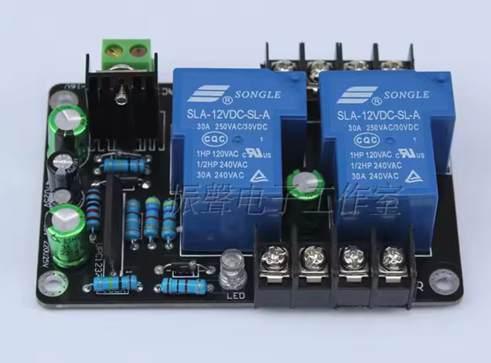

Its is often the same problem with the chinese boards....there is no heatsink or it is to small. The heatsink is not isolated to the component, never using thermal paste...
The LM 7812 on this speaker protection was to hot, because the heatsink was too small. Too small for a difference of 4 volts and few mA.
I had low space to the top plate of the case, i had to choose this way....now everything is fine...

To wrap up this thread, (thanks again for all suggestions!) I ended up "keeping it simple" and going with mechanical fix attempt. Bought a bag of these aluminum clip-on heat sinks from the bay, and they are soft enough I could bend the fins to fit. I should probably add some heat conducting grease where the two sinks mate.
Now I can hold my finger to the fins for 10 seconds at least before it becomes too uncomfortable and I have been running the amp pretty much 10 hrs per day with no problems. Sounding great fed with a class A Centrance USB dac/preamp.

The 7812 seems to be used for a loudspeaker protection circuit and/or relays. Anyway the main cause is a too small heatsink in the amplifier and no heatsink at all in the C3850 clone (an error that has been corrected in recent versions). Requires just 2 normal sized U shaped TO220 heatsinks and 2 very tiny dots of thermal grease to solve adequately by a layman.
