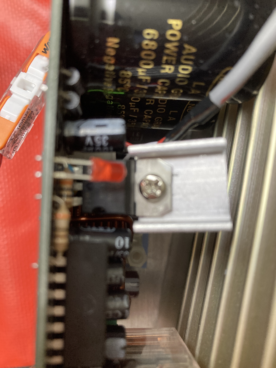

The LM 7812 on this speaker protection was to hot, because the heatsink was too small. Too small for a difference of 4 volts and few mA.
I had low space to the top plate of the case, i had to choose this way....now everything is fine...

A linear regulator almost has to have a heatsink. If I remember right a TO-220 theta J-air with no heatsink is around 40 degrees C/W. Most linears want a minimum of 2V drop. So just 1/2A draw thru it is 1W using the minimum input voltage, which you really can't. You have to have some slop for line voltage variation and high loads causing droop on the input voltage caps. So for a 12V regulator you want 15-16V typical in. And you have to do the thermal design for worst case, so maybe even 17V if the AC line is high. 16V gives a 4V drop and at 1/2A draw that is 2W the regulator is dissipating. So 2x40W/C is 80C temp rise and if ambient is 25, which is very optimistic in an enclosure, you're over 100C. About the only time I don't heatsink a regulator is if I know we are talking 100ma or less draw.

To wrap up this thread, (thanks again for all suggestions!) I ended up "keeping it simple" and going with mechanical fix attempt. Bought a bag of these aluminum clip-on heat sinks from the bay, and they are soft enough I could bend the fins to fit. I should probably add some heat conducting grease where the two sinks mate.
Now I can hold my finger to the fins for 10 seconds at least before it becomes too uncomfortable and I have been running the amp pretty much 10 hrs per day with no problems. Sounding great fed with a class A Centrance USB dac/preamp.

Alright, but the aluminium should be at the back (where the silicon die is) of the IC. 10sec test is a good observation, now leave it as it is.
With unmachined mating surfaces, and only one mounting bolt, his arrangement is about as good as he can do
with that package, at least after he adds the thermal grease.
I would have done it little differently. A 'T' like piece of SMPS heatsink or thick aluminium & some thermal grease. But he did it well.

A larger heatsink touching the back of the regulator (with some heat conducting grease) would be better and more reliable as it is bolted. It is all about enlargening the surface. I don't like the thought of a clip on heatsink coming off in energized state.
If that aluminium surface right on the picture is the upper cover it sure needs some ventilation slots/holes as the heat should be given to the environment and not stay in a closed casing. This together with ventilations slots/holes in the bottom for fresh air. It is quite simple really. If we would know actual numbers it would not surprise that the dissipated power is not much at all. The heat just stays where it should not be.

The 7812 seems to be used for a loudspeaker protection circuit and/or relays. Anyway the main cause is a too small heatsink in the amplifier and no heatsink at all in the C3850 clone (an error that has been corrected in recent versions). Requires just 2 normal sized U shaped TO220 heatsinks and 2 very tiny dots of thermal grease to solve adequately by a layman.
