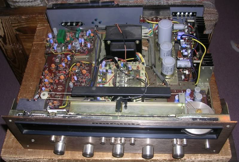

I am looking for an URL, where are listed all vintage stereo AM/FM receiver so as vintage integrated amps/power amps, which have no DC coupled (resp. no direct coupled) loudspeaker outputs (i. e. a serial capacitor between output and speaker terminal).
Serial capacitors are in use more like in older models, the newer ones have often been changed to symmetrical voltage suooly and direct coupled speaker output. An example is the Marantz 2230 (AC coupled output) and its successor 2230B with DC output (see attachment)

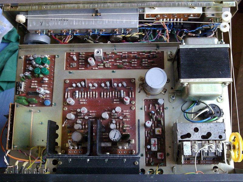

Pioneer, Kenwood, Sansui and much others really should also have such devices built. The SX300 is an additional example - have a look to the pics from
http://www.hifi-forum.de/viewthread-84-11738.html

in the attachment you will find another example from the Marantz 1060

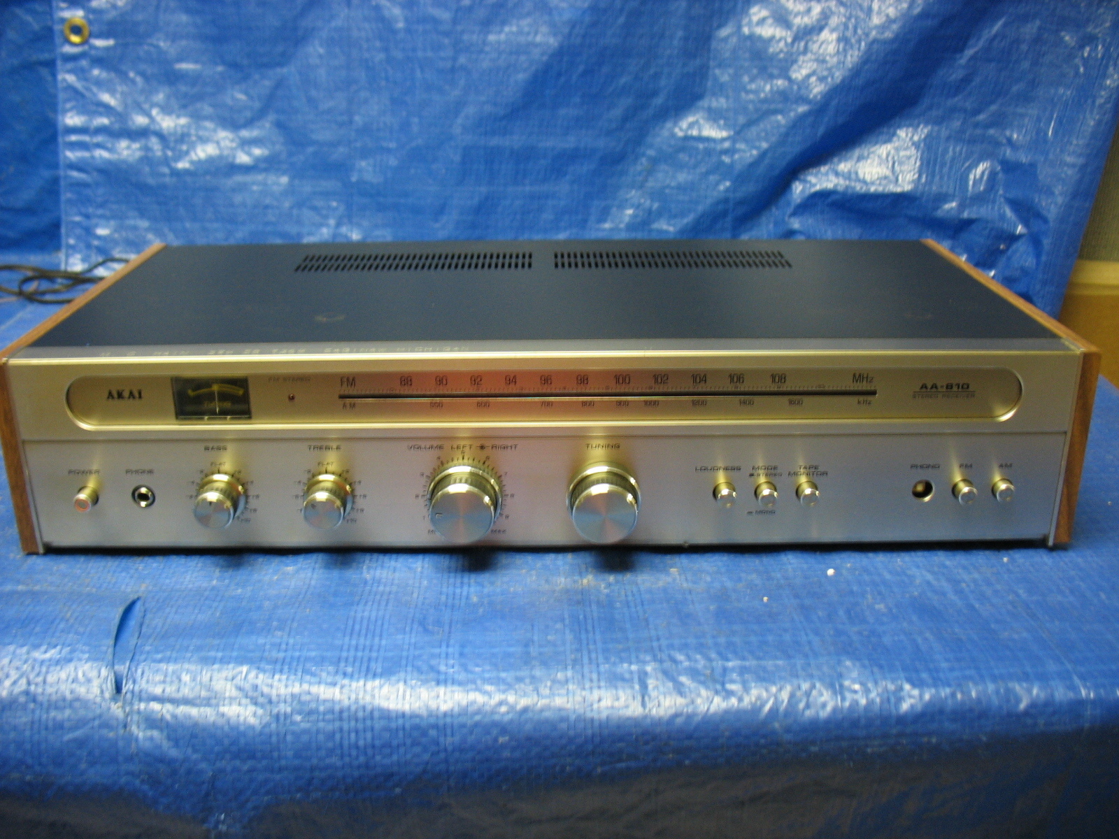

thank you.Akai AA810, most if not all Luxor stereos, Luma.

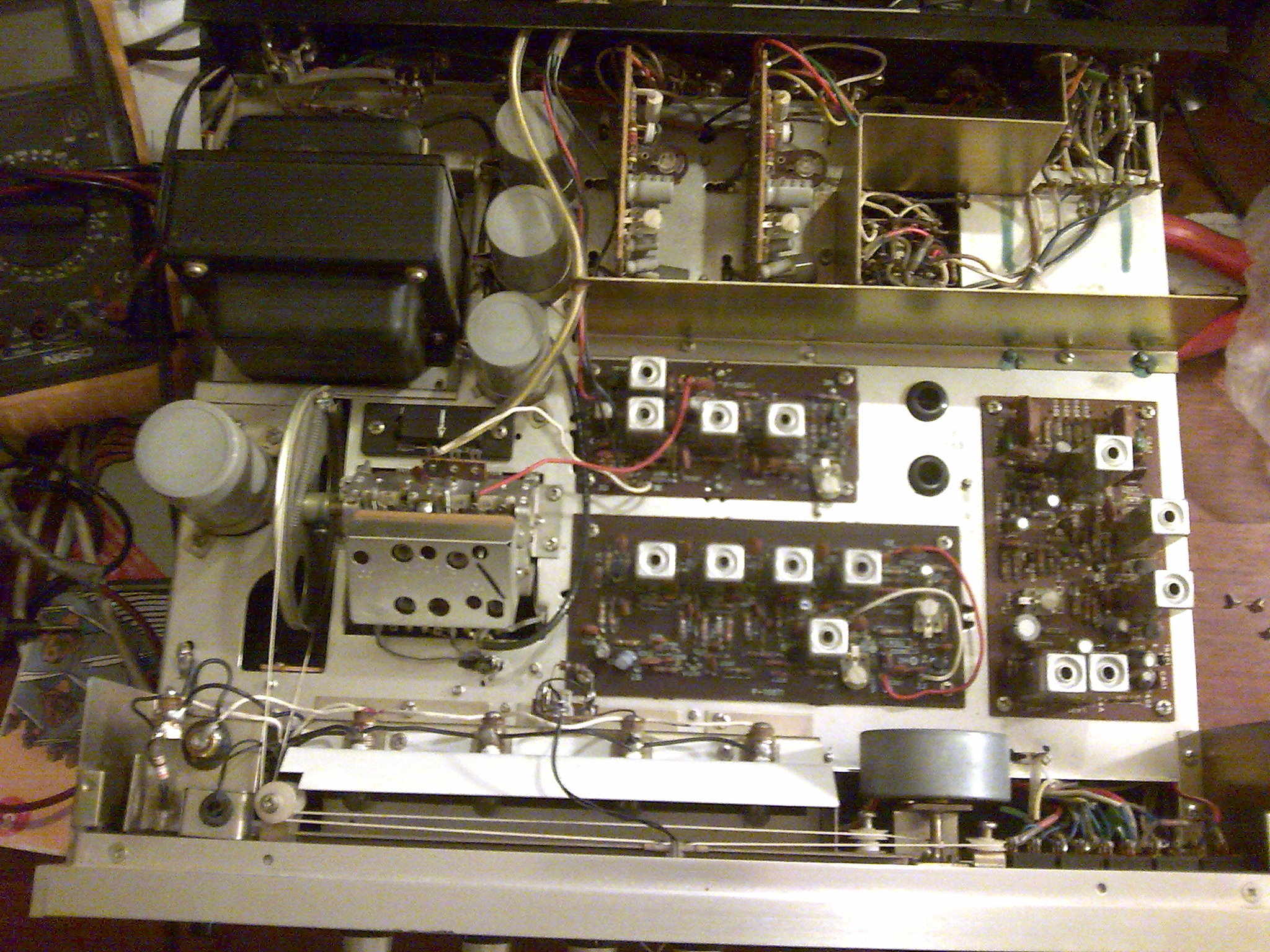

Many of the old Marantz 22XXb models used output capacitors and were some fine sounding amps. Example being 2215b. Marantz 2215B | Owners Manual, Service Manual, Schematics, Free Download | HiFi Engine

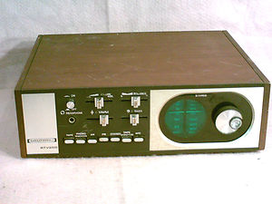

I have save some images from "hard to find" Grundig' RTV250 from already deleted auction URLs (found by google image search).
The Grundig RTV350 was those device, where I have first time listening stereo sound (a radio play by a German radio station - NDR if I recall right in the year 1967). It was very interesting to hear, as a train from left to right drove past.

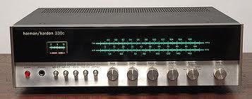

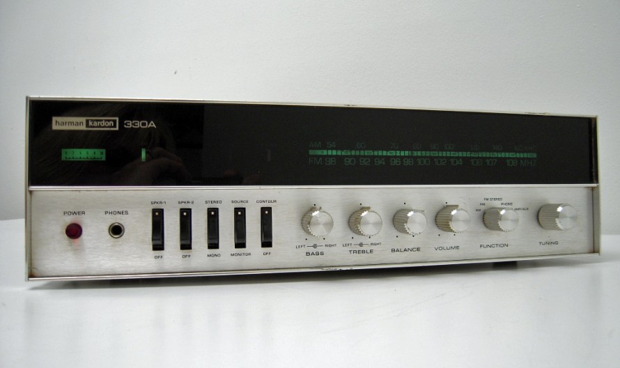

Harman-Kardon 330A, 330B
Harman-Kardon 330A, 330B (and not speaker DC coupled 330C)

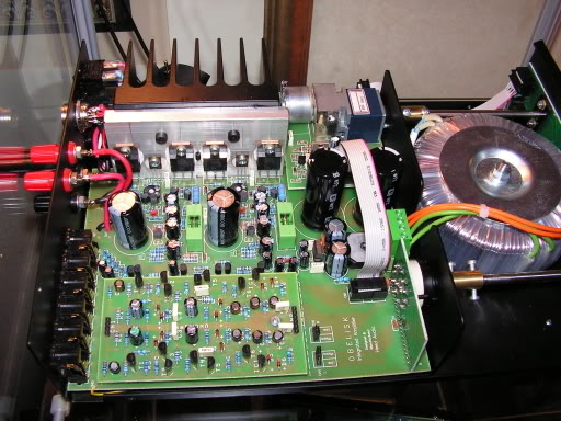

Heed Integrated Amplifier "Obelisk" series (Nytech, ION)
http://www.diyaudio.com/forums/solid-state/128128-nytech-ca252-woes-5.html
http://www.diyaudio.com/forums/solid-state/34985-ion-obelisk.html

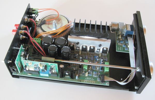

also without DC coupling at the output - Heed-Audio model Obelisk-SI with outdoor power supply:
http://heedaudio.hu/en/products/obelisk-line/si
http://www.fairaudio.de/leserberichte/2011/heed-obelisk-si-vollverstaerker-x2-netzteil-1.html
