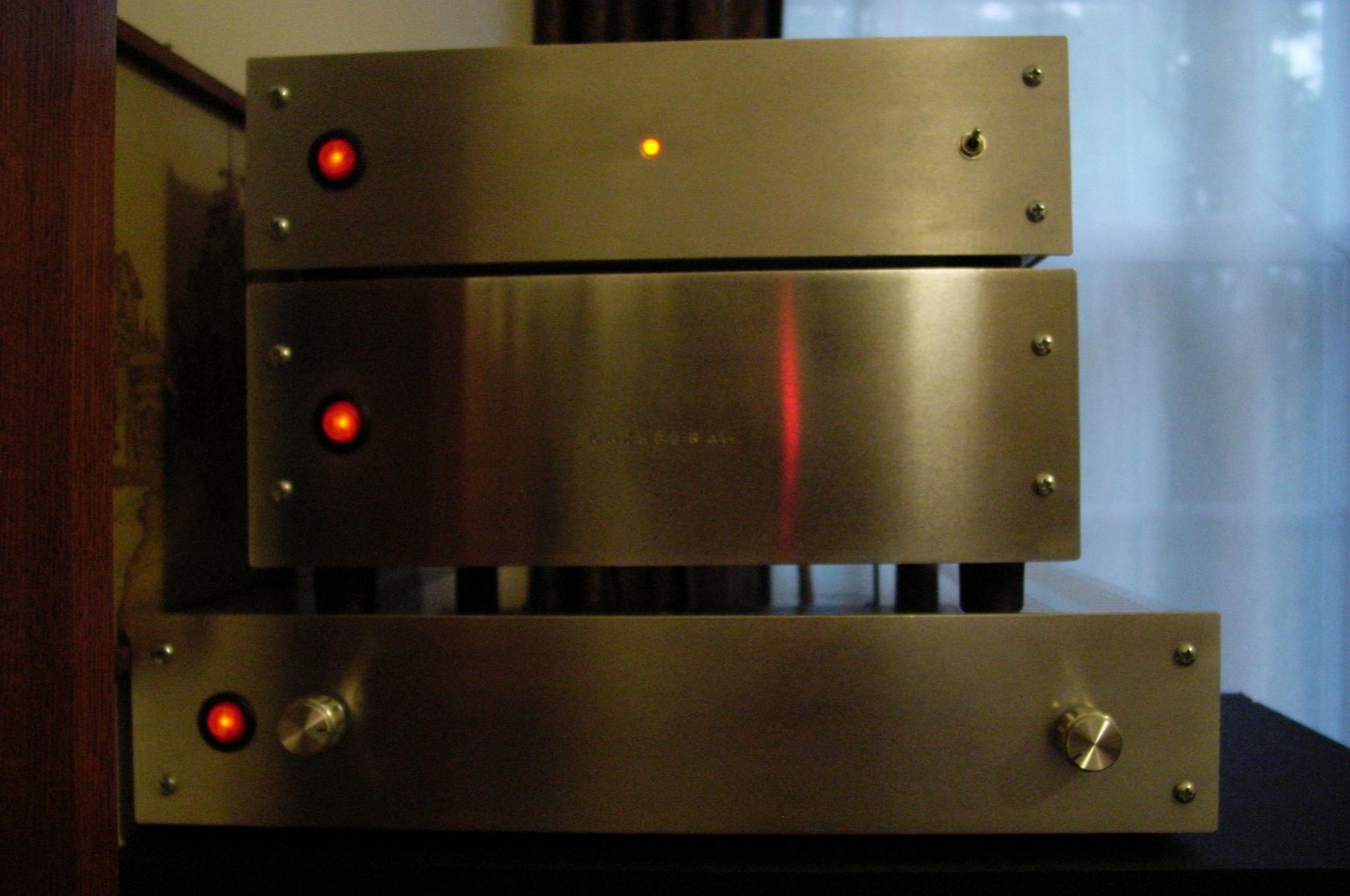

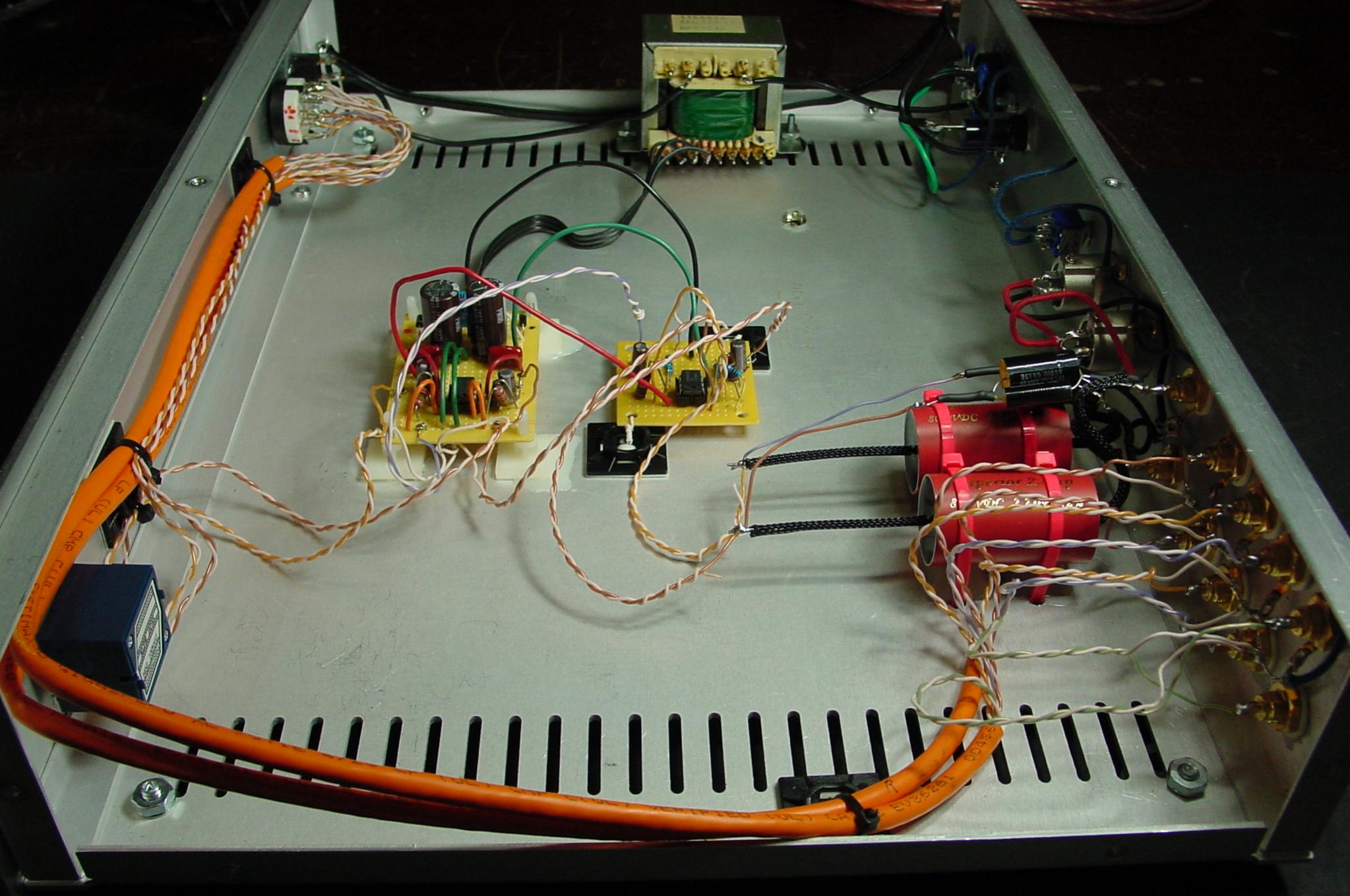

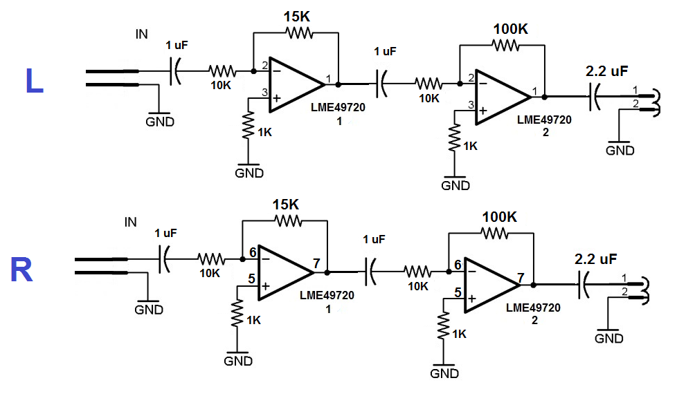

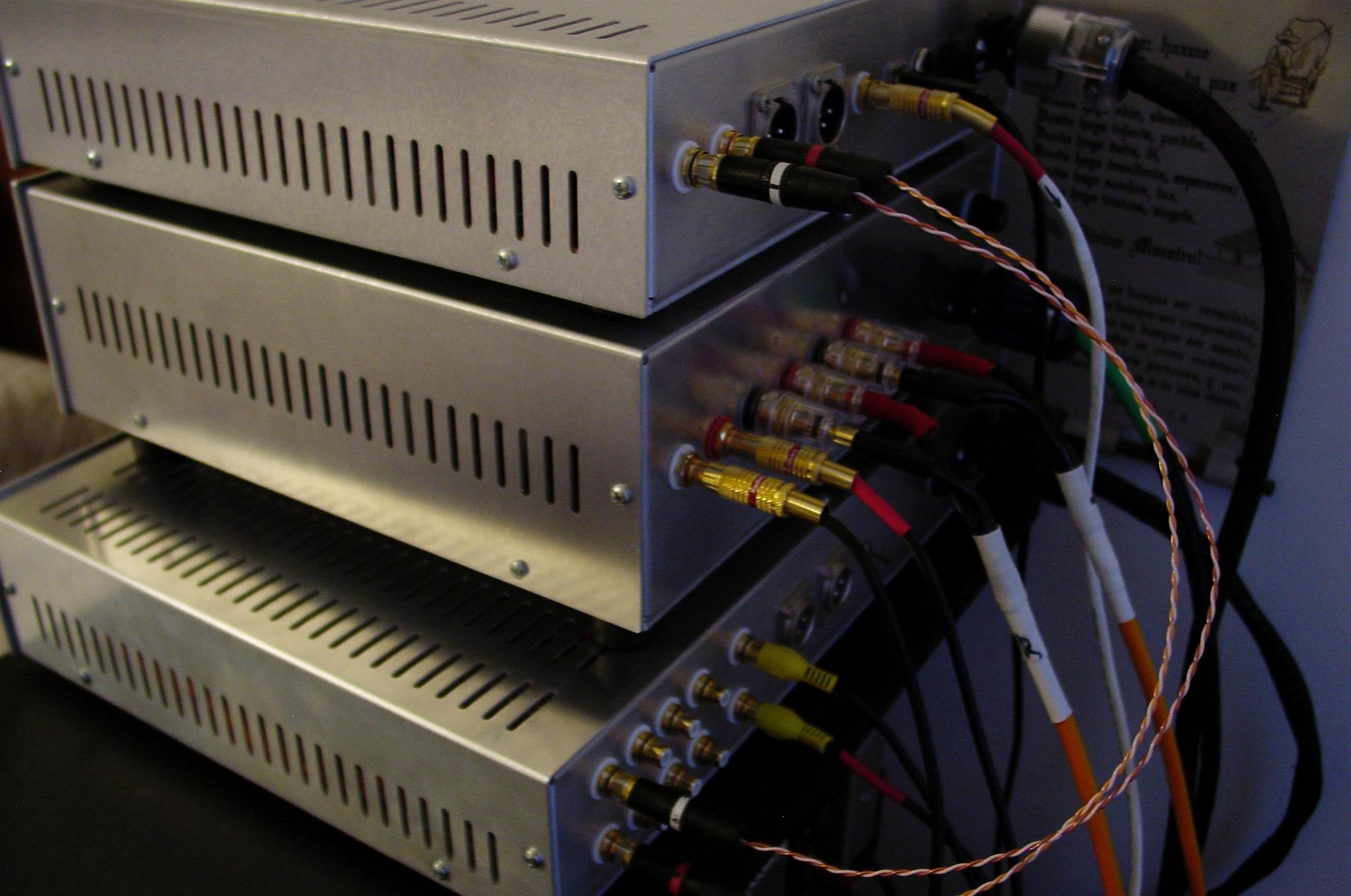

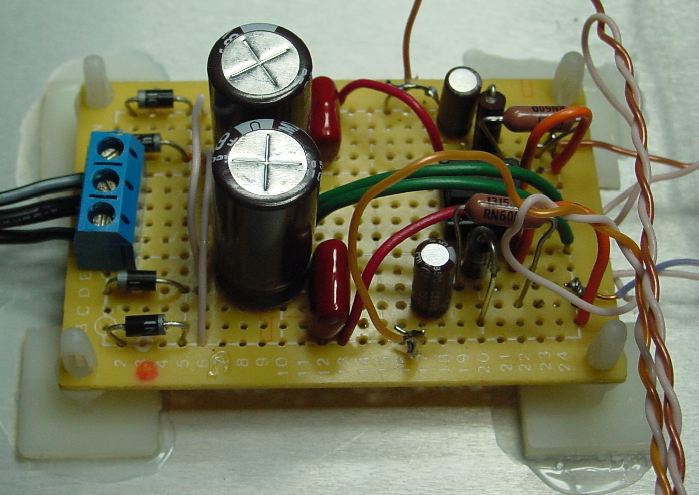

For now, the inverting pre is back to 10X gain, 10K input and 100K feedback resistors as of this writing. The hiss is not discernible from the listening position and is decreased considerably.
I know I may be biased, but this simple pre sounds quite good and has plenty of tight bass response. It is clean sounding, probably one of the cleanest sounding preamps I've heard. Generous in detail as well and very few things seem to escape its grip on the music if any at all.

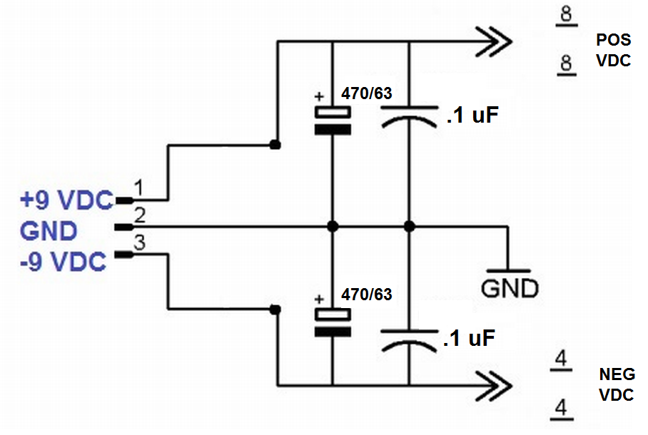

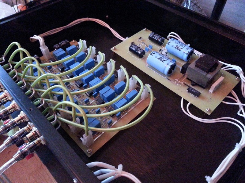

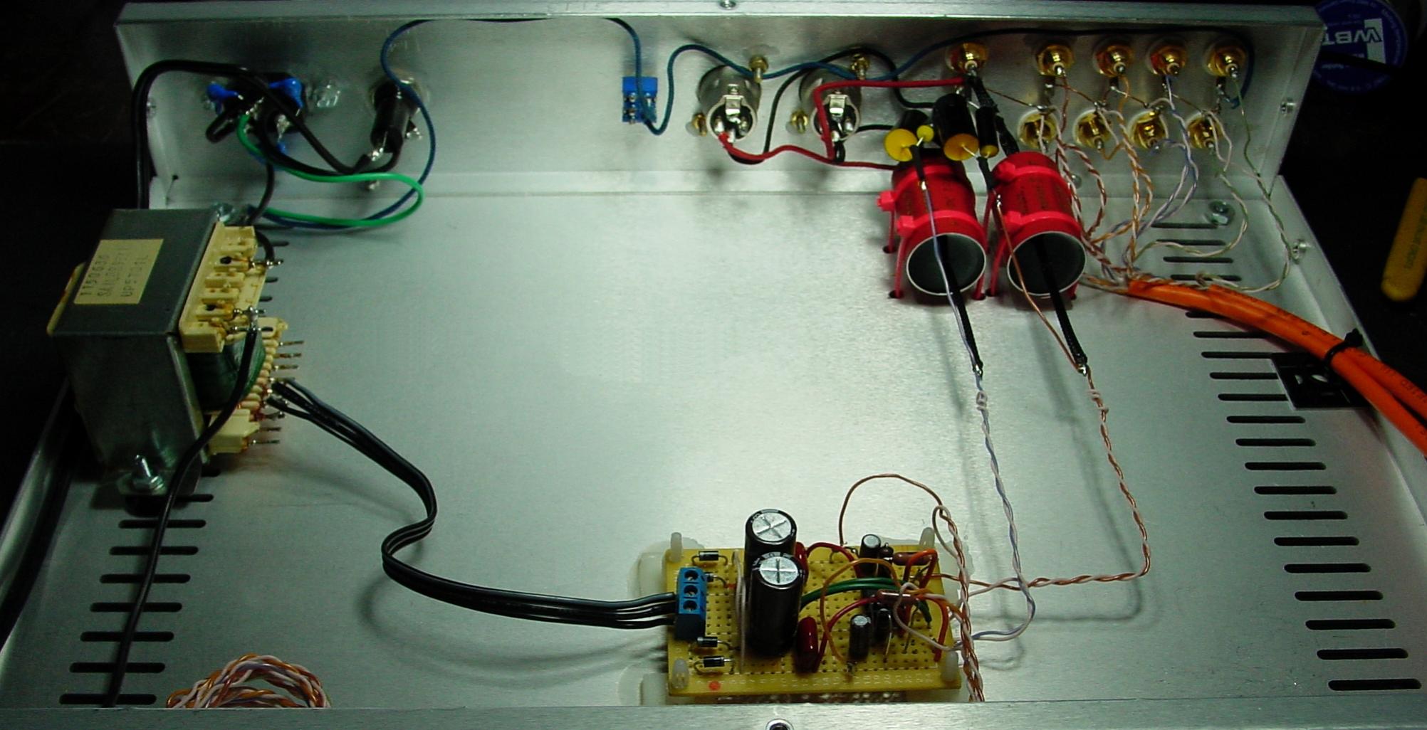

Final pics and schematic of the inverting pre follow for someone else to try. Not a big effort or many parts, plenty of payback.
I do wonder if these Rubycon caps in the power supply board are legit.
Thanks again.

There is no need placing resistors between +In and Gnd-these are hum sources. The offset is no problem when talking about pre-stages.
Also some small capacitors will turn inverting preamp in integrator for high frequencies and will stabilize the stage-please see the picture.
Ground decoupling by small resistor (5...20 Ohms) has it's own noise cancelation function too.
Of course, high impedance inverting circuit can be used to get desired amplification using 1 opamp.
Regards: Nick :)

One last thought on the LME49720 inverting configuration preamp.
As you will recall, I have built two identical preamplifiers with this chip. I had to try different combinations of input and feedback resistors (aiming to stay at 10X gain) in order to cut down hiss and improve input impedance. Here is my experience:
Input/feedback resistor values:
10K / 100K: A good compromise for solid state power amp, not too much hiss, adequate treble- 10X gain
15K / 150K: More hiss, slightly better treble, better input impedance, well suited for tube power amp- 10X gain
47K / 470K: Too much hiss, great treble extension, but distractedly noisy- 10X gain
Overall I've kept the tube pre at 15K/150K and the solid state intended pre at 10K/100K combination.
Thanks for all the input, moving on to non-inverting...
