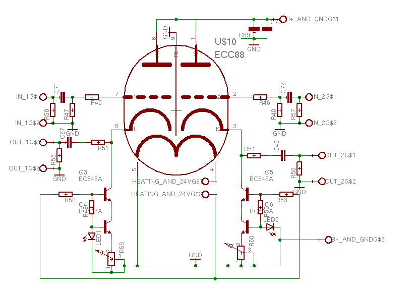

SY drew a line stage preamplifier, almos exactly what I was looking for.
I modified the schematic to what I exactly needed, and moamps advised, I should start a new thread, becouse of the modifications.
moamps said:
The drawing is better but maybe I should highlight a couple of things regarding SY's original schematic (not any variation thereof):
I have attached my "version" of the schematic.
1) pin5 can't be connected to the ground,
Regarding to my schematic, is that still wring?
(i will use a separate powersupply for the heating)
2) CCS can't be connected to the ground but to -12V PS,
Why? I was always wondering about that ...
Isn't it enough, if I just feed with +24V DC the CCS ?
3) +B supplies should be separated.
How do you mean that? Each one has a dedicated decoupling-capacitor?

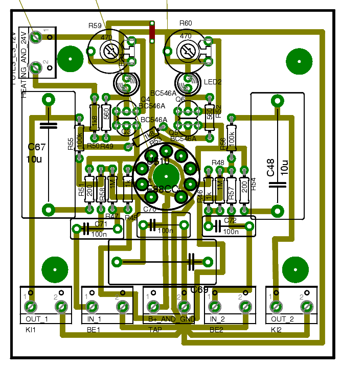

P.S. It is a common view that routing tracks under the right angle should be avoided.
Why? 🙂
I read about it in a paper, but that (the paper) was about switching mode powersupplies. That paper said, that the 90degree broke tracks act as a small antenna, and it is better using rounded trancks.
Is this (what you said) is about the same thing?
It's OK.
If Va=100V and Ia=10mA, then Vgc=around -2V.
The CCS can't work correctly with only 2V on it.
Each one has a dedicated RC network.
Yes. It isn't the main issue here, though (that's why the remark is in P.S.).
But, if you don't have to use right angles, then don't.
Especially not in a "heretical" unity gain stage. 😉

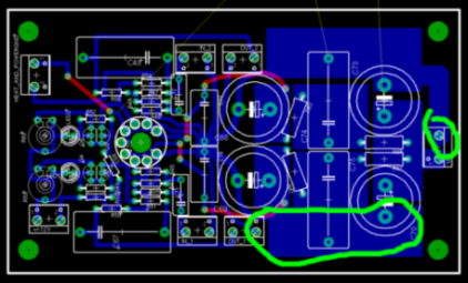

Is it a big problem, if I put the B+ filtering RC-network on another board, and not on the tube's board? In this case (when thr RC net. is not on that board) I put 1uF - 1uF capacitors to the B+.

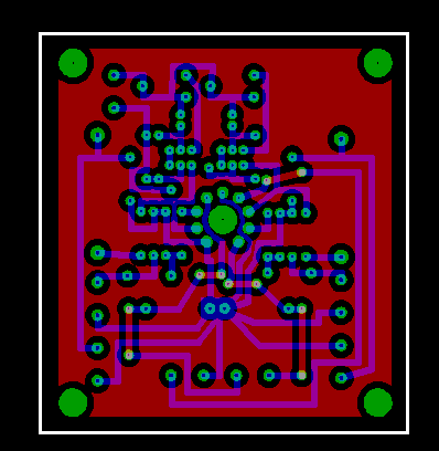

Is it a good idea, to create a biiiiiigbig plane on the component side, which is not connected to anywhere, except the GND, but the components aren't soldered to it? I'm thinking of somekind of shielding. Look ad the attached image!
The plane would be soldered to the central GND-star point with a wire.
There's another advantage this: I have ONLY 2-sided plain-PCB at home, and if I make single-sided boards, from one side of the board, the copper goes into trash. 🙂
