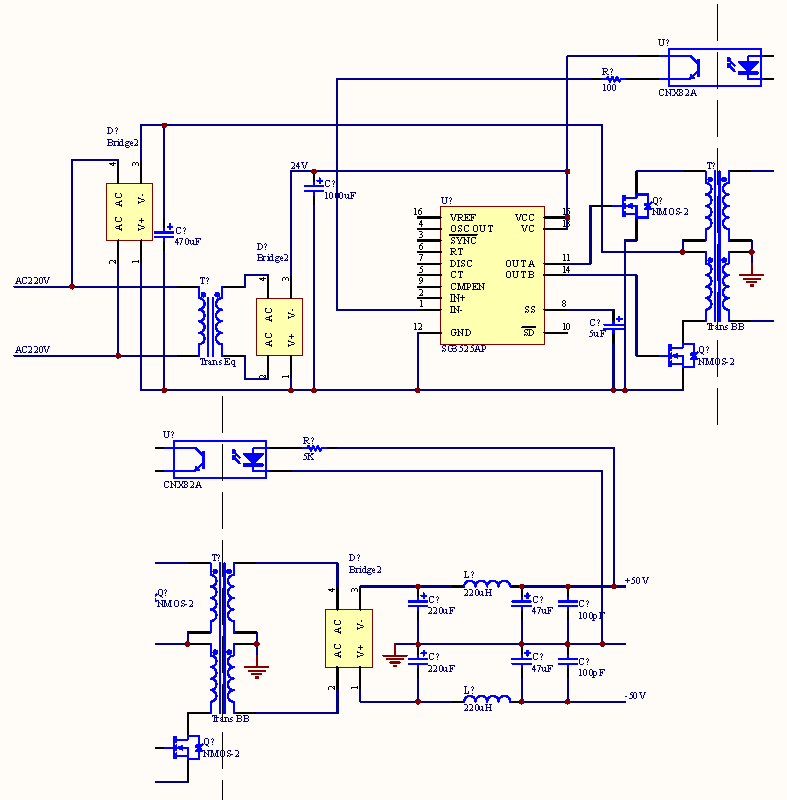

SMPS design sketch
Hello to everyone!
First off, I'm not experienced in SMPS design, but I'm very willing to learn. Even though my goal is to design and build a high power (500W+) supply, I want to start low, and work my way up. My main design principle is KISS (keep it simple, stupid), therefore I present to you one of my preliminary sketches. The whole thing is built around a SG3525 controller, with a conventional power supply in front of it. I am considering using the BP5041 (220VAC/12V 100mA) integrated converter from ROHM (not sure if it will cope with the current demands). I’m not sure whether I need a FET driver (can the SG3525 drive the FETs on it’s own?).
A problem I haven't found a solution for yet is what kind of filter is needed after the power transformer.
Well, as I’ve said before, this is only a sketch, and I’m very open to suggestions, comments and corrections, and every piece of advice tossed my way will be greatly appreciated. I'm hoping that my project can materialize soon, with the help of this forum.
Cheers!
P.S. oh, yeah... there are resistors between the controller's outputs and the FETs... you just can't see them 🙂
Using the KISS method to approach any design is good. I think you are starting off with a difficult design. Look at what Eva did to get a great very practical and efficient SMPS in early posts in this thread. That design probably took a good bit of effort. For 500 Watts+ or any design for that matter, I would not try to re-invent the wheel, but use a very similar approach. Find some schematics on a 300 Watt+ PC SMPS to get more understanding of a real working SMPS. Avoid using opto-couplers. You can find some very good application notes to read at www.ti.com, following the power management link. Study both the data sheets and application notes on several of the PWMs. Look at current and voltage mode PWMs. Since you need transformers and inductors, go to the Mag Inc., and Ferroxcube websites and download their transformer and inductor design application notes. Get some of the basic understanding behind you, first. You will have to make your own PCB or create the layout and Gerber files. You can attach a Gerber file to an email and send it to a PCB manufacturer and have nice PCBs delivered possibly, depending on your location. Most PCB manufacturers will give you a price quote based on the Gerber file. You may already know how to make your own PCBs, but creating the layout for a medium to high power SMPS requires some very good analog layout skills.
Some references :
This schematic shows a classic AT PC power supply with its self-oscillating auto-start feature and its separate current sense transformer for accurate current limiting [modern units sense the current through the base drive transformer in order to reduce costs]
This schematic shows a typical ATX PC power supply. Notice the primary side is no longer self oscillating and the current limiting is sensed on the base drive transformer. Notice also that the control circuit is powered from the standby separate supply [rudimentary flyback converter]
Old AT PSU topology, based on a half bridge that starts self oscillating until control circuit takes control, based on bipolar transistors and proportional current drive, tends to be very reliable. I still use an AT PSU in my computer and it's now 10 years old, 10 years working about 24hours/day and still no failures except noisy fans [replaced periodically]. This unit may actually live longer than me! 😀
http://www.qsl.net/xq2fod/Electron/PS40/PS40.html
And finally, this page has some info and explanations on a higher power unit [500W] using the same AT PSU topology. [Don't try to use these BUH transistors, I've tested it and they are very slow and expensive]
In the design of these kind of SMPS I think there are three tricky parts :
- Designing transformers to have low leakage inductance and to operate the cores at high magnetic fluxes but not enough to saturate it
- Designing output filter and frequency compensation of the voltage/current control loops to make them stable with the maximum permisible amount of feedback
- Optimizing switching waveforms for minimum ringing, low switching losses and no more dI/dt or dV/dt transients than required for operation
Then comes EMI reduction and filtering but this is a topic by itself Anyway, non-overlapped switching with bipolars and thorough a coupling transformer with some leakage inductance tends to generate much lower EMI than direct MOSFET-diode hard-switching
taking notes
Ok! Very interesting links/schematics/hints/ideas... etc etc
Some things I've noticed so far :
