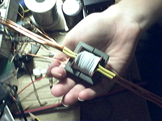

Iron powder cores are not suitable for magnetic coupling transformers due to its low permeability [mu=50 or so] that would require a huge number of turns and therefore huge leakage inductances
For your purpose, you need low permeability power ferrites [mu=2500 or so], higher permeability ferrites [mu=10.000] are more suitable for signal transformers
Low loses in the core up to high frequencies [>1Mhz] are not required except when you use high switching frequencies [>200Khz], for 30-100Khz most power ferrite materials are suitable [to get an idea, look for 3C85 and 'equivalents']
As an example, in the attached picture you can see a transformer with ferrite core that I use in one of my designs [It's something like an EE 42, In my country I can only get this kind of 'no-name' stuff at reasonable prices]
Windings are designed to operate at 31Khz [pretty slow for today standards but allows to use cheap bipolar transistors for switching and still get low losses, 4x MJE18008] and to mantain 1KW output [14,4V 72A regulated] with little air cooling [less than 8 watts losses in the copper]
Secondary consists of to layers, each with a 4-turn winding made witn 5x 1mm diameter wire and is sandwitched by two layers of primary with 24-turns made witn 1mm wire [sandwitching reduces leakage inductance to 8uH as seen from the primary side with shorted secondaries]
Insulation between primary and secondary in this prototype consists of 3 layers of common insulating tape [I can't find the usual mylar tape in my country] and wires are protected with PVC tubing when they enter and leave the bobbin
To saturate this transformer you need to apply more than +-360V square wave to the primary at 30Khz and 25ºC, this is the main criteria to select its number of turns. I use to avoid calculations and do it empirically, measuring current versus volts*time/turns curves and selecting a good compromise [50 to 70% of the value needed to saturate the core at 25ºC since at higher temperatures the core saturates faster]
Knowing a valid number of primary turns for your application, then you can select secondary turns for your desired turn ratio [more primary turns means more leakage inductance, ie: more time [lost] needed to reach the desired current with given voltage applied to primary and load to the secondary, about 200nS for this design]

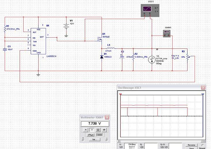

I thought I would post something that I just started to work on for your comments. please note that this is not meant to be correct or be actually built. It is at this stage just for discussion.
this is a 555-based smps. the 555 acts like a pulse width modulator (shamelessly stolen from National's datasheet on LM555, figure 8/9), control'd by a voltage signal on its pin 5. its output, pin 3, is attached to a mosfet Q1's gate. so Q1 will turn on and off based on pin 3. when Q1 is turned on, C2 gets charged via L1 (D1 is the free wheeling diode). R2 acts like a constant load, and variable current source, I1, acts like a variable load (in this case, at 6Khz). R3 samples the voltage across C2, and feeds it back to the 555's pin 5.
so by adjusting the wiper on R3, you get a desired voltage on C2.
R1/C1 is usual charge/discharge network for a 555 astable.
at this particular configuration, the output is rock solid, after the 50ms or so, at 7.738v. So it appears to work on paper.
Questions:
1) will it work in reality?
2) what can be done to make it better topology-wise? and why?
3) how to optimize parameter values?
Congratulations, you have figured out by yourself the basic 'buck converter' topology with voltage contol [actually some kind of histeresis peak voltage control]
It may work in reality with some changes
Output filter is not realistic, you can´t use 47mH inductors with 0 ohm DC resistance nor 470uF capacitors with 0 ohms ESR [not to talk about the size and weight of a 47mH 2A inductor]
The output filter is nothing but a simple 2th order filter feed by a PWM signal that has AC and DC components. The filter should give good attenuation to AC components [whose minimum component is the switching frequency] and output the DC component 'clean'
So if you operate at 100Khz then your output filter should provide good attenuation [ie:60dB] at 100Khz and higher frequencies [you may add an aditional LC filter to smooth things further]
The output filter is placed in the 'transfer function' of the converter, so try to simulate 47mH and 470uF as a 2th filter with little or no load and you will see the huge resonance peak it causes
To be able to apply feedback in a reliable way to the whole thing, you have to design the filter to have little peaking and apply some degree of frequency compensation to the 'error amplifier' in order to prevent positive feedback [like in power amplifiers] [usually a zero near one of the output poles of the filter]
The way in wich the MOSFET is driven is also unrealistic, a consistent square wave between gate and source must be used
The control circuit is also unrealistic since it appears to work at a variable frequency and this makes it hard to filter the output, try to use a PWM whose duty cycle is controlled by an operational amplifier whose output is proportional to the difference between output voltage and desired output voltage [gain should be rolled off to avoid feedback at the switching frequency and above]
You should try to bread-board something with a SG3525 o TL494 [typical cheap control ICs], an iron powder inductor, proper mosfet drive
For that kind of converters, schottky diodes are recommended since they have negligible reverse recovery time, so you can swicth a MOSFET over the diode when it's conducting without causing very high current transients due to the diode apearing as a short-circuit for 100ns or so until it stops conducting [look at diode datasheets for reverse recovery waveforms and timing]
thanks eva, you raised a lot of good points and I don' thave all the answers.
the frequency of the 555 is determined by r1/c1.
Actually the circuitry has a foudamental flaw: it didn't have a trigger signal, 🙂.
it did work in my simulations but seems to suffer from low reaction time (with the trigger at 100khz). not sure why.
to have a consistant Vgs switching signal, I would have to use a p-channel mosfet. but then the phase of the 555 modulator is 180 degree out. so I wouldn't know how to make it work that way.
what I am really interested is to have a similar circuitry but works off line voltage.
I guess we aren't there yet.
