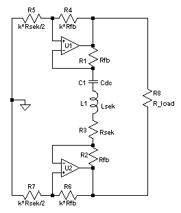

Returning to Okapi's original question, there is also a simple and cheap (and good) all-in-one solution.
One can combine the balancing with the bridging, using the copper-compensated zero-field topology (simplifed schematic is attached). This allows for small and affordable xfomers, like the small Neutrik or Lundahl types, but even a $5 model might easily suffice for a chip-amp performance level. Only thing which would be not on top level is CMRR, but this can be significantly compensated for with an arrangement of two equal xformers in anti-parallel/anti-series.
I've done this circuit with small-signal op-amps with success, it should work equally well with any power op-amp, given proper compensation for stability if required (e.g., a series-RC accross the xformer might be needed to get a stable HF gain for a decompensated op-amp). The op-amps run in inverting mode with only little common-mode voltage on their inputs which helps linearity. Also impedances can be very low. As in every true bridge, GND is only a reference voltage (Vs/2) and does not carry load current, therefore a single supply can be used and the ref. voltage can come from a simple divider. The divider can by bypassed to the supply end with lower supply rejection from the chips, which is the neg rail for LM3886 IIRC. The series cap after the xfomer is neccesary to keep DC away from the xformer and it gives unity gain for DC which keeps output offset low.

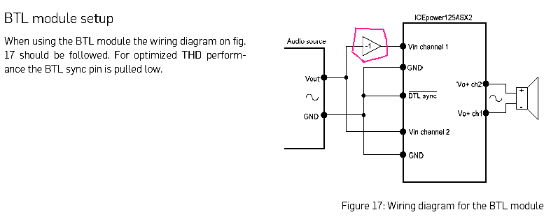

hi all
I have a Aikido 12Vac line preamplifier before the 2 x IcePower 125ASX2, Since I am using icepower in BTL mode, I need unbalanced to balanced conversion from preamp output to the power amp input.
SO I bought a 600:10K Audio Transfromer, my plan is tto take unbalanced (RCA) output and turn it into balanced XLR output and insert into the icepower amplifier.
The question is; Which side of the audio transformer should be unbalanced, should I use the 10K side as unlbalanced input, and take the 600 ohm side as output, to the balanced xlr input of the power amplifier? or should I do it vice versa?

Unless I am totally blind I am not seeing where you need to be balanced going into the BTL input. Maybe I just need a second or third cup of coffee.
...need a second or third cup of coffee.
Or a read of the datasheet.
It indeed shows an inverter to get BTL operation. (Seems they maybe could have put it on-board, especially since there is a BTL mode for the oscillators, but...)
Why 10K:10K instead of 600:600?
It is clear the input of the IcePower is well above 10K, so that will work.
It is not clear that a tube like amp will be happy driving a 600 Ohm winding (even un-loaded). Where 600r is required we usually use beefy tubes, 6V6 not twin triodes.
It would "work", but may be compromised in the bass.
However it is your project, do what you want.
So BTL is bridged operation from what I see on the diagram. Where does it show that is is balanced in? I see signal and ground for input on both channels but I don't see the +,-, and ground in for a true balanced input.
The diagram shows unbalanced input. The Ch1 gets an inverted signal and Ch2 gets a non inverted signal.

Hi PPR
thanks for the clear explanation. I just wanted to know the correct impedance. I should change my transformers.
Because I already have an 600:10k transformer. I gave it a try. I removed the burrbrown balancer circuit and put the transformer. Now Bass is very heavy a little bit boomy. Trebles feels like in the background. Mids are beautiful but too much. Generally sound is very thick feels like frequency drops after 8-10khz.
What do you think about this?
