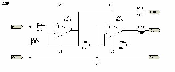

Hi okapi,
Do you just want to convert unbalanced to balanced (i.e. single-ended to differential), or are you bent on using a transformer to do it?
If all you care about is the conversion, you could do that with two opamps. Basically, you just feed the single input to two differential amplifiers, one inverting and one non-inverting.
(I assume that you are wanting to bridge two already-complete, identical chipamp-based amplifiers. Otherwise, you could just use the chipamp chips in the bridged configuration, as in AN-1192 from national.com.)
If you are interested in using opamps, below are links to some example circuits, that you might be able to use (or adapt) to your purpose.

Of course, you could also do it with a single fully-differential opamp.
The transformer is the best way to balance because it provides a higher CMRR than an op amp or other SS circuit is capable of.
You can of course use either transformers to balance/unbalance or a op amp circuit or a number of other ways.
If you are interested in a circuit just to bridge to identical chip amps or other amps period I will try to attach something here.

That's why I also pointed him to AN-1192. That type of circuit would work if he were starting with just the chipamp chips, but not if he already has, for example, two identical non-inverting chipamp-based power amplifier boards. I assumed he wouldn't be asking if he was starting with just the chips.
I do not consider myself to be an expert at this stuff. But I think it is debatable; i.e. whether or not a transformer-based approach would necessarily have "the best" common-mode rejection (CMR) [before even getting to the debate about whether or not it would be "the best solution", overall].
If you read the section entitled "A Summary of Line Receivers", on page 463 (in Chapter Six) of Walt Jung's "OP Amp Applications Guide", which is downloadable from http://www.analog.com/library/analo...s_handbook.html , he notes that the solid-state approach has the best high-frequency CMR, in absolute terms, and better CMR versus frequency flatness, while the transformer-based approach, especially if the transformer is improved by combining it with a differential amplifier for balanced-mode post-buffering (as in Fig 6-33), has the best low-to-middle frequency CMR.
Looking at the plots of CMR for the two approaches, in Figs. 6-31 and 6-34, the instrumentation amp approach has significantly better CMR than the transformer approach, everywhere above 700 Hz or so. For example, at 10 kHz, the three-op-amp instrumentation amp of Fig 6-30 shows CMR better than -100 dB, when using AD845 opamps, while the Fig 6-34 plot of the CMR of the transformer-based circuit of Fig 6-33 shows less than -75 dB at 10 Khz. At low frequencies, however, the transformer-based circuit has much better CMR, nearly -125 dB at 100 Hz, versus only about -105 dB for the opamp-based instrumentation amp circuit of Fig 6-30. (How significant all of that might be, I don't know.)
That whole section of Chapter Six, entitled "Audio Line Level Stages", and starting on page 447, is excellent reading.
It appears, at first glance at least, that one of the "balanced line receiver" types of stages could simply be added after the unbalanced-to-balanced converter, to improve the CMR. See, for example, Figure 6-30 on page 458. And it seems like (again, at first glance, at least) the CMR could be made as good as one wanted, with the solid-state approach, just by adding additional instrumentation amp stages, at relatively low cost.
[The circuit in Figure 6-56 (Page 482) looks interesting, too, in the section entitled "Cross-Coupled Differential Line Driver", as does the circuit in Fig. 6-169 (Page 585), where the three opamps in an instrumentation amp configuration are all replaced by actual instrumentation amp chips, e.g. AD623.]
At any rate, which approach is "best", overall, depends on more than the CMR specs, unless cost, size, and weight are no object. I would certainly want to try both approaches, if cost etc were no object. In my case, I think I would try the opamp-based approach first, and then spend the $ for transformers only if that was not satisfactory.
