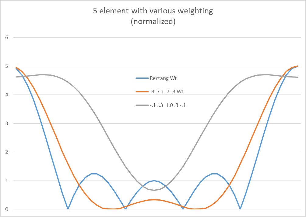

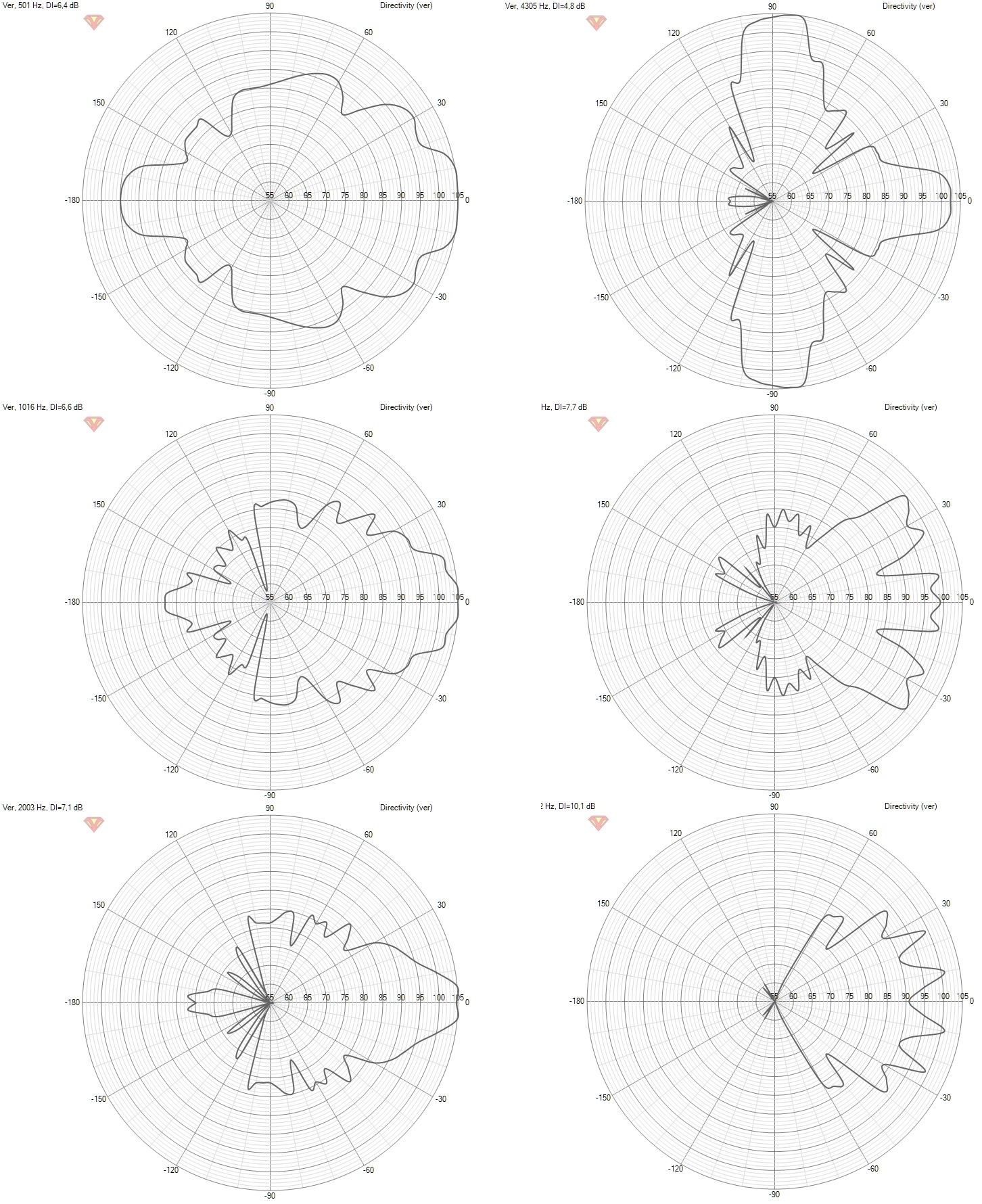

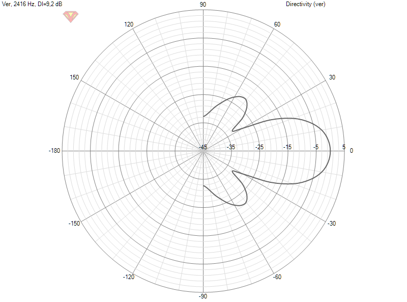

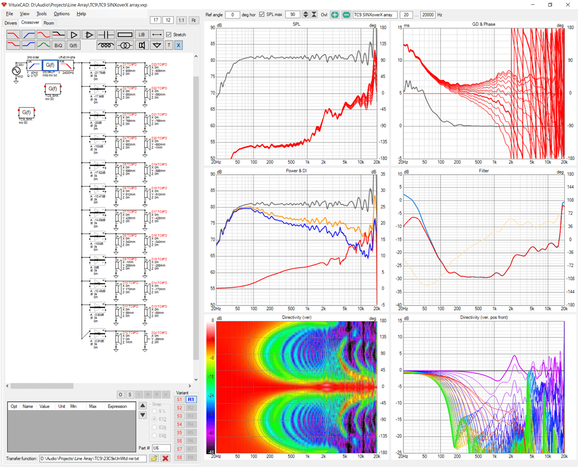

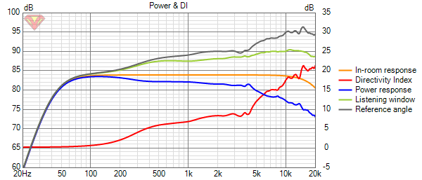

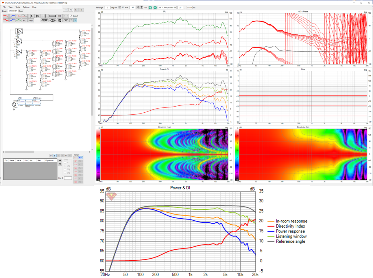

It may be off topic by now but as recompense for my careless errors yesterday I applied the Bessel weights to 5 groups of 5 TC9s. The array smooths out fairly well but it results in head in a vise vertical directivity. That is something Wesayso and I noticed before. He worked hard to find a set of weights which balanced out reducing the combing and keeping a wide enough vertical window for both seated and standing listening.
When I auto-EQed the axial response flat I saw a distinct lack of treble in the in-room and power responses due no doubt to the beaming of the full range driver.
~2400 Hz straight array 1.0, 1.0, 1.0, 1.0, 1.0:
~2400 Hz, 0.3, 0.7, 1.0, 0.7, 0.3:
~2400 Hz -0.1, 0.3, 1.0, 0.3, -0.1:
If I use EQ to flatten the in-room response and extend the bass a little, which I could justify with frequency dependent weighting, I get a very good predicted preference rating of 9.4, still with that narrow vertical directivity.It may be off topic by now but as recompense for my careless errors yesterday I applied the Bessel weights to 5 groups of 5 TC9s. The array smooths out fairly well but it results in head in a vise vertical directivity. That is something Wesayso and I noticed before. He worked hard to find a set of weights which balanced out reducing the combing and keeping a wide enough vertical window for both seated and standing listening.

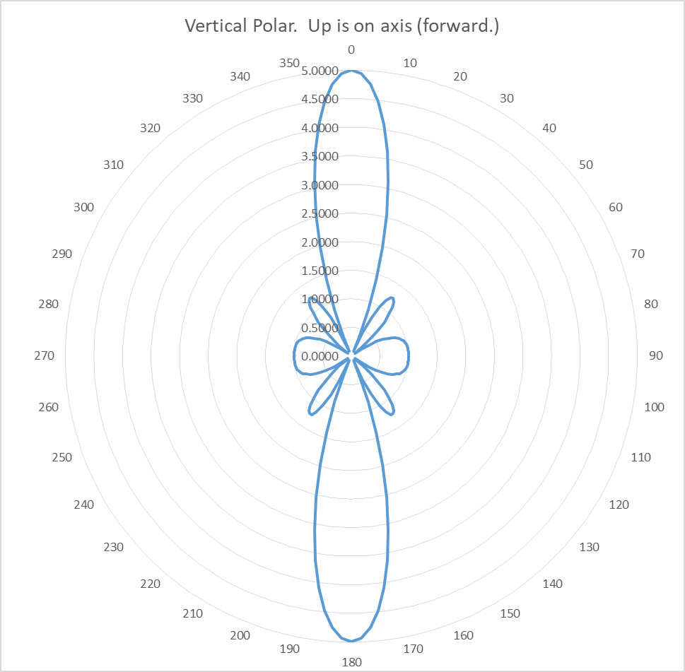

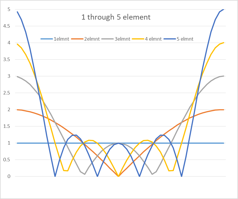

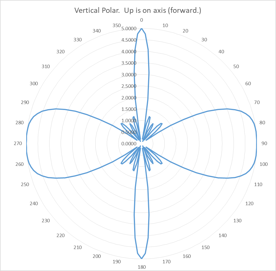

Getting back to the 5 element spreadsheet. There are a few things to observe.
In a plot like this, what are the x and y axis?
Sorry, but I've gotten used to looking at a single cycle of FFT as a short cut to a polar plot. This shape, though could be found both in a polar response (and maybe more than once) or in a frequency response at some angle.

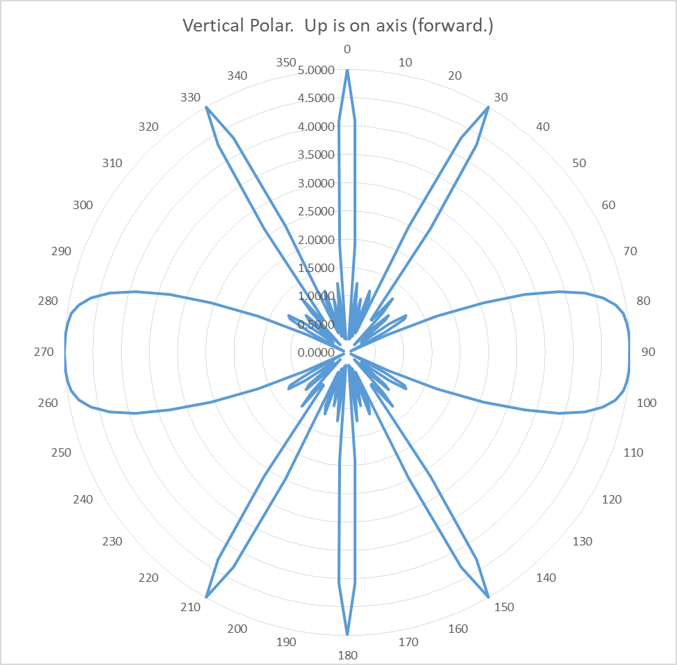

Let me do some examples to make it clearer.
So here is the 5 element equal weighted array for the case for Dee = 5 and Lambda = 10 (frequency is immaterial but the spacing of the elements is equal to half the current wavelength).
We see that the forward response (up on the curve) has gotten narrow and there are some small lobes near 90 and 270 degrees.
Here (below) we have doubled the frequency, both Lambda and Dee are now 5 cm. You can now see a full strength lobe at 90 degrees. You can also see 3 minor lobes or 4 cancellation dips in the gap from 0 to 90 degrees. This is essentially the plot you were asking about but viewed as a polar graph.
Why do we have a strong lobe at 90 (and 270) degrees?
Because we have found a frequency where all of the elements are back in phase again. They are all one wavelength apart so in the 90 degree direction they are as in phase as they were at 0 degrees.
If you are onboard with the "Its really just an FFT" explanation, then accept that we have found an alias frequency. (and for shorter wavelengths there can be more.)
Lets double the frequency (halve the wavelength) again.
Now we see two full cycles from 0 to 180 degrees (and on each side). This is just 2 cycles of aliasing based on the wavelength/spacing ratio. We always get a lobe at 90 if our factors are integers. We also have a lobe a +- 30 degrees where the sine of the angle is 0.5.
All these patterns are tied back to the single cycle (DC to aliasing) FFT mapped to our circle with the Arcsin function.
This is a key point. Its a little hard to comprehend but worth understanding.

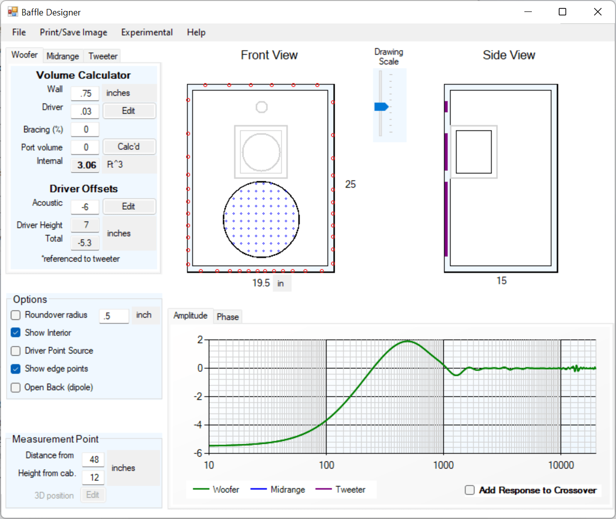

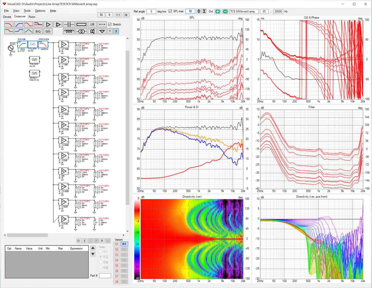

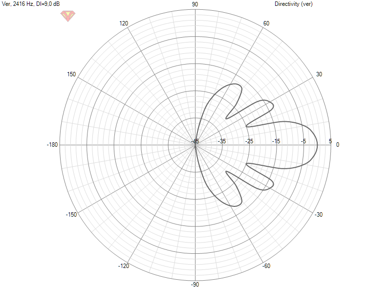

I just applied the same weighting to a 5 driver model in Vituixcad and showed the polar chart of that.@wesayso how did you make those plots?
I downloaded two spreadsheets, didn't see that capability in either one.
This is with a modeled 3.5" driver, so the directivity of the driver itself influences these results.

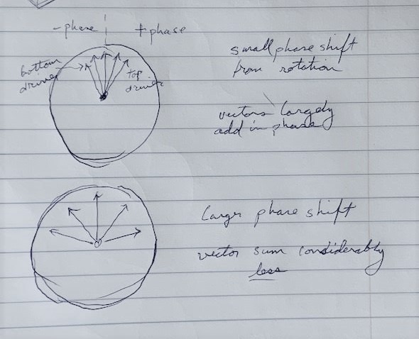

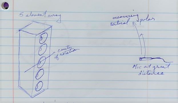

I just wanted to take one more stab at a graphical understanding of polar patterns of arrays and specifically where the nulls come from. Apologies for the rough sketches.
Let's stick with our 5 element array. The units all have a strength coefficient of 1 (unweighted) and are equally spaced. We have a mic at a great distance (making this a farfield prediction). When can start to do a vertical polar by swinging the microphone upwards.
As the microphone moves it is getting closer to the upper elements and farther from the lower. This means there will be a phase shift to the individual arrivals with the upper elements swinging + and the lower -. Since we are rotating the mic around the center element its time arrival to the microphone never changes.
I picture this as energy vectors arriving from each element with the vertical movement causing the vectors to rotate forward or backwards as determined by the geometry. For initial microphone movement we will see just a little amount of vector "spread". Since the vectors all need to be added our strength max of 5 is only slightly reduced.
The upper sketch shows a little bit of phase shift between elements. As they are largely aligned towards the up (0 degree) direction then most of their strength is preserved. The vector sum is near 5.
In the lower sketch you see greater spread that occurs after more rotation of the microphone. You can see that the widest vectors look like they are going to largely cancel each other out. Also note that, as a consequence of our elements being equally spaced in our enclosure, the angle between these vectors is perfectly uniform.
At some angular mic rotation the vectors will have swung around such that they are all perfectly evenly spaced (72 degrees apart in the 5 element case). These 5 vectors must necessarily add to ZERO amount, forcing a null in our polar graph. We saw in previous graphs that our 5 element array had 4 nulls, meaning 4 points where the vectors sum to zero before the next response peak.
You should also be able to picture that mic rotation will cause the vectors to swing forwards or backwards until they all come together again (aligned to the top) and we will have hit the 2 x Nyquist aliasing repeat.
This is the basis for any line array program: based on the geometry of the array (straight, curved, equal spaced or not) the program must calculate the relative distance from each element to the microphone, express that in terms of wavelengths to create rotated vectors for each element, and then vectorially sum all the elements.
Hope that makes sense.

And I'm guessing that this is one of the reasons that the inclusion of one or two elements with reversed polarity improves the polars and the response:
1) at off-axis angles where a flat array would be in phase (and exhibit an off axis peak) the reversed drivers reduce the magnitude of the peak
2) at off-axis angles where a flat array would be out of phase (and exhibit an off axis null) the reversed drivers reduce the magnitude of the dip
3) But even when there is neither a peak or a dip, the drivers wired in reverse are reducing the overall SPL
I'm guessing that if someone had a way to automate the amplitude of the elements, you could optimize the on and off axis response. With five drivers you could like assign a series of possible SPL values for each element and then run the sims to pick out the best. You might need to evaluate as many as a hundred different combinations, ideally.

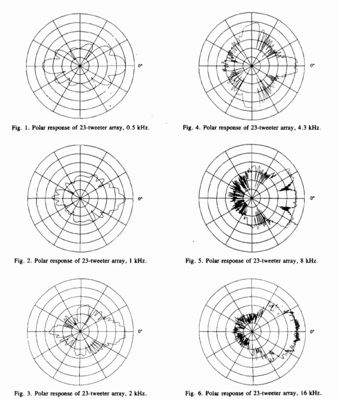

The 1997 paper
So I was an engineer at McIntosh in the 90s and they had 2 line array models in the product line. One had a long array of tweeters, 23 elements in all. It had started out as 25 elements but they had issues with the line fitting in every house, especially clearing the baseboards of more traditional homes, so they trimmed it to 23 tweeter. As they had been using 5 group of 5 in a series parallel arrangement they just inserted some resistors to retain the right voltage to the remaining group.
There was also a short array with 16 tweeters. This one was a little different than the other in that it had a sort of filter arrangement to attempt to optimize issues that seemed to come along with it being a short array. Carl VanGelder had come up with a computer program for response optimization (on and off axis). It split the 16 into 4 groups and applied a variable filter to each group. The computer was given some sort of optimization factor and ran to town until if felt like it had the filters with the best overall performance.
I looked at the voltage drive to each of the 4 sections and also the response at a distance and couldn't make much sense of it. Carl and I talked at length about it, and to a lesser extent, Roger Russell, and it occurred to me that we just didn't understand how these arrays worked. It was clear that the arrays seemed to have differing behavior in different frequency ranges. Response of the long array was pretty uniform as long as you stayed within its length. Still there were frequency regions of high directivity and regions where the response would broaden out again, but there might be extra lobes that start at 90 degrees and swing in. It seemed to me that it wouldn't be too hard to figure out a simple model for array response and play with your variables until it all made sense.

I started sketching out the geometry of an array and how the phase shifts between elements would be caused when viewing it at an oblique angle. I had a series of co-op students that could program Fortran (on a PDP10 computer handed down from the electronics side) and so we started to develop a computer model.
Section one attached here talks of the first model, which I came to refer to as the "far field model" (because I quickly had to develop a more sophisticated near field model). The far field model is essentially what I have been showing in the Excel spread sheet. It takes into account that you create phase shift when you view an array at an angle but assumes an infinite viewing distance such that level drop between elements, or geometry warpage, is non existent.
The first paper of the section then compares a number of measurements in the anechoic chamber, of the 23 element array versus the predicted polars created by the program. Results were mixed in that there were some similarities between measured and predicted, but generally the lobes predicted were a lot sharper what was seen in the measurements. This is explained later.
McIntosh had a nice anechoic chamber but it wasn't huge. The array was more than 6 ft. and would have been awkward to rotate in its norm orientation. We ended up placing it on its side, half way from floor to ceiling, and rotating it horizontally to create what were actually vertical polars. Even in this orientation I don't think we could get farther than 2 meters away when putting the measuring mic in the corner of the anechoic chamber.
So at this point we had some limited success. I had a program that I could confirm against some published polars by Olson, and I had fair to poor correlation between measured and predicted performance of the Mac 23 element array. I was starting to wonder if the model complexity was sufficient or not, and what would be needed for a better model...

I'm not sure where this discussion is going, but one reason that "the lobes predicted were a lot sharper what was seen in the measurements" could be the limitation of a point source model. When I wrote a baffle diffraction model about 10 years ago, I added a checkbox to switch between a point source and piston-source model. The piston-source used points on the driver spaced 0.5" apart (the blue dots in the second screen shot). Those sharp lobes in the first screen shot (point source model) go away in the piston model and are attenuated even more when the 4-point round-over is used.
The model generates about 4 million vectors for a 10" driver, but that's not a problem for modern CPUs. The model is described here.
While waiting for the next installment of this beautiful series, I figured I'd put Vituixcad to the test and simulate the 23 tweeter model with 80mm spacing.
I was impressed with Vituixcad when comparing it to my own array measurements. I've come to trust it enough to make some changes to my arrays based
on Vituixcad's predictions. I modeled the tweeter with the diffraction tool within Vituixcad and set the distance to 4 meter and looked at the polars.
I tried to match them best I could but it isn't that easy to get the exact frequency in the polar predictions.
Let's see how it does compared to the published measurements from Dave's paper:
I'll attach a bigger graph of the predictions, but I'm pretty impressed (again) with these quick comparisons. 🙂
In Vituixcad we trust 😀.
Basically what we have available here is quite close to Dave's working array model with the driver directivity convolved upon it?
At least that's what it looks like to me.
My hats off to those who can write their own analysis spreadsheets but even further to Kimmosto who wrote Vituix so we no longer have to.
I put together a 23 element TC9 array with SinX/x weighting to see what it looked like. Everything looked great until I displayed a vertical line chart which shows complete loss of treble just 5 degrees off the vertical axis. This is the same thing we saw with other weightings and frequency taperings - directionality narrows as the array becomes less uniform. It seems all attempts to smooth out the response by weighting or tapering inevitably narrow the vertical directivity.
I next shorted out the weights and re-equalized. The vertical directivity of the uniform array is quite a bit wider but the line chart still shows nearly > +/-4 db variation just 5 db off axis. We know they are better than that in room due to floor and ceiling reflections increasing the effective length but they don't approximate the infinite length array as closely as we'd like. In this simulation, a 300 mm vertical offset a 4m listening distance puts a wide 5 db peak in the response
