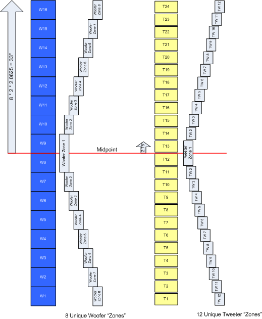

I've been trying to get back to Rev2 of my 22-channel line array for several years now. With the Rev1 version, I can control the shading and delay for the 12 unique tweeter channels and the 8 unique mid channels--there is even an Android app for controlling the shading and delay. It's fascinating to play with these parameters in real time, although I never took any measurements. But I've been using the speakers for our TV for quite a while, and I know this approach has a lot of promise. Best of all, the wife likes them...
I had to stop development on these because the code to control the DSP's had gotten too complicated to easily maintain, and I needed to refactor it into libraries. That work is mostly completed. Also, working with 3 ADAU1701 chips in each speaker to get the 24 channels was cumbersome, and because the control was via Bluetooth, I could only change one speaker at a time. There have been a lot of interruptions, but I intend to get back to this project. It could be a nice platform for evaluating some of the concepts in this thread

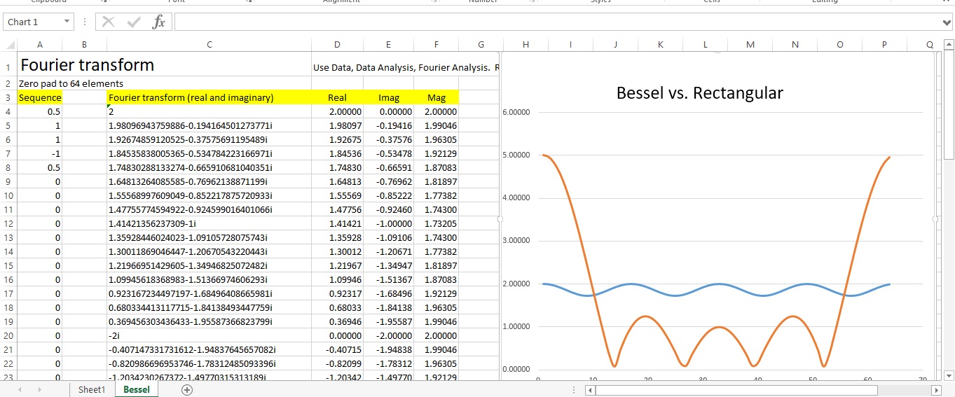

This is a comparison of some of our arrays using the Fourier transform.
It uses a Fourier transform function in Excel where you create a column of numbers (column A) and it returns the real and imaginary transform (here) in column c. This is kind of a clunky function but it works.
Here I have compared a 5 element (all with a magnitude of 1) sequence to the Bessel coefficients. The first 5 terms of column A are the array. Note that I have stretched the function to 64 points long, all of which are 0 except for the first 5. This is called "zero padding" and doesn't change the curve shape other than giving 64 points to plot for smoother resolution.
Excellent question nc355.
It took me a long time to come to grips with the Fourier connection. My math skills are so-so and I was just working out some geometry on the back of a napkin and having some interns code it into Fortran. How could that result in the Fourier transform?
My basic spreadsheet took a sequence of frequencies and figured out their wavelength and how much delay of that wavelength was cause by each element's geometry and angular position. This multiplying was done for every frequency you wanted to plot or for 360 degrees of array rotation. Wavelengths of delay gave phase (vector rotation) and array element strengths gave magnitude. The rotating vectors (for each element) were converted to rectangular form so they could be summed then converted back to magnitude and phase.
This is essentially what a DFT (discrete Fourier transform) does. It looks at a waveform (say the impulse sequence of 5 elements viewed from a particular angle) and multiplies that times every frequency from 0 to Nyquist (2 x Nyquist if you want to see the redundant second half). Each multiplied sequency (your time sequence times a discrete frequency) is integrated and either results in some real and imaginary residual (energy at that frequency) or not.
One clue that kept cropping up was that people would work out the math for continuous lines (Olson, for example) and the answer was always some sort of sin X/X function. Of course the Fourier transform of a rectangular pulse is a sinX/X function. The FFT of the 5 element equal weighted array (orange curve above) is no different than a circular convolution of a sinX/X. Add more elements and you will see it stretch into a proper sinX/X.
It all fits.
math nostaglia
The DFT wiki makes the obvious statement that the DFT of the array weights is a frequency domain representation of them. That triggered the thought that the weighted array can be thought of as a filter operating on a single driver's frequency response. That seems to make at least a little bit of sense.

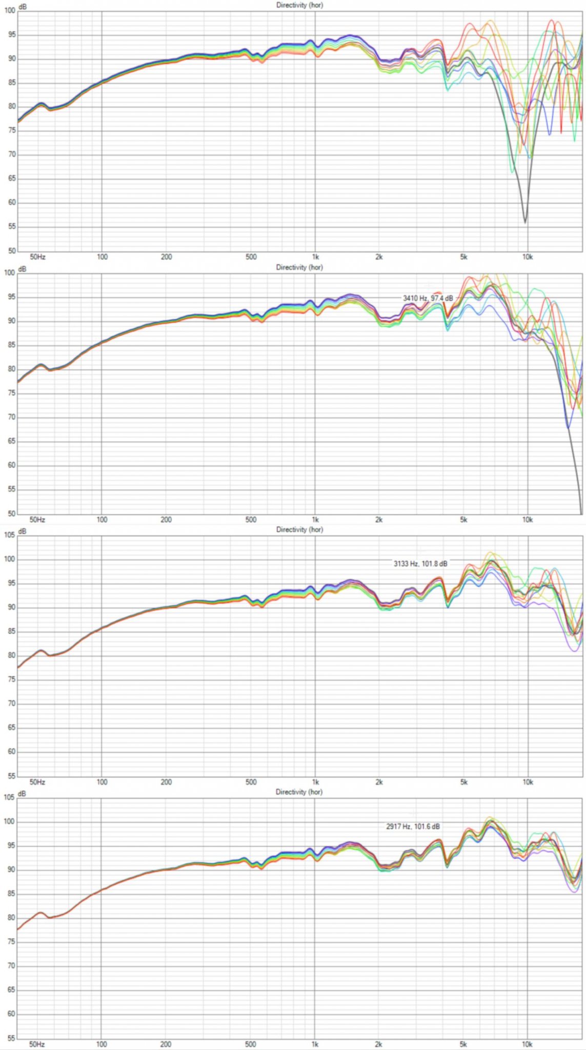

Here's the response of a 5x5 Bessel Array
I'm using the shading from Paul Kemble's website : https://www.angelfire.com/sd/paulkemble/soundf.html
The top sim is at 0.5 meter
Next one is at 1.0 meter
Then 2.0 meter
And finally 4.0 meters
So you can see that you definitely want to listen to these things at a fairly long distance. I'd argue the two meter distance is where things start to look good. The array is 35cm wide and tall, so that means that a distance of about 600% as big as the array is a good starting point.
I'm honestly baffled why these things aren't more popular. What you're looking at is a single driver solution that does 80Hz to 20Khz, has an efficiency of about 92dB, a power handling of 375 watts, a maximum SPL of 121dB and costs $438.50!

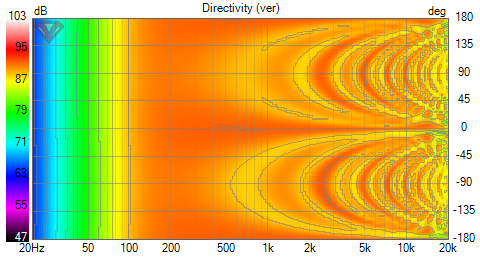

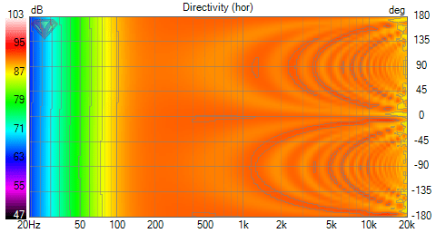

Thanks, I ran your file. Did a quick mirror eq and looked at the polar maps. the equalized axial response and listening window are quite good and power response isn't bad but their horizontal omni-directionality isn't for everyone.

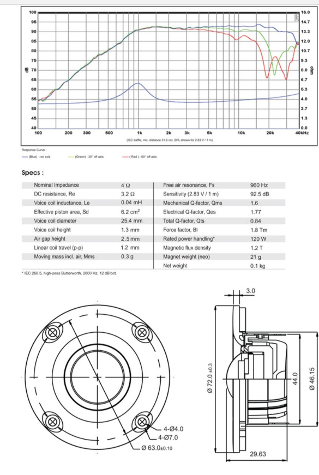

I have 40 pcs of TC9s and 40 pcs of SB Acoustics SB26STCN 26mm soft domes for an array project. I wanted to build the array as a 2 way (LF next to HF array in same line enclosure) to get tighter spacing of HF elements for less combing effect but also to lower IM distortion when playing really loud as well as better top end detail.
I figured I'd ask you guys who have experience with a TC9 array first before I waste my time building something pointlessly complicated as a 2 way line array. I wouldn't even know where or how to cross these drivers to each other for best performance. What do you guys think of this idea?
