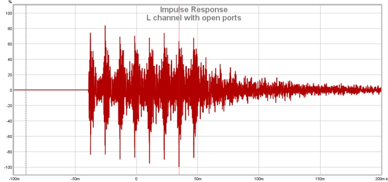

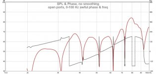

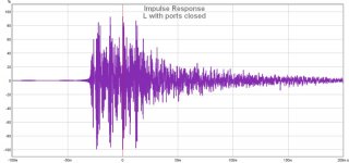

Now they are sealed (plugged ports)...
After about six months of listening to the Marimbas, I got bored and made them "sealed boxes" (er, tube) just plugging the ports with closed cell foam and Gorilla Glue (of course). My hands look like I am recovering from a bad sunburn 🙂
After re-EQ-ing, they sound...not so very different. Gone is the phasiness one would expect from having nine pairs of out of phase ports adding to the sound field. The imaging is still very good .. compared to stock 901 anyway.
I ran some REW scans again. Surprisingly, the FR is pretty much the same (chart). The group delay is a lot less scarier (not shown) 🙂
Graphs speak for themselves and it's all foul language 🙂
Here are the before (ports) and after (plugged) of just Left unit. I can't read an impulse response well, but the frequency and phase 0-100 Hz tells me to scrap the TL idea.
