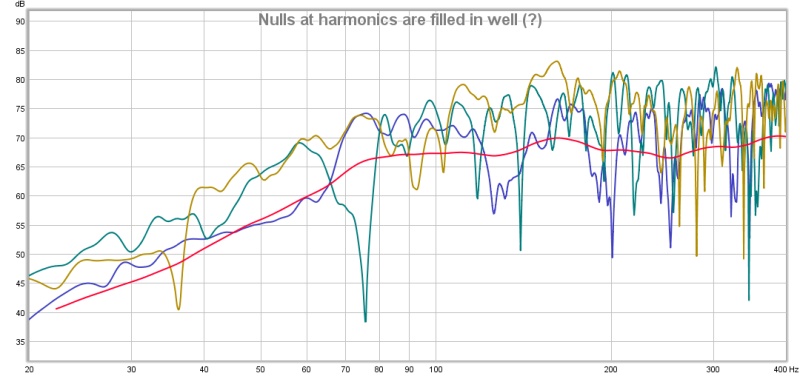

For anyone who is interested in building one ("Dear Lord, why?" query the elders in this forum), here is a slightly more detailed of the build of the Marimba I:
Drivers: 9x "original" Bose 901 (CTS drivers or similar from "brand x" clone);
9x transmission lines made of free cardboard tube (from carpet store); each tube is cut to a length as follows (in cm.):
114, 104.5, 95, 85.5, 76, 71.25, 66.5, 61.75 and 57.
The (ir)rationale for these lengths is explaiend elsewhere.
The tubes are mounted vertically, longest at base and decreasing lengths, so that the nine drivers are in a line array. Any type of frame could be made. Mine was very simply (2) 2"x4"x8', cut in half, and therefore two pair of vertical supports. The base is expected to be a 4' of 2"x6". Each unit was assembled on its side using nothing but Gorilla Glue for connecting parts together. Looks like crap, oozes, but works very well, rarely comes apart yet can be disasembled and scraped off if needed.
It's entirely possible more parts will be added.
Electrical connections: I made each tube have its independent set of leads coming out the side. Many modes of hook-up are possible, but I intend to follow the Bose wring of 3 speakers in series ( = 24 ohm) and then parallel these ( = 8 ohm).
How will it work? No idea. I will report and even give some measure ments -- later.
Not half bad...

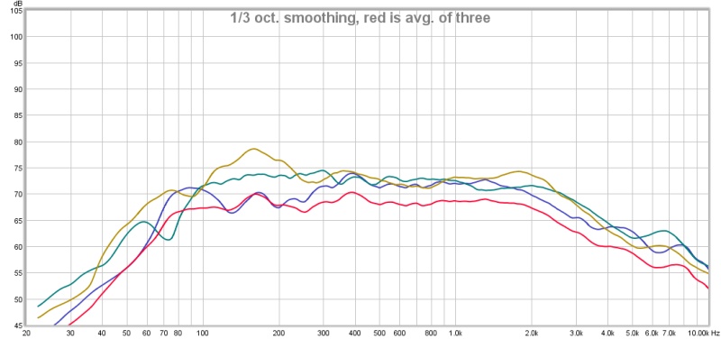

I ran a set of three full range sweeps this morning and the results are not too bad...
I get reasonably flat response down to maybe 72 Hz (-3 db) ... response is MOL flat to 2K and then falls off (that is normal for 901's with no EQ). This pretty good for a driver that has an fs of about 106 Hz.
Selected graphs below.

Amazingly, ST's half-baked design appears to work. Initial testing shows reasonably flat response down to 71 Hz, substantially lower than a stock Bose 901. While not a true line source, ST's Direct/Defective [tm] rear sound wave is actually an unruly mix of out of phase frequencies. Like the Bose 901, this sound is intended to spread to the rear walls and rebound towards the listener.

Without EQ, the speaker clearly has lower bass than the 901 stock. However, the upper end is lacking, as is reasonable, in fact, the high roll off is identical to 901 box with no EQ.
With proper EQ however, is where the Marimba really begins to show its ordinariness. Many speakers are sensitive to placement, and the Marimba is no exception. Just being a line array demands a small sweet spot. However, the rear ports, which are in effect nine TL outputs, will combine unpredictably depending upon the room acoustics. Even small movements of a few inches dramatically change the timbre of the music. Perhaps this is to be expected, since in the case of one speaker set, there are nine in-phase signals vying to peak or null with nine more or less random signals and the results are very unpredictable.

I thought of something like this before, but it involved varying TL lengths with a driver, such that the cross sections summed to proper low freq loading of the single speaker. But quite frankly I don't know enough about it all to do anything with it, so i stick to my 3-ways.
Wesayso: If you say so 🙂 Realistically, I will play with the current 9-unit assemby for a while until I tire of it. I am more likely to build a 2nd 9-unit array and listen in stereo. After that who knows?
Also, for me a major problem in building a floor to ceiling array is that I have a sloping roof: shall the array be 8 feet or 13 feet high ?
Res07njc: your idea sounds like a variation of what is discussed in this thread (where I got the idea to try multiple independent but identical drivers in each its own TL).
http://www.diyaudio.com/forums/full-range/263354-dual-triple-tuning-tl-horn-bad-idea.html
Nor do I know enough about it, it makes common sense that multiple joined air columns driven by a single source will resonate somehow, but beyond that I don't know the math (nor care). I can't believe that my "Marimba" idea is all original, just new to me 😀
