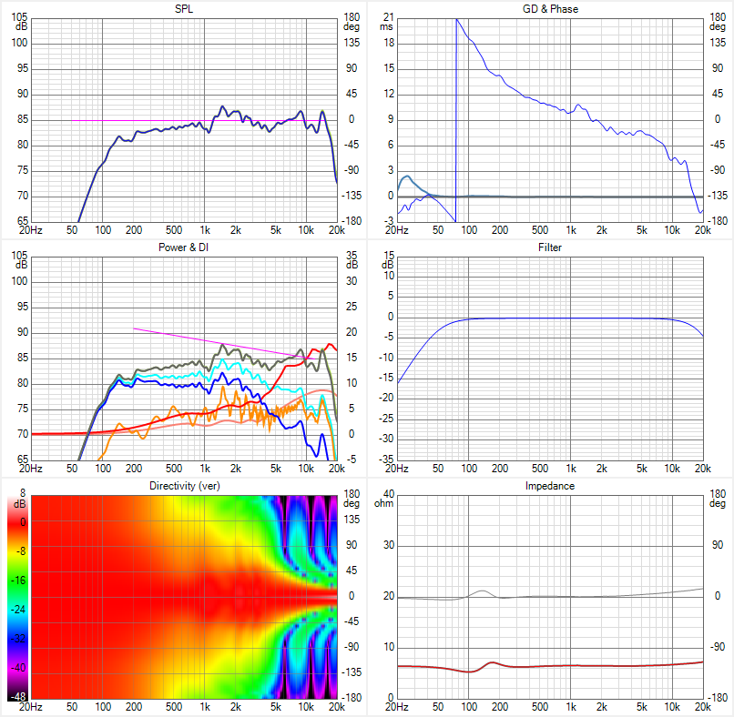

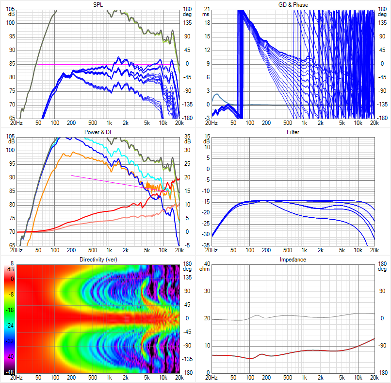

@Patrick, if I may... you're not wrong about the efficiency, but in output potential I do see it a little different.
Let's do some simple sims. First up, a single TC9 in vituixcad (because I have the model in there already) and 1 watt power on that driver (2,83 volt output):
Now let's look at an array of 25 of those drivers, in this example they are representing a frequency shaded straight array (just because I'm playing with shading models in vituixcad at the moment). To get the same 1 watt on the driver, I need to output more power in the total array, which still has the nominal 8 ohm load, 5x parallel and 5 groups of those in series (14,14 volt output, to reach the same 1 watt load per driver):
So with the same 1 watt load (but this time on all drivers) I'm 10 dB higher on total output potential. Despite the subtractive interference. But I'm only looking at output potential. Not efficiency for one watt.
So I do see more potential for the array, even in the top end of an arrayed driver.
These sims do have a reduced floor and ceiling influence 'on' and both would need EQ to be flat in room, but look at the pro's of the array. Less influence from floor and ceiling and still a lot more output potential overall. Despite the lower efficiency of the array in the top end.
Basically, it can eat a lot more power before we get into trouble. It will be louder, no doubt about that! And judging the graph of the array should make clear that the midrange would only need a fraction of that single watt on each driver to match the output of a single driver.
Just some food for thought...

I agree with everything you've written about an increase in efficiency... below about 7khz.
But above 7khz you just can't get them to combine constructively, to any real degree.
And that's the achilles heel with an array.
You can do a million things to try and get them not to interfere with each other. You can power taper them and curve the array electronically or physically.
But you still hit that wall, where the output at high frequencies just isn't combining constructively.
This leads to a couple of options:
Use a two-way alignment, with a series of tweeters.
Or do what you did, and just go full range, and accept the limits at high frequency.
Arguably, the 2" BMRs are particularly bad for option two. This is because:
1) they're insanely inefficient
2) Their beamwidth is really strange above 5khz. A conventional speaker, like what you're using, beams. The BMRs are strange, because they *seem* to have wide beamwidth. Which we DON'T want for an array, we want NARROW beamwidth. Even worse, the beamwidth isn't consistent. If you look at the spec sheet, the beamwidth is wide, then narrow, then wide AGAIN. It's a very odd driver.
I'm not saying the BMRs are terrible by any means, but if I had to pick a driver for a line array, I would do what Don Keele did, which is to use a conventional driver with a rising response at high frequency.
I think that the TC9 that you used, and the SB65 that Jim Griffin used, is superior than the BMR.
But also much more expensive 🙁

Believe me, we are trying (and making some progress) in a couple of threads over on the full range forums: Full range line array for wall or corner placement
Pages full of sims with both drivers you just mentioned 🙂.
If you want a small driver, try he DMA45. It seems to be a good choice for an array if you have the endurance to wire about 50 of them on each side. They are small just 1.5", have a smooth response that does rise in the high end but not until 15 khz. With subs, they have enough oomph. ~$8.
For myself though, I voted for the SB65 with my pocketbook but that was before I came to appreciate the DMA45.
But regarding subtractive combining - it can be eliminated by low pass filtering the outer portions of the array, with lower filter corner frequencies the further the driver is from the center of the array.. Pick a center section that vertically spans your listening window and a few inches beyond on each side and drive these drivers full range. Then low pass filter the drivers outside this window at the frequencies where their delta path length phase shift would exceed 90 degrees and you get a result free of subtractive combining. I've been simulating this approach in Vituix for the last couple of weeks and posting in this thread (leading up to post 649)

This approach yields a response with narrow vertical directivity but perfect for seated listening. Eliminating or reducing subtractive combining this way overcomes the main disadvantage of a larger driver like the TC9 (which is great driver for arrays).
