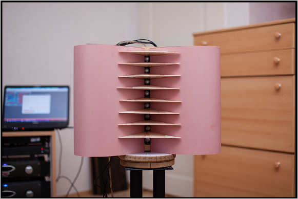

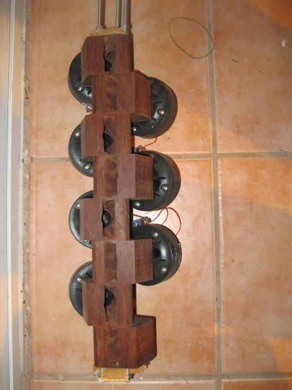

I built a prototype of a line array segment. I developed a waveguide to avoid the bad horizontal directivity of Keele's CBT line arrays.
I used 1" fullrange drivers (Aurasound NSW1-205-8A) which should be used above 300 Hz. The woofer section was not part of the study. The concept I have in mind consists of a 1m long line with woofers beneath and above. This should expand the narrow vertical directivity. CBT-like shading (amplitude and delay) works quite well even with only 7 drivers and symmetry around the driver in the middle.
The paper is in german only. But I think the measurements speak for themselves. ;)

Prototype with 8 drivers (36 cm high):
attachment.php

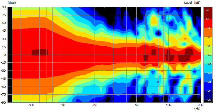

Horizontal directivity:
attachment.php

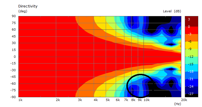

Vertical directivity (with truncated CBT9 shading):
attachment.php
The vertical horns dramatically reduce lobing above 9 kHz as you can see in the paper. In professional designs like the Seeburg GL 16 this is a standard feature.
When there is further progress I will let you know. :)

Those polars are not-normalized.
This is not correct. They are normalized to 0°.

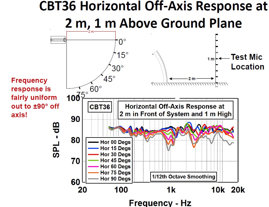

Interesting project! Your assumption is wrong though in claiming the CBT designs proposed by Don Keele are "bad" in controlling horizontal directivity. This is usually assumed because it doesn't follow the common model.
In real use though (and I have heard and also designed / built several CBT arrays) I have found the horizontal coverage to work very well. In both home and pro audio I have not noticed any issues; in fact, the intelligibility of the pro audio systems has been excellent. If the horizontal directivity was an issue that area would be heavily affected. The ground plane CBT speakers also have greater control into the lower frequencies; as a result, the room interface is very good and they certainly outperform conventional designs in this respect.

Do you have measurements of the horizontal directivity of Keele's designs?

Can you explain what is bad about CBT horizontal directivity?
The horizontal directivity of Keele's designs is very broad up to 3 kHz (nearly half space). Above that the directivity gets more and more narrow.
Maybe the word "bad" was a bit to hard. It is ok, but not controlled. It seems to me that he focused only on vertical directivity, but neglected the horizontal a bit. With a waveguide it can be controlled to make it narrower and more constant.
This looks to me lot worse than original CBT...
Do you have similar measurements (1/12 oct) of Keele's design?
Of course it looks better vertically, because it has smaller tweeters and smaller distances between them. And my prototyp has only 7 active drivers and symmetrical shading. His designs have much more drivers and only half shading.
Examining the vertical directivity was not the goal of my prototype, because this can be easily improved by extending the line with more drivers. I was interested in the horizontal directivity.
I meant that the horizontal response curves that you're wanting to achieve is the common model of constant directivity. There's the assumption that anything different from that is inferior. In some cases that certainly may be true (such as horns with bad polar patterns or poor driver combinations).
True, there is some horizontal interference with the lines being side-by-side but this can be minimized with proper driver selection and crossover points /slopes. I use 96db slopes with my DEQX and it works well for me.
The CBT-36 that Don and Marshall designed for Audio Artistry uses tightly spaced small drivers with a low crossover point to give more of an omnidirectional pattern. There are horizontal measurements for it on the Audio Artistry website.
The horizontal coverage is more like an oval shape with uniform spectral content so there is more pattern control than one might think. I have horizontal curves for the passive crossover I did for the Gamechanger. When I get a chance I'll go back and run curves using the DEQX.
I guess you mean from this document.

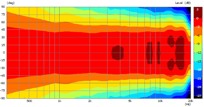

If this curves would be converted to a directivity sonogram it would not look very good. There is distinct narrowing at 1 kHz and 3 kHz.
Of course measurements with different setups (placing, windowing etc.) are not easy to compare. And the type of diagram, scaling and formatting can be very misleading. It would be interesting to get the raw files of those measurements. Then I could build sonograms with VACS for direct comparison.

Do you mean the wooden splines? Sorry, I don't know the correct technical term for this. :)
The vertical interferences (lobes) are caused by the distance of 4 cm between the driver's centers. Each driver radiates spherical up to a certain frequency which is not ideal for a line array. Now the trick is to narrow the vertical directivity of each driver. This means that under larger angles there is much less sound pressure which can interfere. The vanes act as small horns which narrows the directivity only in the highs.
Note that in the straight line implementation you have used (with electrical delay rather than physical delay) the issue is side stepped because the elements are always "recessed" away from the listener, no matter what the observation angle.
Yes, that's true. Beside that it is much cheaper and easier to build. The waveguide was milled out of some kind of plastic. With curving it would be much more expensive (I already payed 320 € for the current waveguide). And using digital delays has the advantage to "tune" the directivity. On the other side much more electronic components have to be used (even with stepped shading). So it may be not much less expensive. ;)

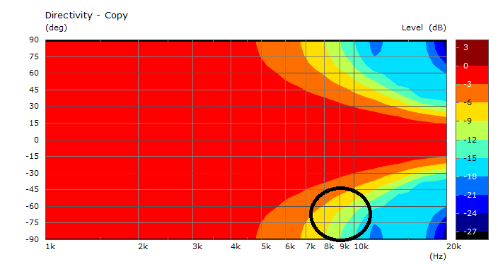

To illustrate the effect of the vanes a bit better I simulated the 1" driver with AxiDriver in an infinite baffle.
Driver only:
Driver with very narrow horn:
Please take a look at the marked areas. These are the places where the strong lobes occur. Without vanes there is about -10 dB of sound pressure which interferes with the othe drivers. With vanes there is only -20 dB. This is the reason why vanes improve the lobing dramatically.

No problem - I don't want to take anything away from what you're doing either. Your approach is very thorough. True, Don's focus was more on the vertical response behavior. That's one reason why the particular tweeter was used for the CBT-36 because he wanted a low crossover point and close driver spacing. Cost was also an issue and they wanted to keep the price reasonable for DIY builders.
The curves you posted were taken with a 1K crossover point and (if I remember correctly) 96db slopes. The dip at 1K is expected because of the delay changing as you move off-axis. The off-axis response at 3K is probably more a result of driver behavior than the CBT design. When we had the CBT-36 at the RMAF show I raised the crossover point and I think it improved the sound quite a bit.
I do like the simplified enclosure of a straight array with active shading and delays but as you mentioned this also increases the cost and complexity of the electronics. One concern Don mentioned was being able to apply the an accurate amount of delay if going active.
I guess the dip at 3 kHz are from diffractions, because of the small baffle. Or reflections on the midrange driver. I simulated a lot with different waveguides and baffles and the geometry (width, round edges etc.) has a great influence of the lateral response. :)
