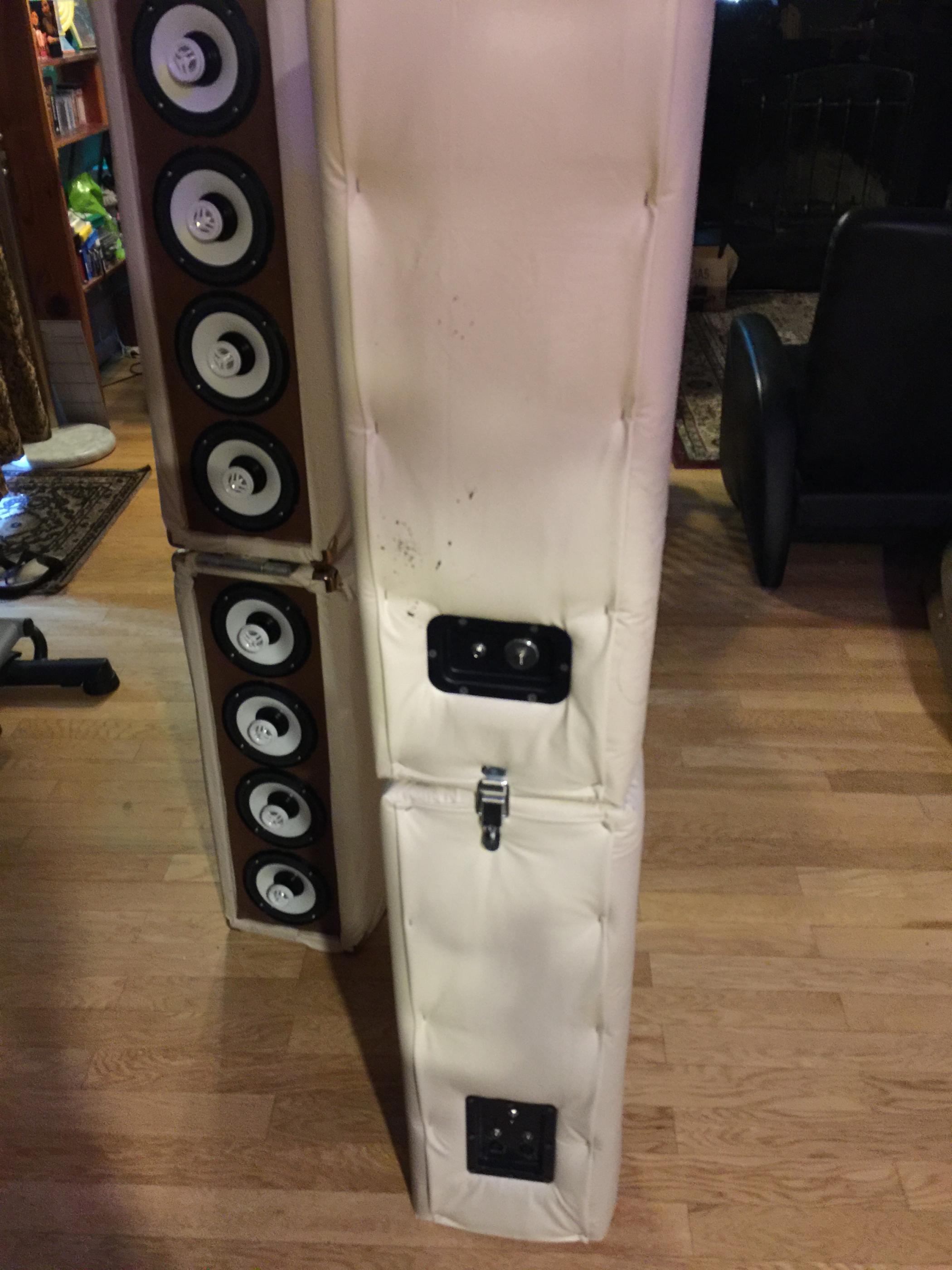

I've just finished my arrays using 24x Faital 3FE22 per side and am loving the results so far. I'm supposed to be taking measurements but these full range arrays have a way of drawing you into the music and then I get nothing else done!
That sounds like a nice project. Do tell, with pictures!

Do you run some kind of EQ?I've just finished my arrays using 24x Faital 3FE22 per side and am loving the results so far. I'm supposed to be taking measurements but these full range arrays have a way of drawing you into the music and then I get nothing else done!
Hi wesayso, it was your project that inspired me to try an array! I already had the amps and processing from previous multi way projects so yes, I have an XTA DP448 which does crossover to the subs and EQ. These arrays would sound terrible without EQ.
I am just amazed how good they sound bearing in mind that I have owned multi way speakers (up to 4 way active) for years! Need to have another good read of your thread to fully get to grips with the many ways that you optimised your arrays though..
In that case: I'm glad you like the results! 😀

Hi mpa,I've just finished my arrays using 24x Faital 3FE22 per side and am loving the results so far. I'm supposed to be taking measurements but these full range arrays have a way of drawing you into the music and then I get nothing else done!
planning to build a very similar array with 24/side 3FE25 any hints on how you build a cab to house these. Any help would be appreciated
